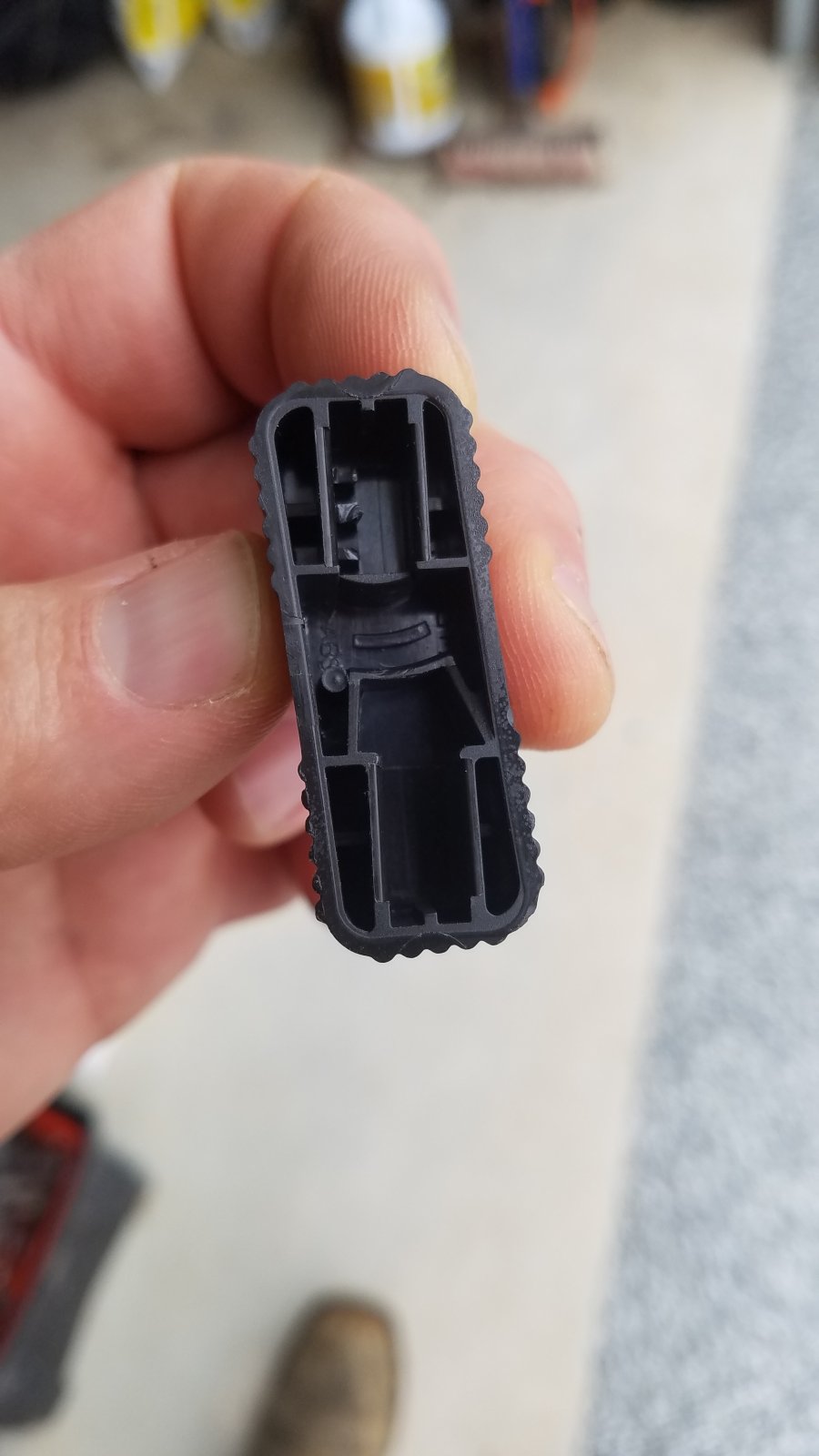

I ended up buying the whole switch like one suggested once I found a seller it was about $20 so I got it. The button is not the same on top and bottom. I can get the one half on no problem the other wont go on no matter how much force. Looking at the inside is the picture and you can see those 3 protrusions, on the switch it has a part that is like an L shape. It seems like it would go on fine if those protrusions were on the other side as they are now they hit that L shaped plastic tower on the switch.
I dunno if it's worth any more brain power on it since the whole replacement switch is pretty cheap and easy to swap but I thought I would share what I found.
