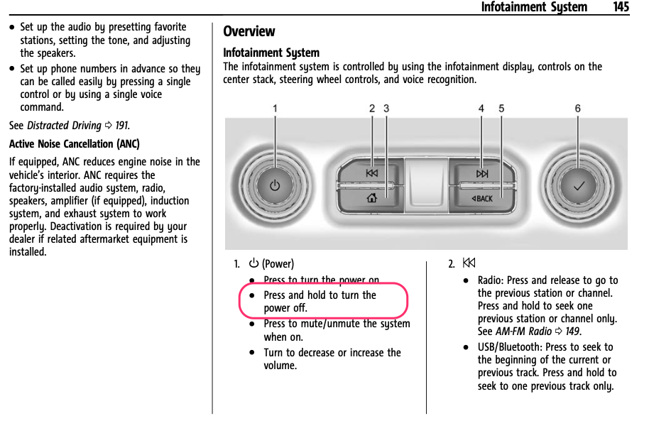

You can hit the On/Off button momentarily and it will mute the audio.
You can hold the On/Off button and it will turn off the infotainment system.

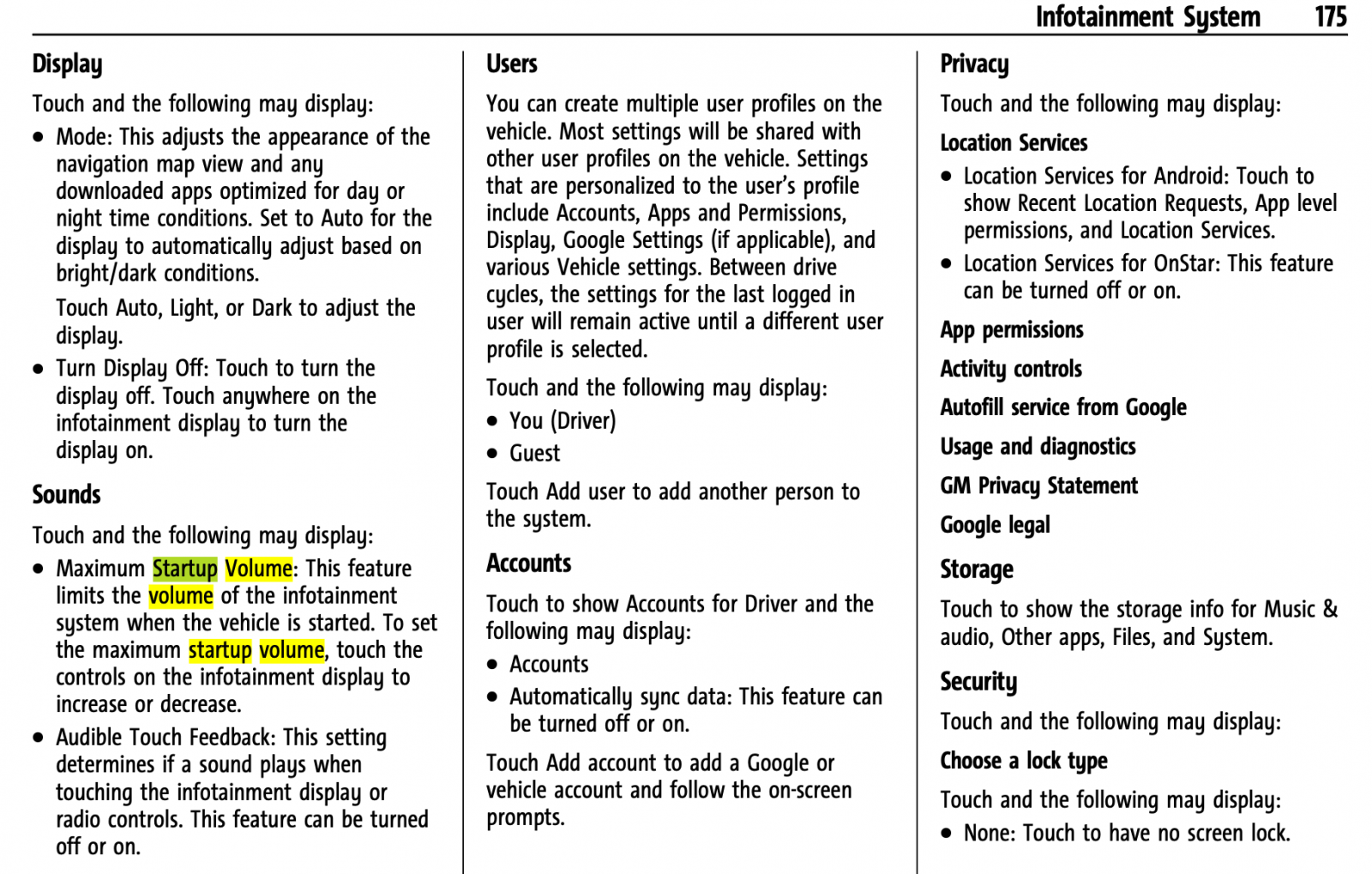

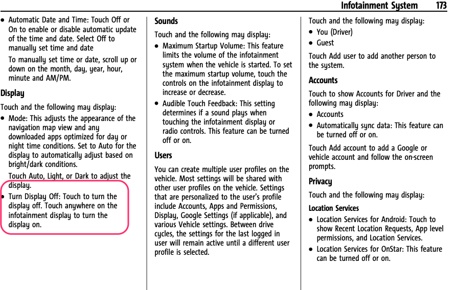

You can also turn the display off, but leave the system on:
Hit Settings -> Display -> Turn Display Off to turn it off
Hit anywhere on the screen to turn it back on, see Owners Manual, excerpt below:

You can set the maximum radio volume after a startup.
