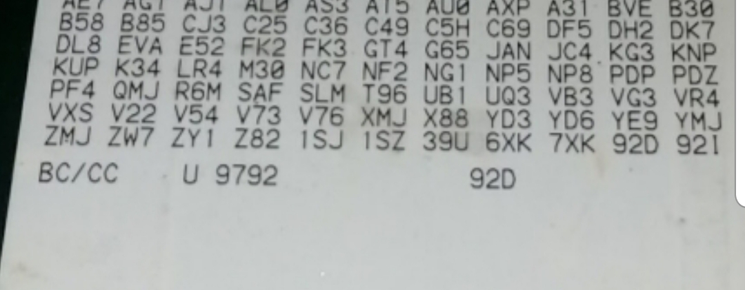

2001 Silverado Z71. Where is the interior color code on the truck listed?
33,361
51,880
The interior color code should be the the row of letters/numbers at the bottom of the RPO code sticker inside the glove box.
Near the bc/cc number--on the lower part of the rpo sticker.
92D

BC/CC is base coat/clear coat. U9792 is indigo blue metallic [the base coat]. 92D is the dash code [pewter].
92 is interior color code. I'm not sure about cloth--but for leather interiors pop off the headrest, flip it upside down and pop the clip that's holding the underside together. There'll be a white tag that tells you what the interior color is.
