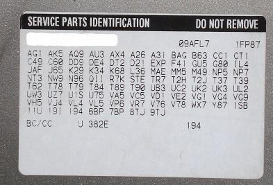

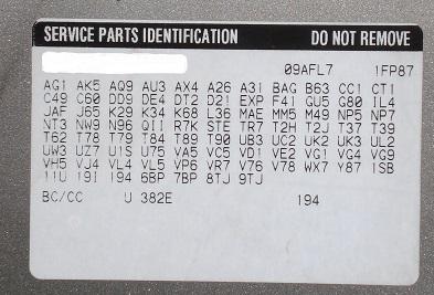

Welcome to TYF, Paul, from the Mile High City.
Open your glovebox and on the lid should be a sticker that looks something like this. Either post up a copy of yours or list the codes on it it that start with "Gxx".

I ran your VIN through GM's build history, you have GU4 - REAR AXLE 3.08 RATIO.

GU4 is the 3.08 gear and G80 is the posi-trac rear differential. I cannot find and GBA code. Are you sure that is the correct code?
