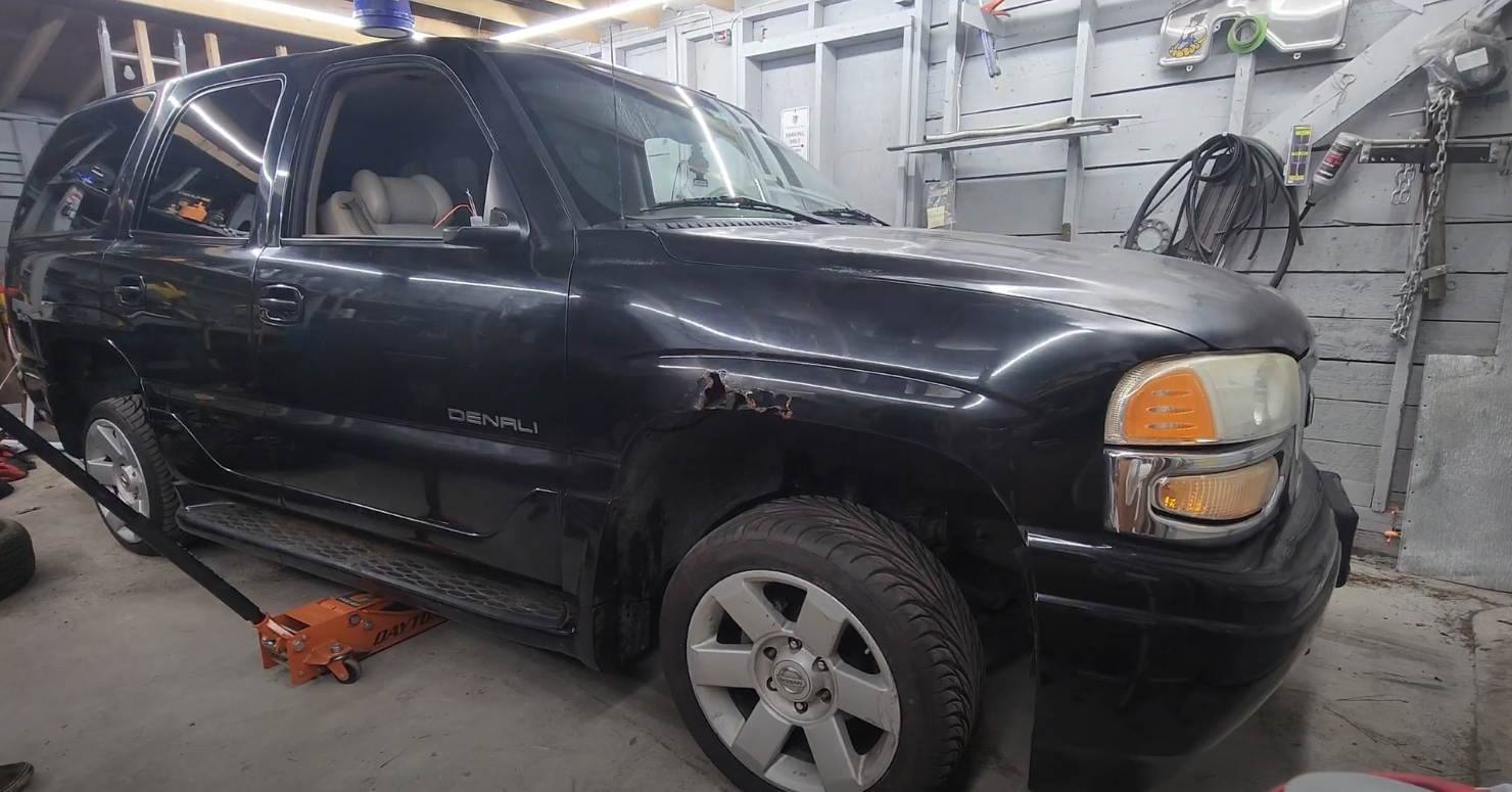

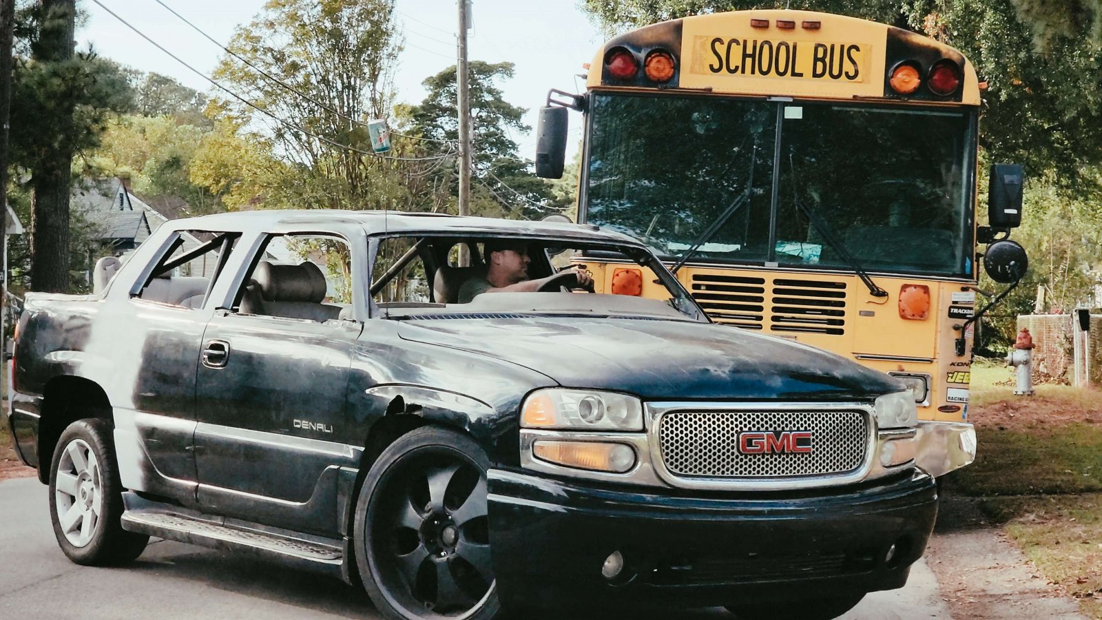

The quick summary: This is a 2001 GMC Yukon Denali. Over a quarter million miles, not treated nicely by the previous owners, rusted all to hell, doesn't run that well, very suspicious paperwork.
I got this truck to just hack on, beat around, experiment, and just generally have some irresponsible fun without tearing up our nicer cars.

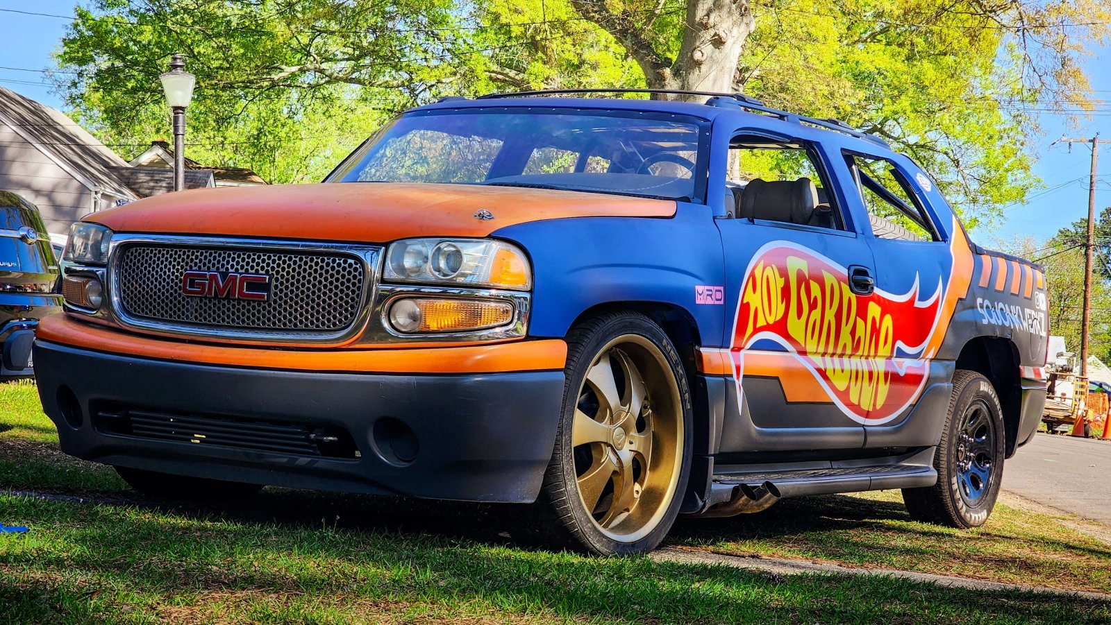

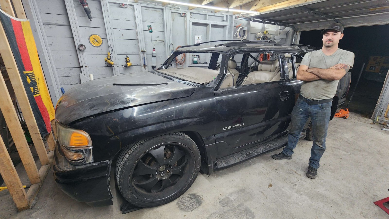

Step 1: Chop top.
We cut about 7 or 8 inches out of the roof, and got another 3 or 4 inches in a suspension drop. This thing is low.
Other early mods: rollbar, detachable steering wheel, gutted the back half of the interior, 2" primary long tube headers, side dump exhaust, and removed the AWD system.
Then, the most important thing:
Paint.

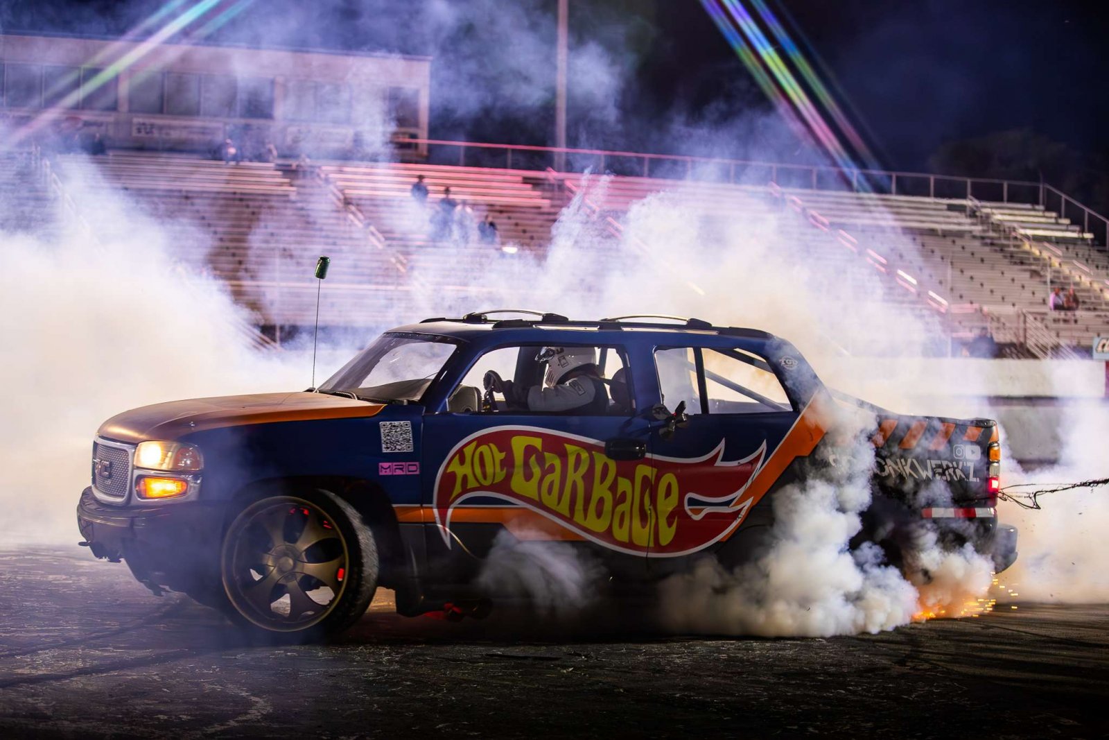

Our first objective was the burnout competition at the Cleetus and Cars event, down in Florida. (Hence the smaller rear wheels.)

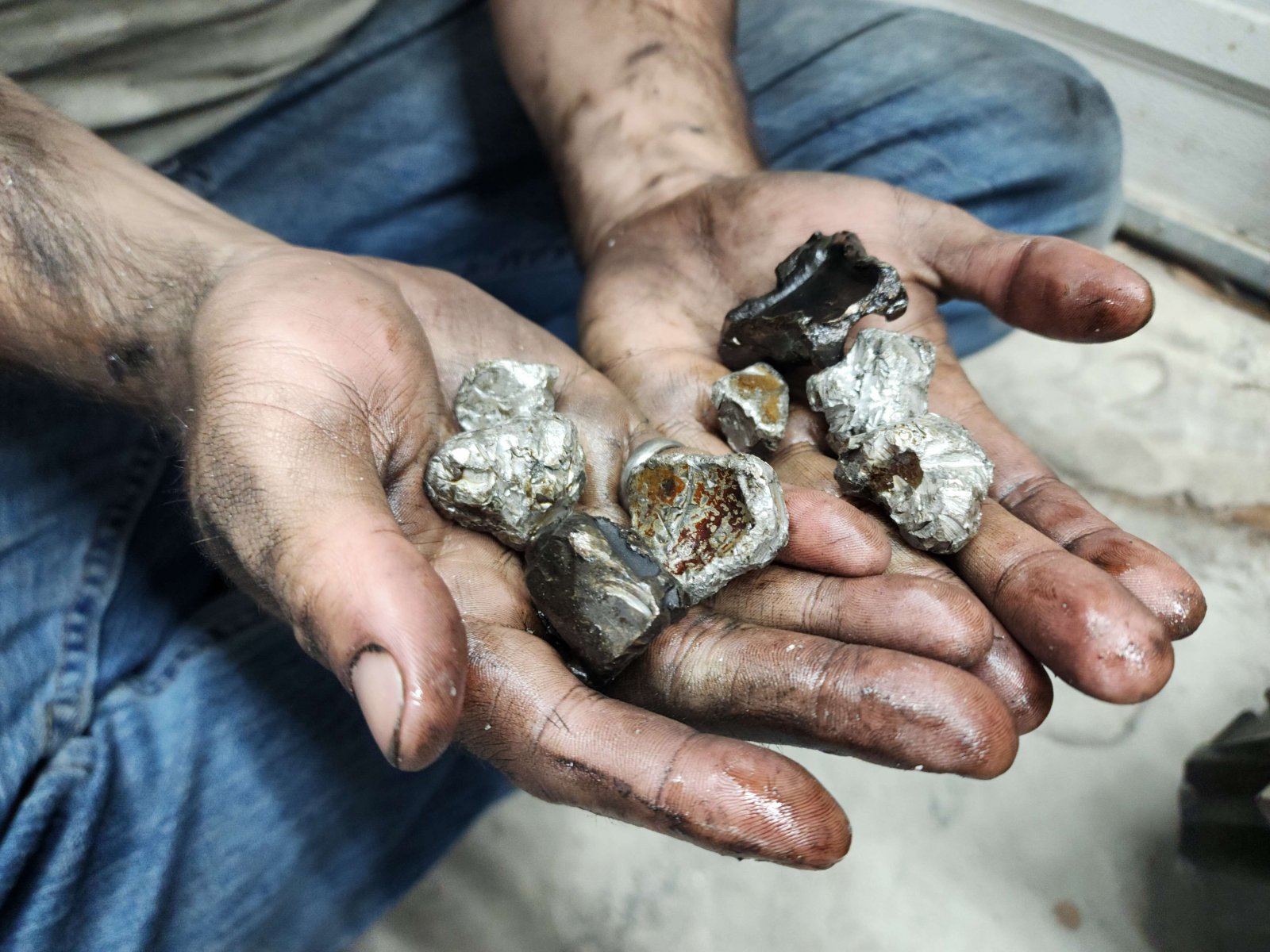

I'll save you the gory details, but long story short, a buddy of mine sold me a nitrous kit the morning of the competition, and we installed it and went right into the comp, no tuning or anything. 20 seconds into the burnout, the predictable happened:

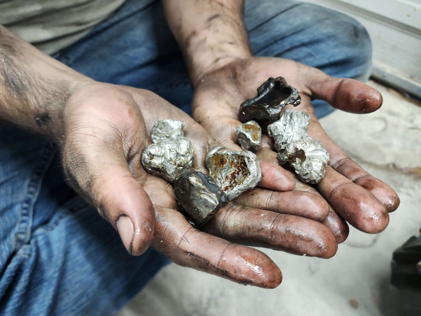

That is what remains of piston #6. Completely shattered, gravel in the oil pan, the whole nine yards.
Now, keep in mind this engine was already on it's last leg and slated for a rebuild. As of now, we're slowly pulling the engine and planning the rebuild. 3 months from now, there's another burnout competition down in Florida at the Freedom Factory, and the plan is to be there with Hot Garbage.
Hopefully, the block is good and we can rebuild it instead of having to get a whole new engine. The plan for the new build is mostly stock long block, maybe a cam, but potentially with a full standalone ECU, and definitely keeping the nitrous kit (but tuning for it properly this time.)

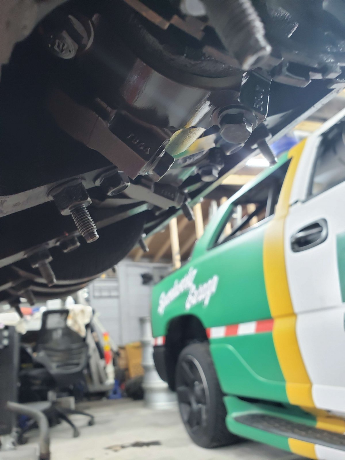

Okay, maybe it's not that big of a deal, but I'm excited. Found a guy locally that had an LQ4 long block taking up space in his shop. He even delivered, for the low low cost of lunch. (Thanks Pete, you're a hero.)
First, we're gonna get the new unit all cleaned up and probably paint the block, just for laughs. Pull the pistons and get the ring gap set more properly for nitrous, so we can hopefully avoid nuking this one, too. Then we have to finish getting the old motor yanked out, and transfer over what bits need to come with. Then we can just stab the new one in. We're gonna stick with the stock ECU for now and tune it for the nitrous. We're also going to shop around and see what aftermarket radiator options there are, and we're definitely going to get an electric fan.
Hopefully we can have this engine ready to go back in within the next two weeks or so, depending on parts shipping and etc.

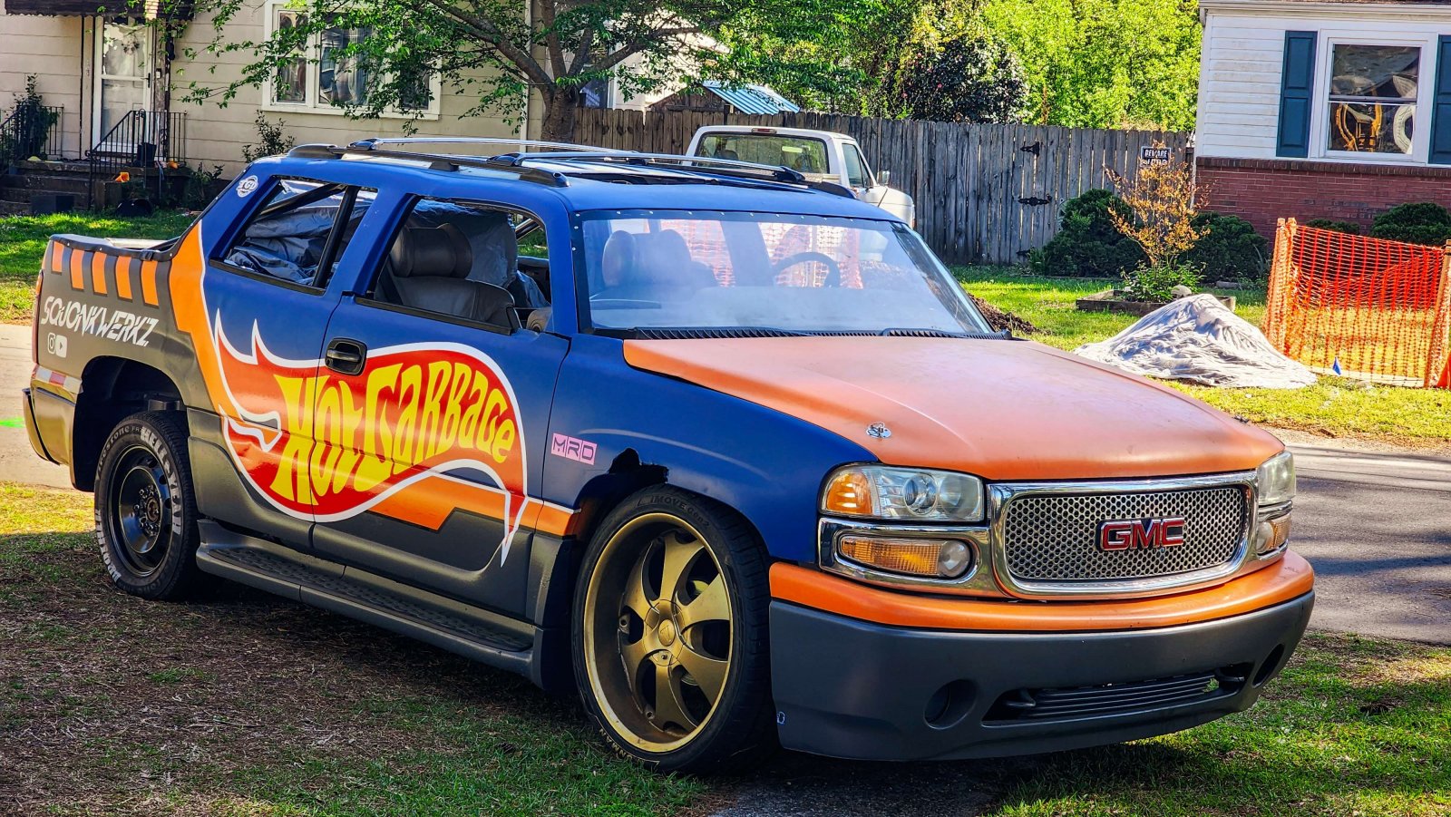

Repainted the truck! (Priorities).
Same shit as last time, house exterior paint from Lowe's and a cheap electric spray gun.
