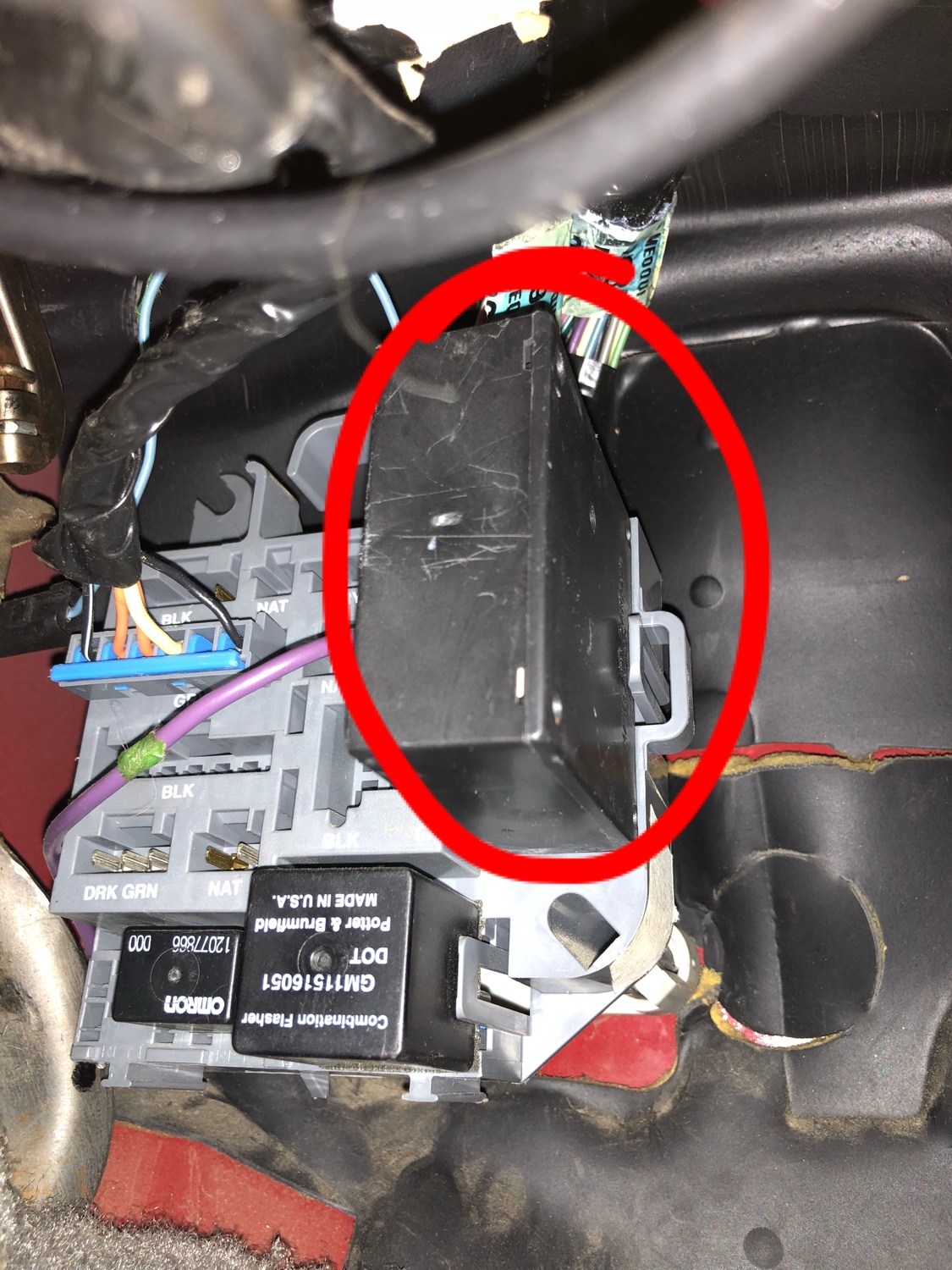

Driver side, it’s the box on the right. Just remove it and don’t forget to take your keys with you, lol.

Thanks! I have never owned a car that makes such a horrible sound in my life haha

took about 10 seconds. try to turn off the door alarm on my wifes 2006 lexus and see what happens to you

I had to do this to my 99 Express, and I will most definitely be doing it to my hoe. Such a horrible, relentless sound!

Didn't those GMT400s have a buzzer under the dash? Little square box with a two wire plug going to it. Just unplug it and throw the thing away.
I believe i taped my box up years ago to dampen the sound to just the right level. "middle age man low"

fiy i believe this is also for all the warning chimes. so if like me you have a wife who tends to leave the lights on........ tape it up or deal with it lol. i pulled mine a few months back so i could work on the truck without being annoyed ive had to jump my truck 3 times.

Just removed my chime today and I am so much happier! I also removed the box for the auto DRLs. Now I can actually control my headlights!
