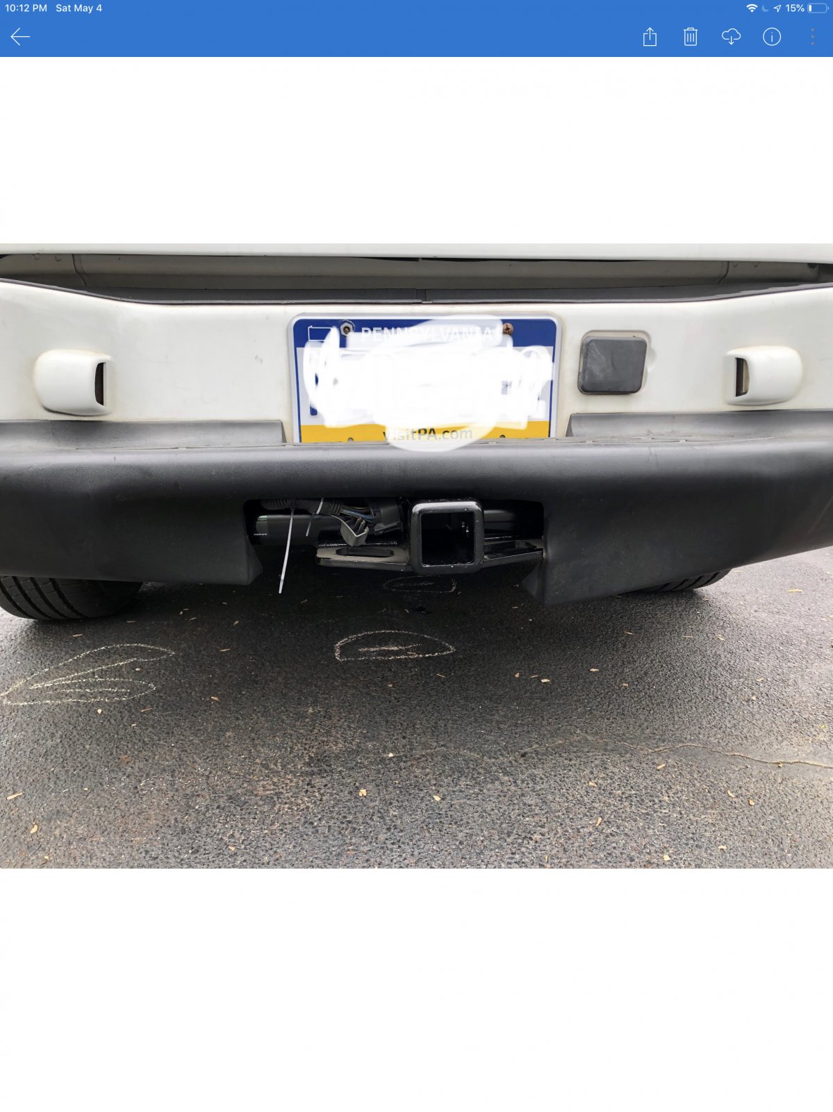

My 2004 Denali xl had a rusted hitch. Figured it would be easy to replace but it seems the Denali trim provides issues. I purchased a Reese 51201 but it did not have the bolts into the bumper, did not have a mount for the electric connector and did not fit between the bumper cover cutout. I wish I kept the old hitch.....
What make and model hitches fit the 2004 Yukon Denali properly?

That hitch doesn't look centered on the frame; are you sure the correct bolt holes were used?
It is centered The cutout on the Denali is not centered, I believe it is because the wiring plug is on the left

I purchased the Curt 13422 from Amazon and it fits well. It’s a bit different than stock so I’m still working out how to mount the 7 pin connector. Overall I’m happy so far with it.
