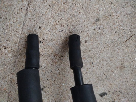

Well sorry to confuse anybody with my statements or "edits". But I guess to confuse anyone/everyone a little bit more when I left work today I notice I'm still idling high , not as bad but I know it's not normal operating idle.... So let me get a picture of that "screw" I was adjusting on the throttle cable and also show you how it is positioned as of now and then y'all can correct me if I'm totally messing up the factory location or not. I appreciate any help or constructive criticism from the knowledgeable folks on the forum. Thank you
adjustment screw I was talking about and below is how throttle cables are currently positioned

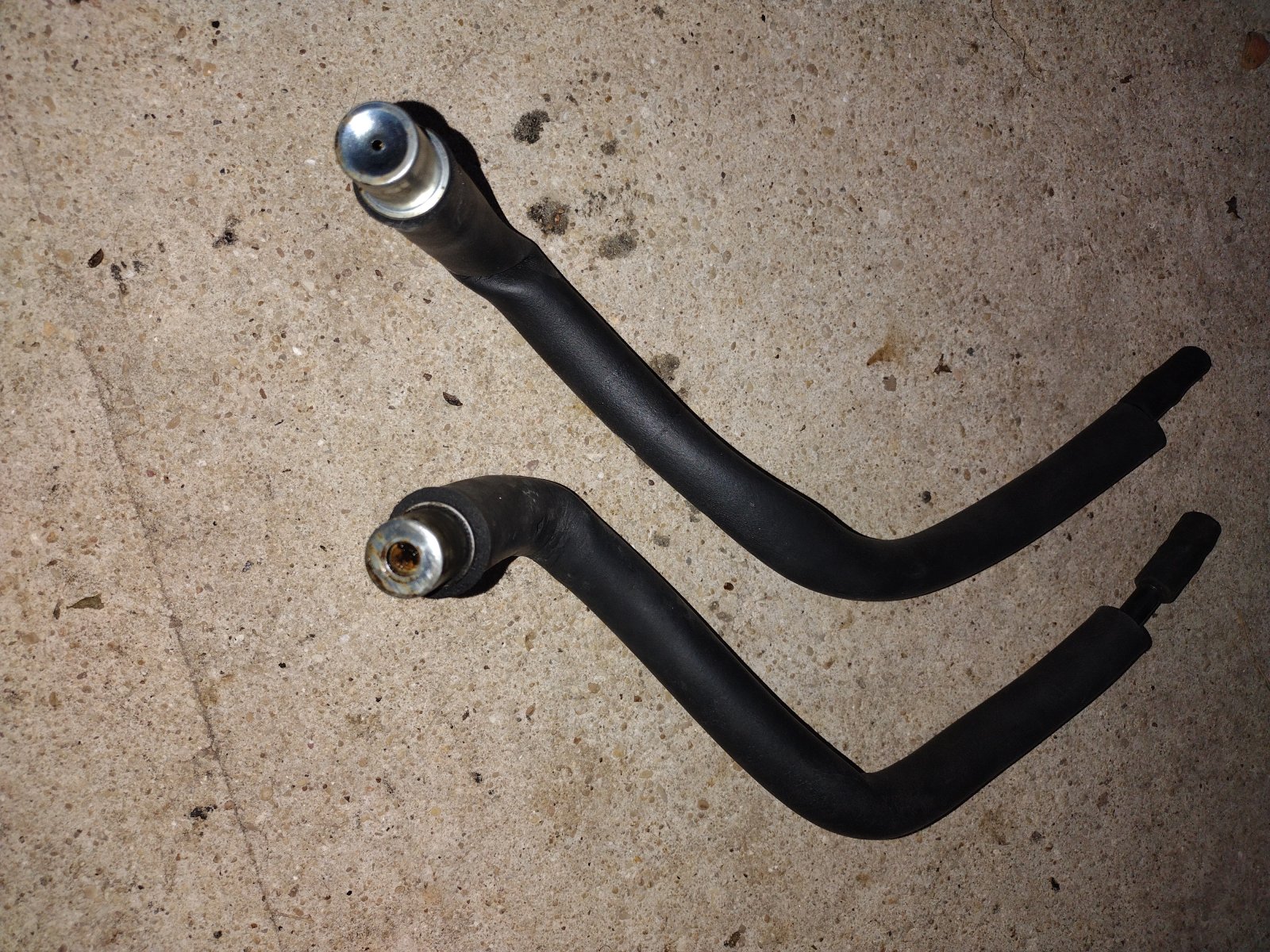

I will add a couple more details. my CEL is not on, and I do have generic access to live data. What should I be on the lookout for in terms of the data? Also when replacing the intake manifold during previous work I did rip one of the bolt grommets and it does "pancake" out on one side of the bolt head.... And my MAP sensor has a little small rip on the orange rubber ring that seals it? Maybe that new PCV some manage to cause one of these to start acting up?? ... Idk I'm just trying to give as much detailed info as I can. Thank you again heses a pic of new and old PCV

When at idle, is the throttle plate completely closed? Turn that "screw" and loosen that cable tension slightly and see if throttle speed drops.
Yep. That screw is there as a connection point between the cable and the throttle plate. It allows adjustment for a slack/stretched cable. It is NOT to be used as a idle adjustment. The days of idle screw adjustment are long gone since carbs have been replaced with fuel injection. The PCM adjusts the idle via the IAC (Idle Air Control Motor). Likely his high idle problem is because he has that screw adjusted to where it is pulling the throttle plate open. The throttle plate should be fully closed while in park at idle. Adjust that screw out until it is.
