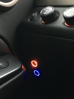

Once the weather breaks I'm going to work on this.
I'm thinking that a simple 2-wire interrupter on whatever feeds the screen actuator/motor should work.
Hold the new button in, while pressing the factory button and it will complete the circuit.
I used these 19mm illuminated ring switches for other electronics. (also come in 16mm)
There is a small amount of space below the headlight switch to mount them, and I have room for 1 more above the Red.
