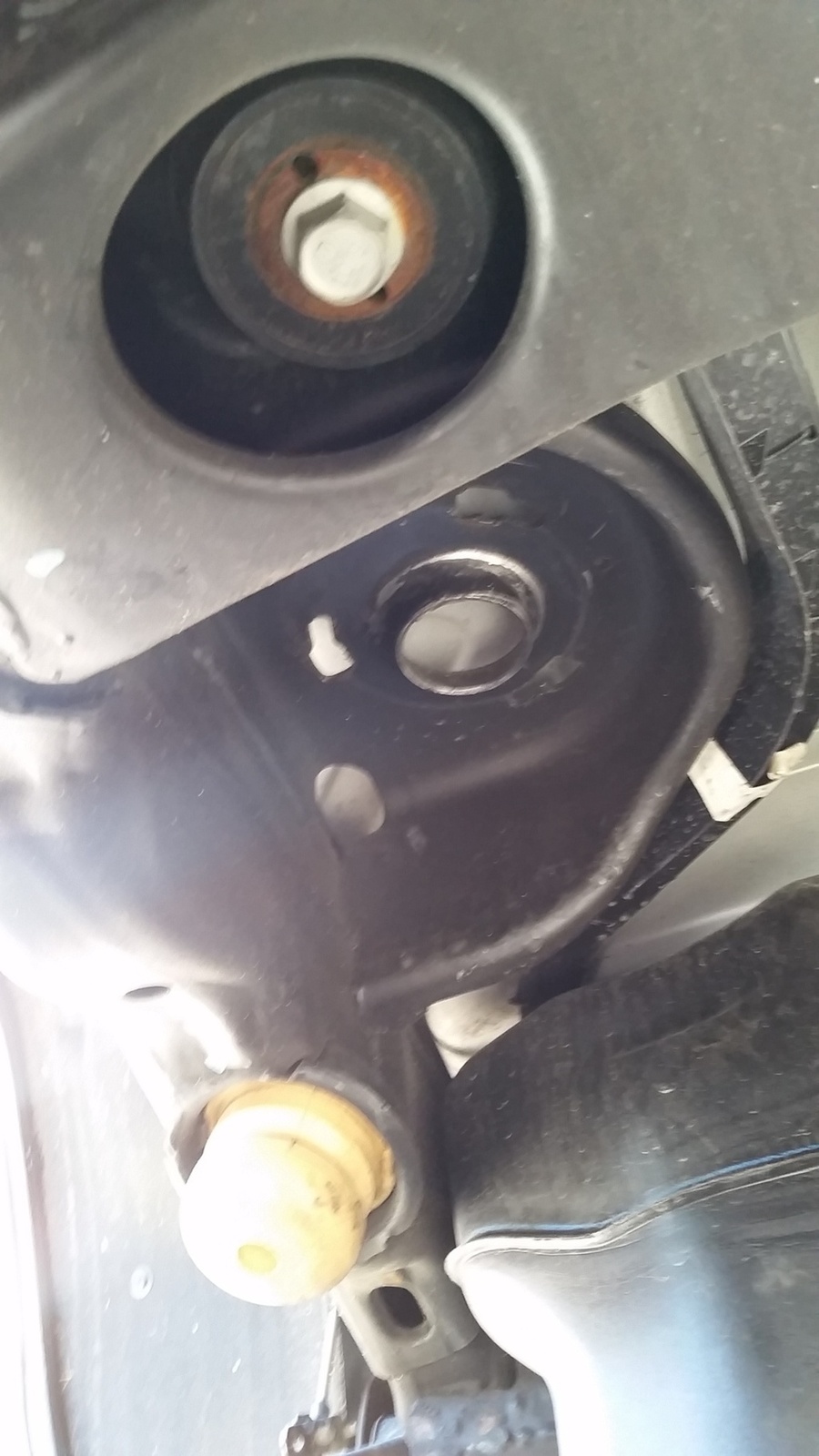

Just heads up the 2015 ups use the same crossmember.
Heres a pic of the upper mount with 3 notches and tbss bags fit right in
So here we go you will need
2 feet of 5/32 tubing (cut in half and use 1 foot coming out of each bag)
2 of the grainger 5/32 to 1/4 push to connect fittings to connect to the air compressor
2 of the tbss airbags part number 25815604
DJM Rear hardware kit with bumpstops which I can supply $190 shipped
Free travel mod needs to be done
Last but not least if you want a cheaper air system you can get airlift wirless 1 like 275 online
https://www.airliftcompany.com/products/compressor-systems/wirelessone/
or
Airlift wirless air like 375 online
https://www.airliftcompany.com/products/compressor-systems/wirelessair/
Notes on system
1) At ride height the back will be a 4.5 inch drop over factory
2) The airbags will lay frame on axle
3) You can tow 6500 lbs with the tbss bags
Any other questions just ask guys.
