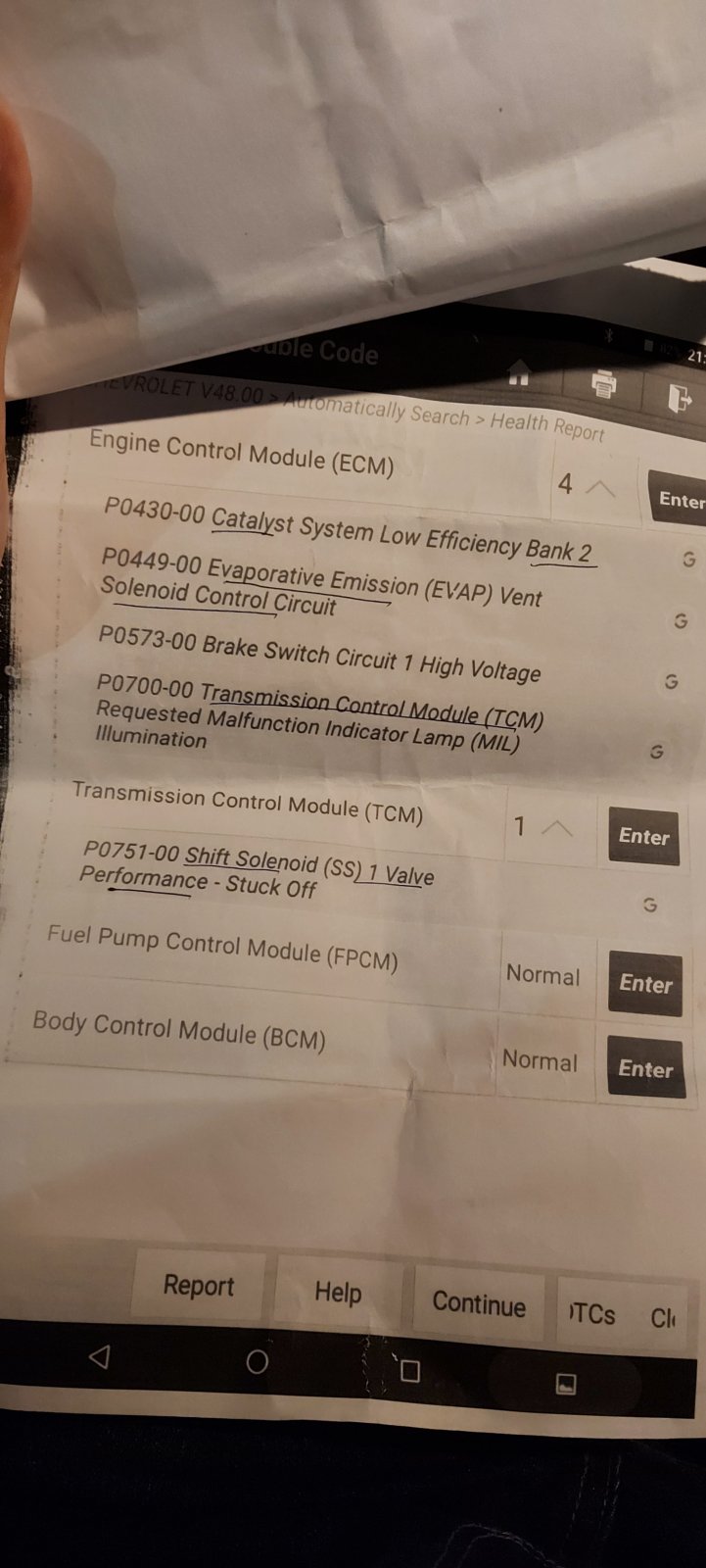

I bought tahoe 2009 150k miles driven few days back. When i was buying they did compture test it shows falt P0751 -00 shift solenoid 1 valve performance stuck off and tech told me its ok.
When i drive sometimes i feel a jerk when i move from the signal light and this happen not always
Do i need to fix it. If yes plz guide me on what to be done.
If not any precautions i should take like not driving bit fast or pressing accelerator.
Thanks
