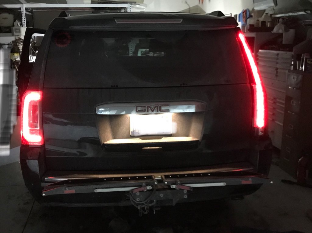

Based on this pic here you’re stock XL Denali tail light is still installed on the left side (the one you’re saying is hyper flashing) and the new Escalade tail light is installed on the right.
Is the hyper flashing of your left tail light (stock Denali) based on how they’re installed in the pic or did you have BOTH Escalade tail lights installed (stock Denali lights completely removed) and this hyper flashing occurred?
The reason I ask is because clearly the Escalade tail light has more LED’s than a stock Denali LED tail light, so it’s probably safe to say it draws a little more power than the stock Denali tail light (still installed on the left hand side in this pic). Therefore the BCM could potentially think that since the left tail light (stock Denali) is drawing less power than the right (Escalade) that a bulb is burnt out therefore would default to hyper flashing.
Again if this is the case, go ahead and install the Escalade tail light on the left side so that the power draw is consistent from both left to right tail lights. If at that point the hyperflashing still occurs only on the left side, it would be safe to say that the left Escalade tail light has something wrong with it.
