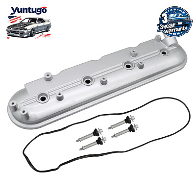

Is there an updated aftermarket driver side valve cover?? I was quoted 146 locally..
rdezs
Nov 6, 2023
1,374
2,552
Here's a link to a set I bought on Amazon for my Hummer H2:
Updated valve covers
Quality was awesome, unbelievable for the price. And they look really good.
L
lspann3525
Feb 22, 2023
226
229
Thanks! Thats a pretty good deal. I will consider this for my gen 3 rebuild. Im going to try to find the cheapest driver side valve cover thats updated to see if that slows down the oil consumption. My oil pan /timing cover seems to be leaking. So ill start with the valve cover
Are all the valve covers with the part number 12570427 updated??
Ebay and Amazon are full of 12570427 aftermarkets that are half the price

They all seem to have the rectangle opening instead of the round opening as well.

No I didnt use the tool couldnt find one locally and needed to get the truck back on the road. The rear of the pan is dry. I am only seeing the oil build up near the front. sht fck it I went ahead and bought the aftermarket 12570427 seems to be identical to the GM version. Hopefully this will slow my oil consumption down some. Last time I opened the throttle door it was pretty oily so I think my engine had been sucking in oil.

Received the new valve cover and gasket yesterday. I went ahead and changed the oil last night and installed the new valve cover.
