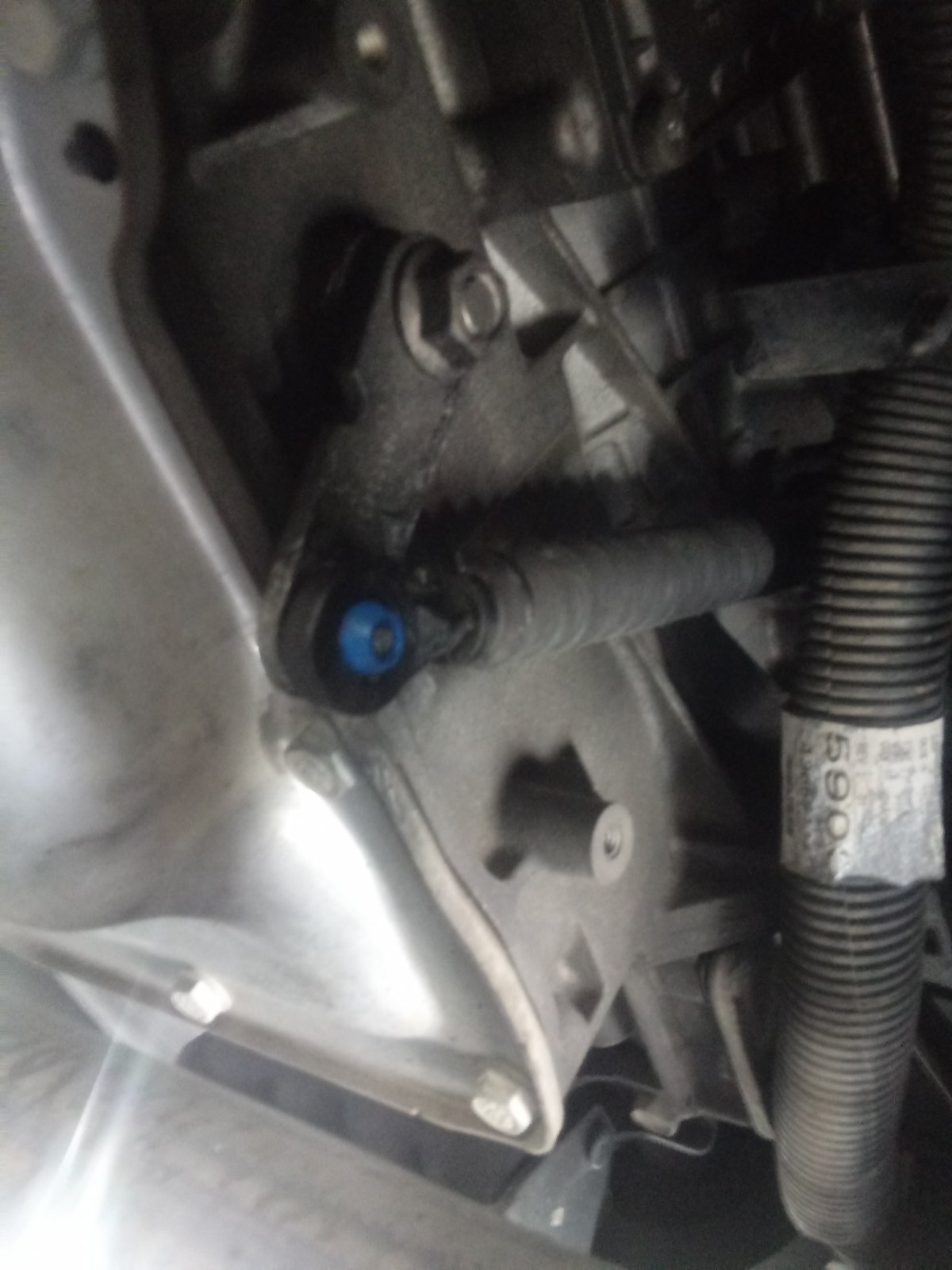

help column shifter broken stuck in DRIVE gear

what if you can't get the part and what am i going to do?? go under the car every time I need to shift it??

i'll try to install it later too hot right now i got it
someone actually stole the package but returned it after wards they ere to disappointed nothing great was inside..

installed in 2min shop wanted to charge me 160$$ for 2 hours of labor

It shifts nicely and shifts like a brand new car does.....

well they could have earned a new customer, I was planing on having the Aux transmission pump, new fluid and a double filter change to transmission(has two filters) ... i just had diagnostics done a month ago it came up inconclusive... but the aux pump is the "typical" suspect esp in the 2008/09 model..
just so i can keep up on the fluid changes because its all ready been like 25k since the last fluid change it was changed at 80k or so i guess and it's at 105k.....
i was going to have the rear end changed as well(oil)..

having an issue it still slipping off , It slipped off luckily it was in 'park' at the time... should i clean the grease off ?
ya it doesn't need any grease, clean it real good and be sure you have it installed properly, I have one on mine it's never came off
