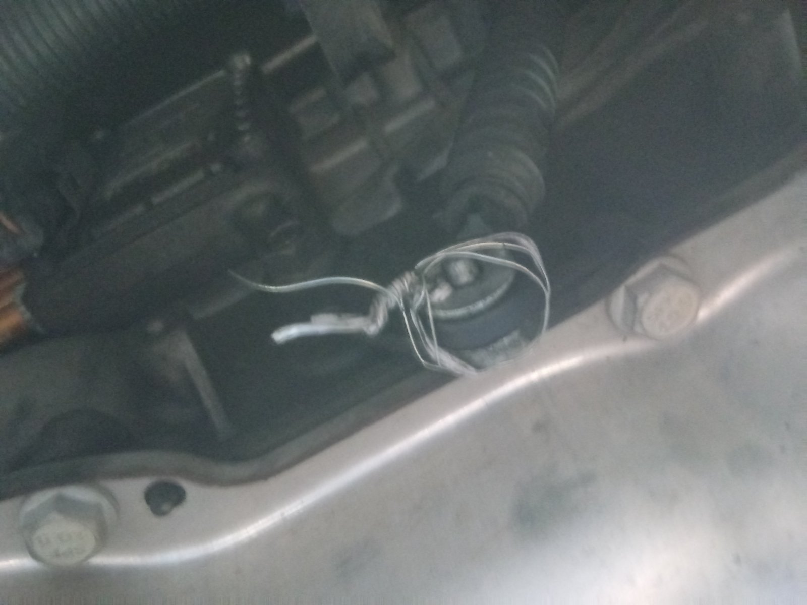

OK update I went under it and yes the bushing is broken it's hanging loose
Do i push up or down to put it in park??
I believe all the way forward is park, but it could be the opposite one or the other, you can fix it temporary with a zip tie and a washer
got it in park ok..... I MacGyver a repair now it shifts like it should
using a washer and some metal wire (i did not have a zip tie on hand )
the pin lever looks like the one on the 4L60E
2LM70 is a beefed up 4L60E anyways.... as far as i know....
I have a spare washer and extra wire with me just in case...
