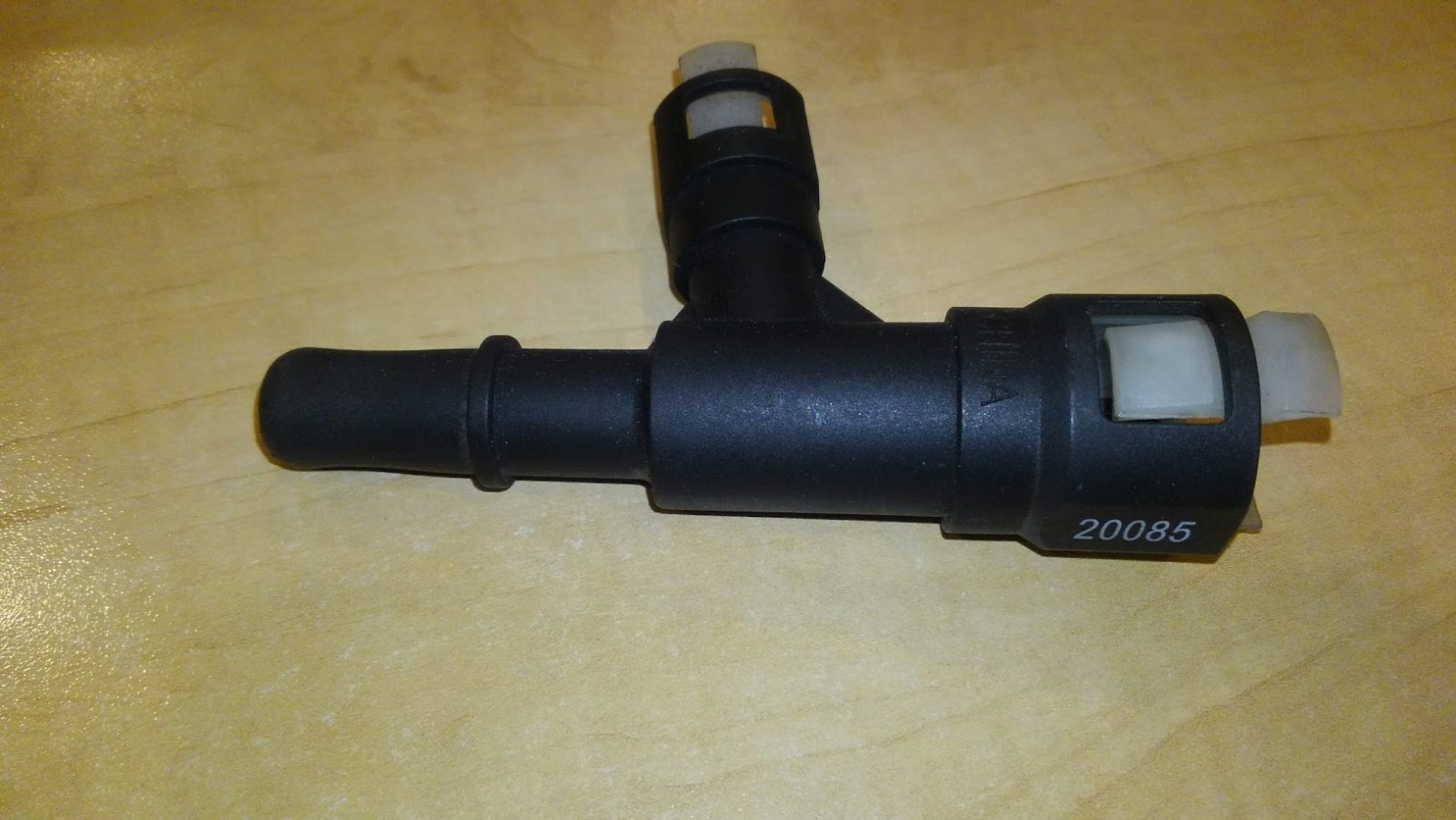

Prior to picking up the OEM Tee fittings, I ran across these new ones in a Tahoe at a PYP yard. I have looked online and can't find any info on the part # 20085 that is printed on this Tee. Anyone know what brand of Tee this is?

What are the uncolored characters that are molded into the tee?

There are none. Only "Chiiiina"
