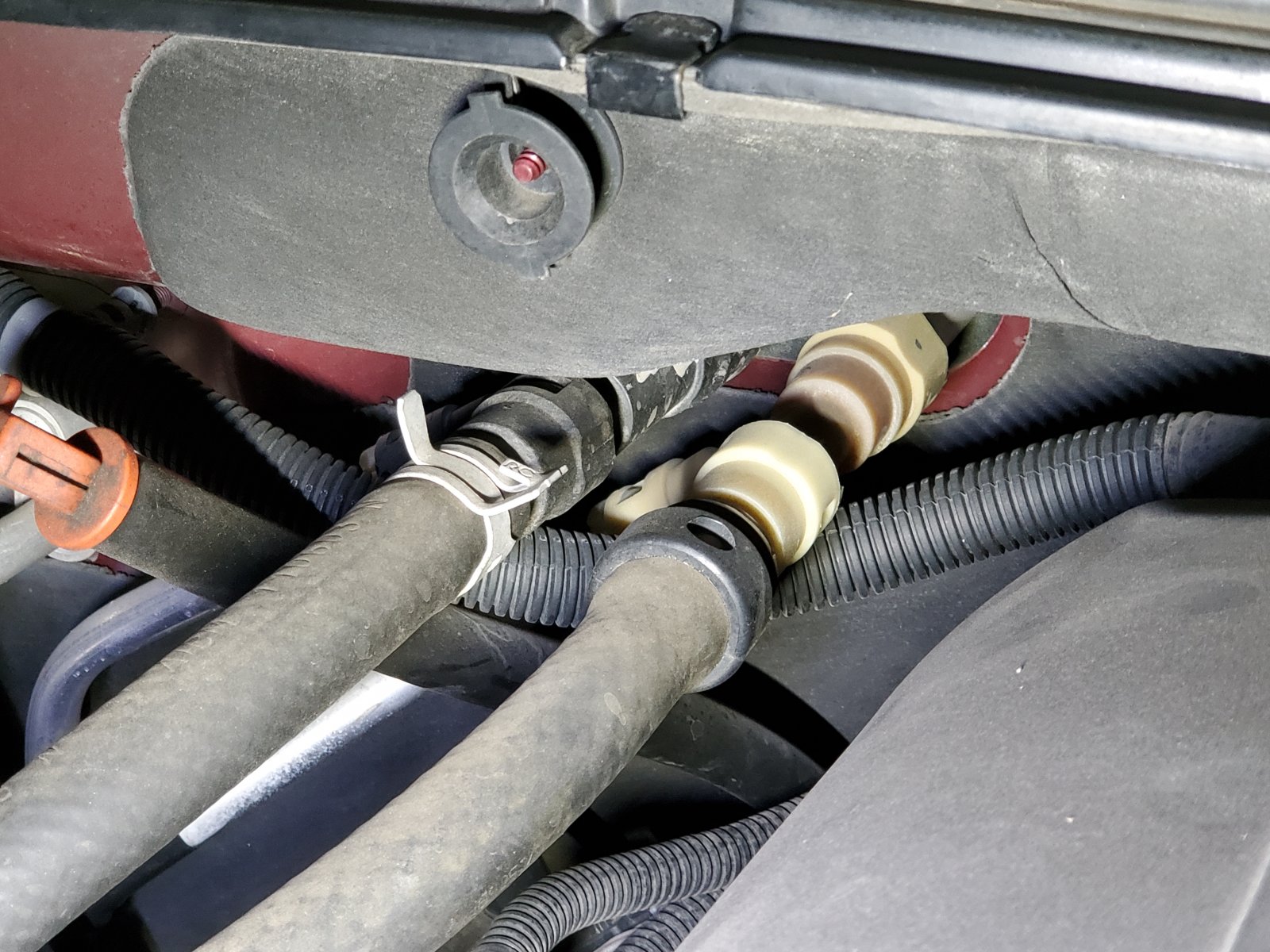

xx343 is the white connector and goes to the heater core pipe that is nearest the driver's side. This one has more of a 90° tee than the black tee. The hose coming from the water pump is the one that has the "y" in it at the WP connection.
xx342 is the black connector and goes to the heater core pipe that is nearest the passenger fender. This one has less than a 90° tee that takes the down connection away from the firewall (angles toward the front of the engine compartment).
Note the different styles of hose connectors that come from the WP.

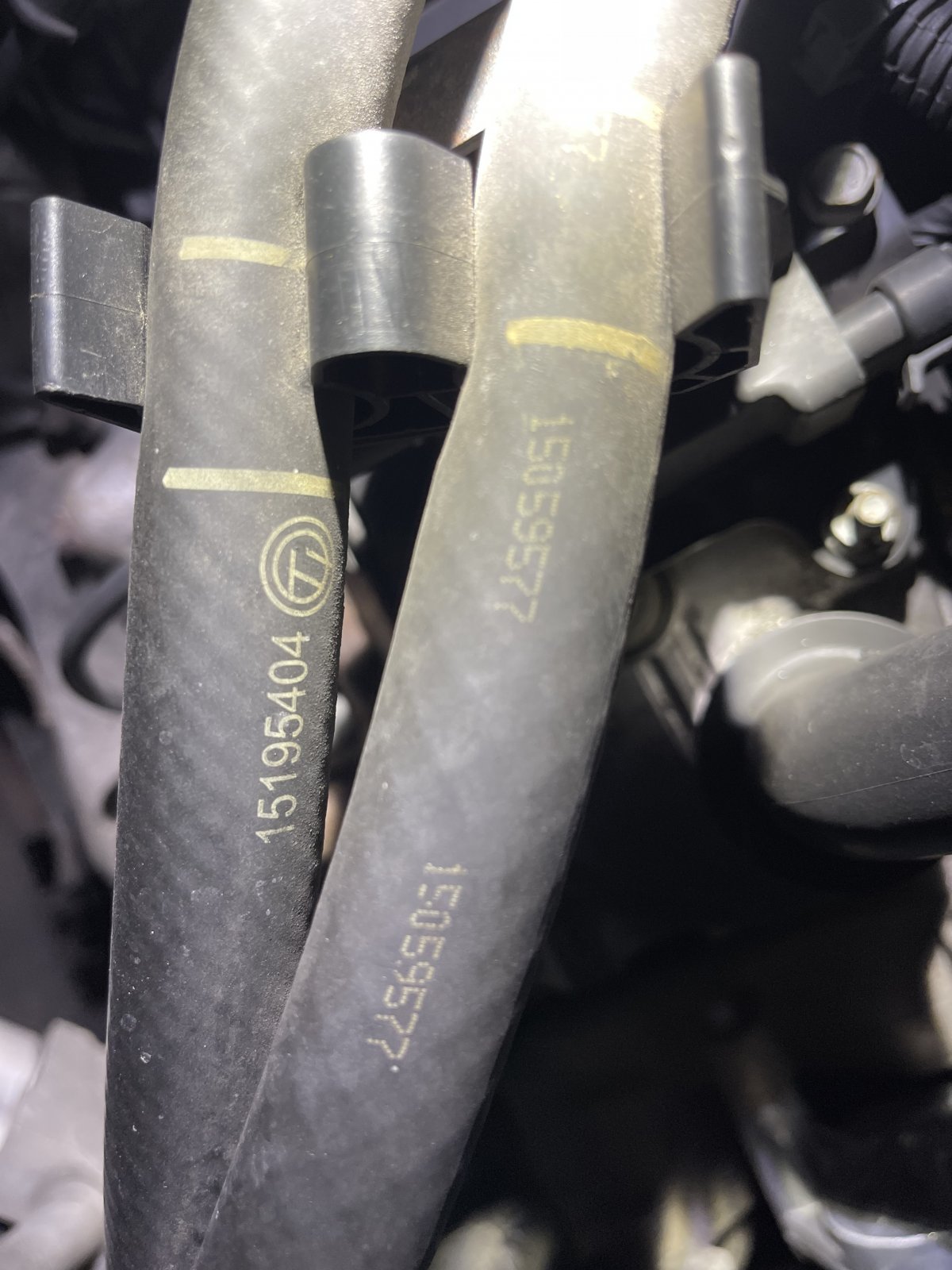

Gotcha checked mine out they seem perfect not sure i should even replace them.Even the hoses look great but i want all the part numbers in case i need them quick.Seems like the numbers on my heater hoses have be changed to new numbers so found 1 on rock auto but not the other-but im sure i will find something
My 2001 currently has 240k miles on it. About 2-3 years ago I had to back flush the heater core because it stopped putting out heat in the front and I figured it was clogged.
These plastic T's were the original ones that came on the vehicle when new and I figured I should replace them for preventative measures while I had them off and ordered new ones before I did the job.
The ones I removed were in surprisingly good condition still, even at 200k miles and 19 years old.
I've heard that these T's get brittle and crack and leak. I guess a lot of it has to do with the environment/climate the vehicle spends it's life in, and how often they're messed with (disconnected or hoses moved/pushed out of way for maintenance of other engine components) and stresses placed on them.

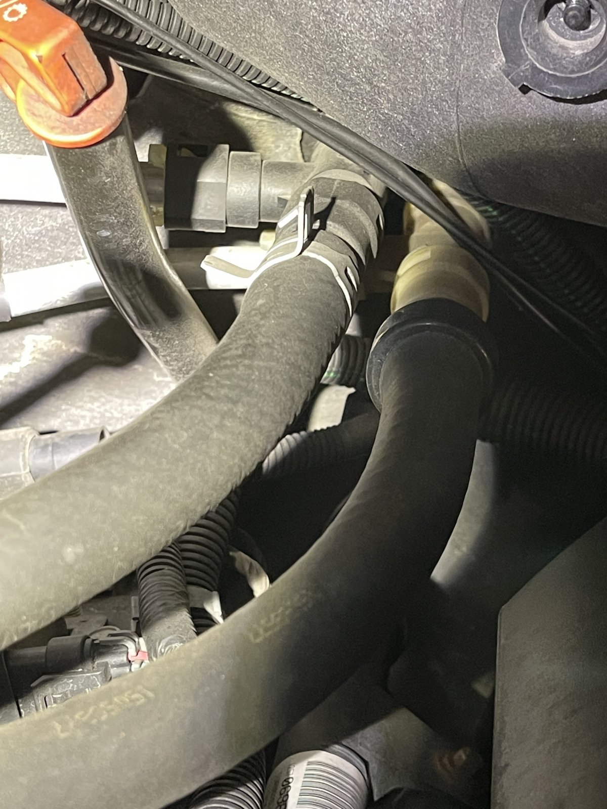

The end of both hoses have a quick connect that slips over the end of the T fitting. The side of the T that goes onto the heater core pipes and the metal lines that run to the rear heater core slips over the metal tubes and click securely over the barb on the tubes.
There are 2 tabs at each connection that get pressed/squeezed which raise the clip that secures over the barb. I've found that if you push the fitting "on" more, then squeeze the tabs, then pull, the connector disengages.
Remove the hoses first, then the side pipes going to rear core, then the T from the front core.

I replaced these and the hoses yesterday on my 2006 Tahoe. It is a bit frustrating. Get the right side (facing to the rear of the car) first. This allows room to get your fingers on the tabs of the other fitting. After about 1 hour of pushing and pulling I got both off. Strong fingers help. I thought of using a hose clamp to push down the tabs. I didn't try it because thought of it afterwards. Taking the other ends of the hoses off helps because you can turn the fittings to get your finger in a better position. I bought a set of plastic AC fitting removal clips - these didn't help. I cleaned the O ring sealing surfaces with an old fine scruff pad and coated with SuperLube so as not to damage the O rings during install. I used OEM parts bought at my local dealer, I got tired of looking on RockAuto. I paid a huge amount of money for them. Don't care - I don't leaks or doing this all over again. I bought the hoses from the dealer also. They come with the clamps "pre-loaded" which is nice along with the markings to get them installed correctly. So far so good. I'll know later today after a drive.
