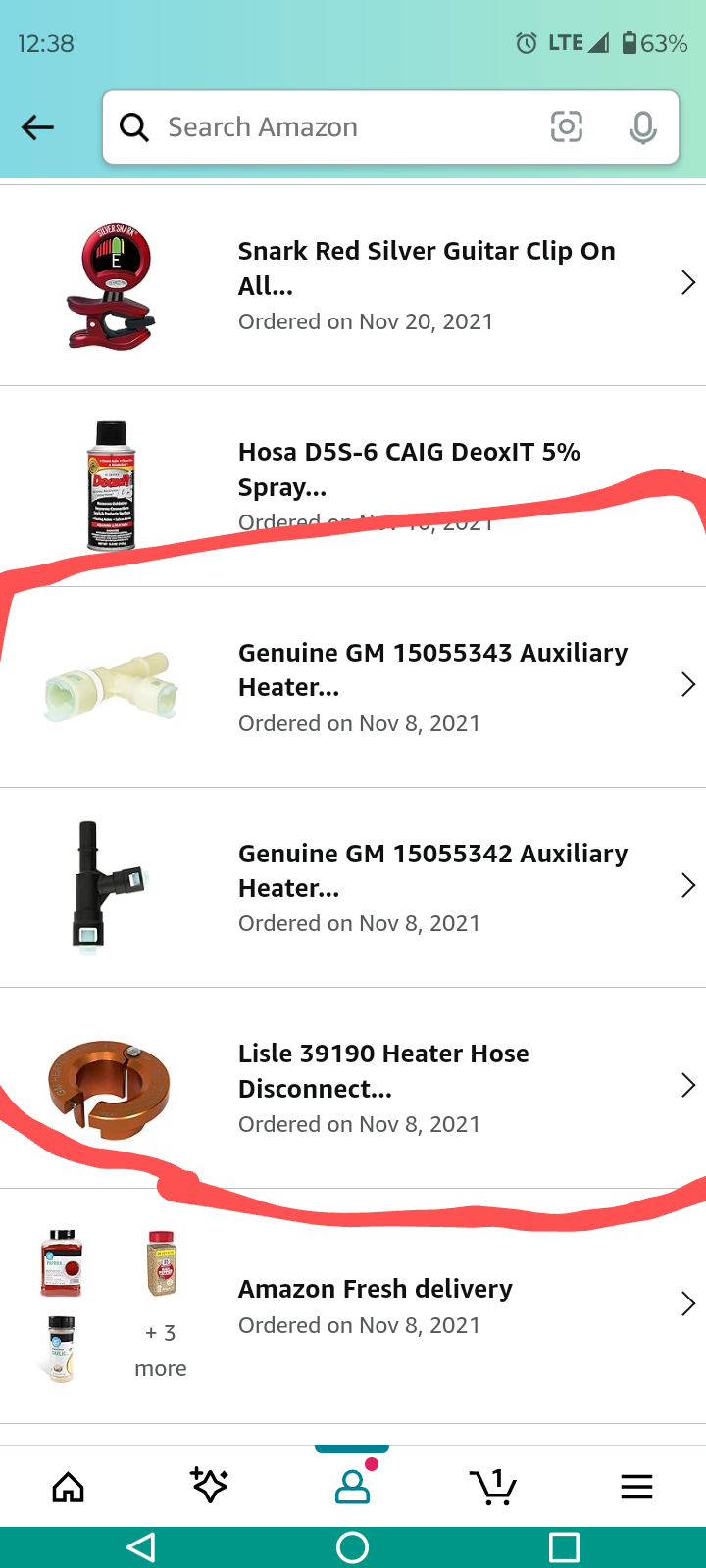

I have a 2004 Tahoe 4wd. While changing my spark plugs on passenger side I broke off the heater hose from water pump to the firewall I got the connector off but the nipple to the tee is also broke should I replace the tee and connector or is there anyway for my to take the tee off and connect it straight to the firewall

Those tees get brittle with age. At least it broke in your time to fix it, not while driving!
They do make a tool to remove them. It's like a split aluminum ring quick connect removal tool.
But just break them off and get replacements. Use GM Genuine replacements. I got mine from Amazon. They are different sizes IIRC.

I hate to ask but anyway you might could post pictures of which part there are so many different varieties even if I look up the gm parts I'm so confused

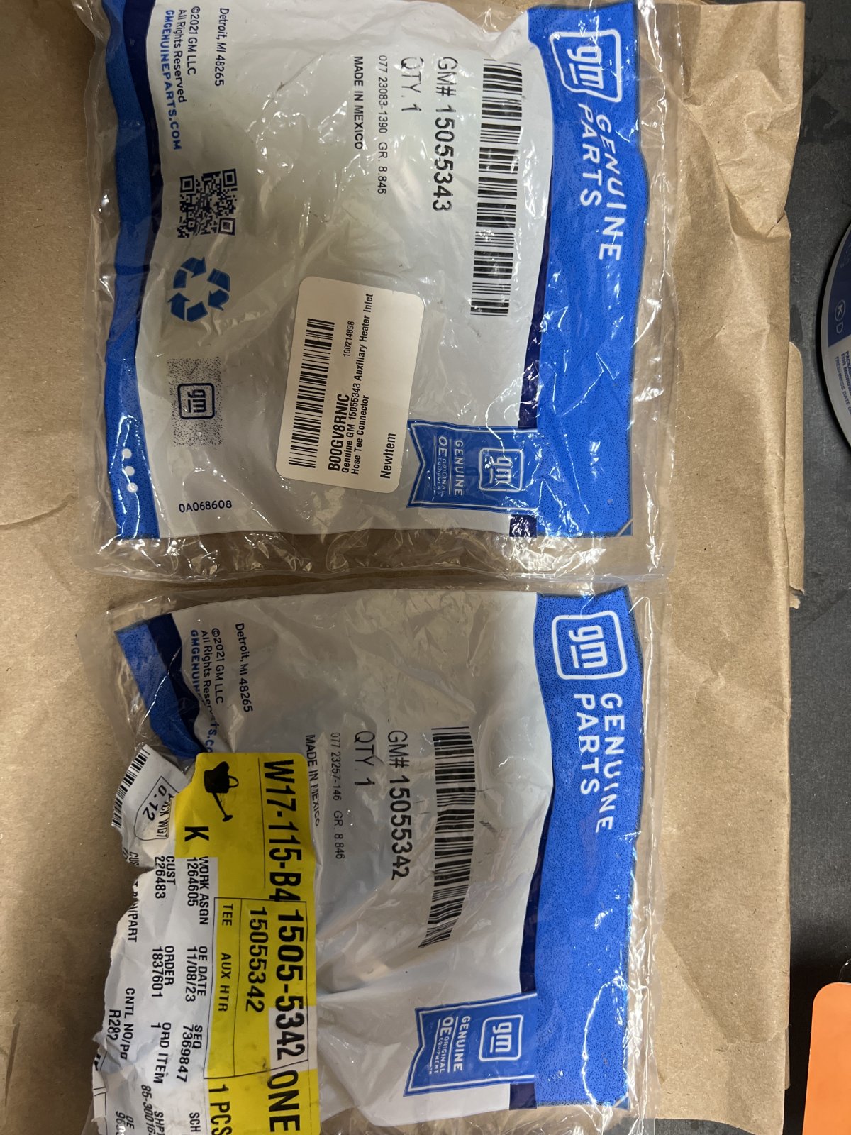

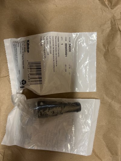

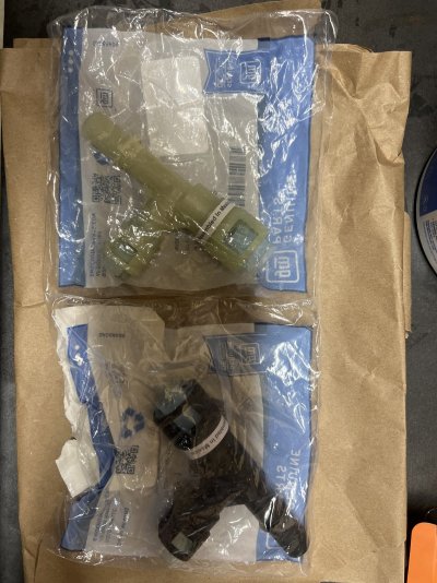

Yes!
Here you go. And there's the removal tool if you want to get that as well.
Those were for my 06 Suburban, but I'm pretty sure it should also fit an 04 model.

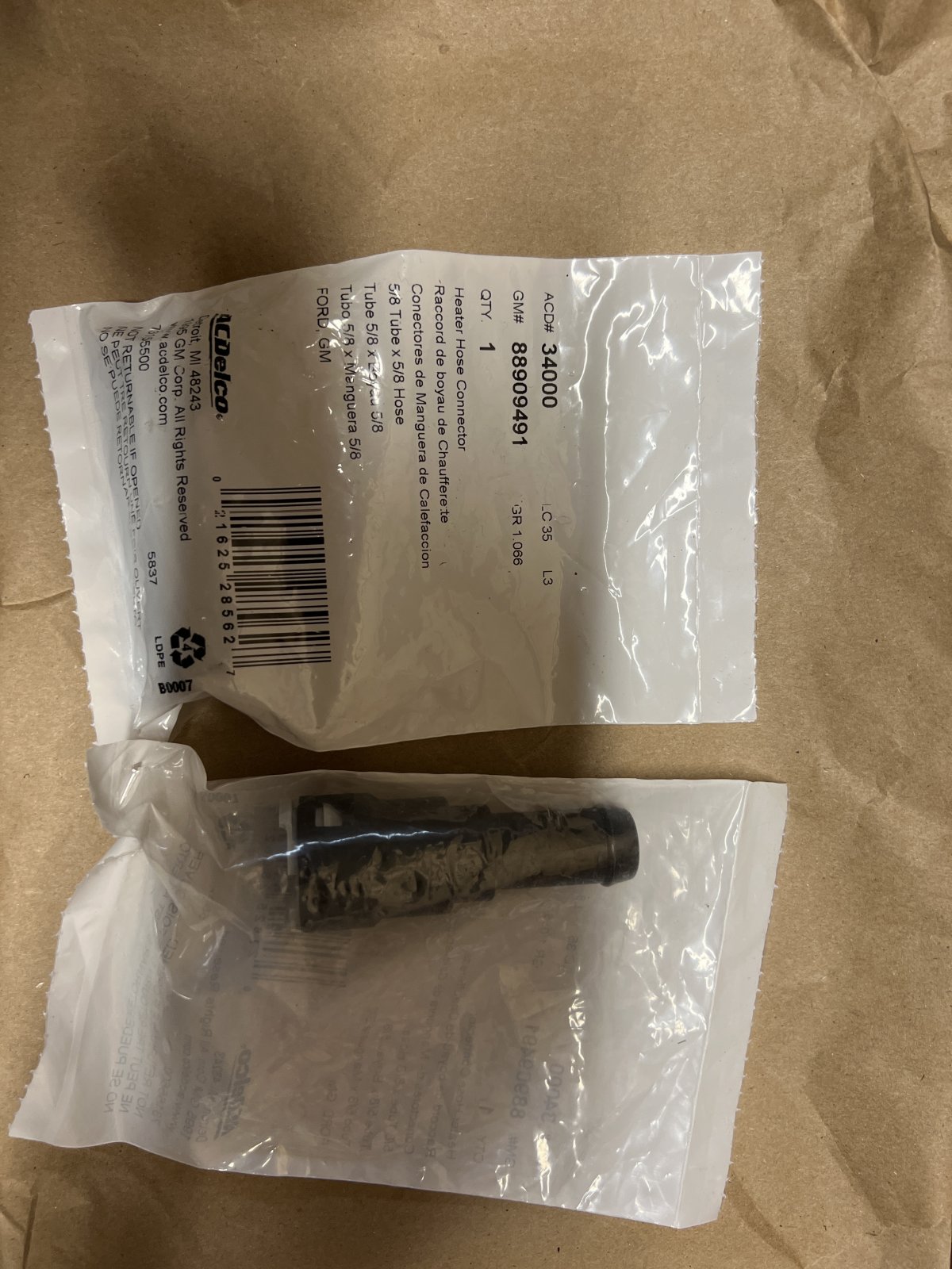

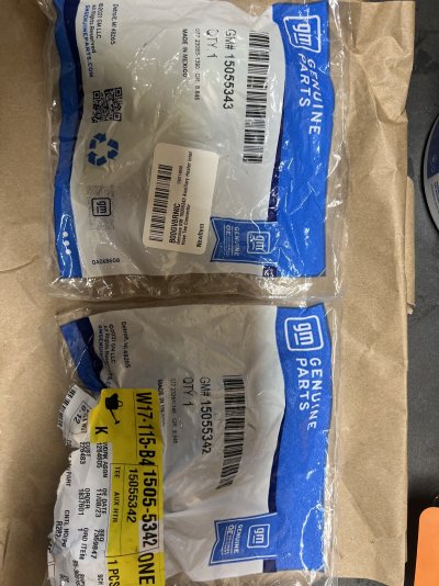

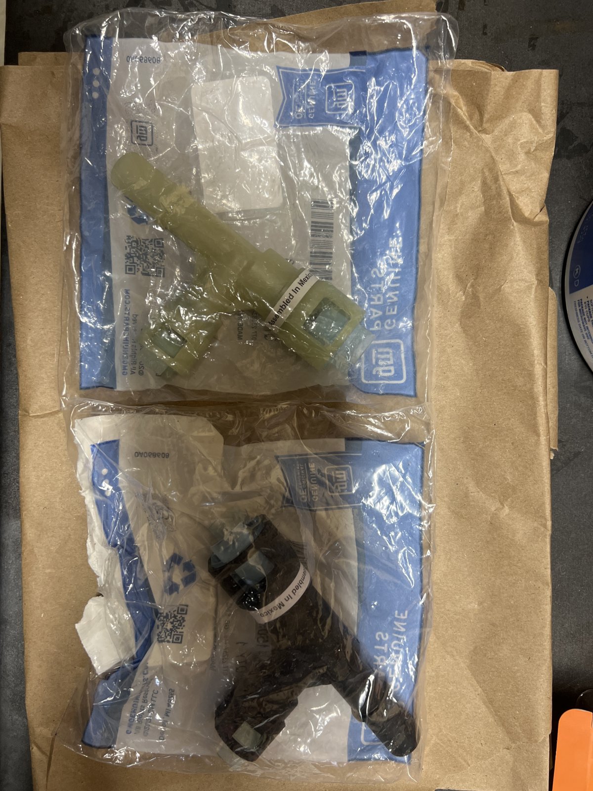

If you are talking about the tees @ the firewall, here are the numbers I have for my 2003.
1 each: 15055342
1 each: 15055343
2 each: 88909491
All genuine GM parts.
Guessing that once installed should be good for another 20 years.

That removal tool is almost useless for plastic that has been in place for 20 years, easier to just cut them off with some needle nose pliers, the plastic just cracks apart or will tear like it softened up, break the short piece off and then you can just pull them off
10,544
15,305
As @Doubeleive stated, the removal tools generally don't work well. I tried every removal tool that I could find, and none of them worked. I just broke them and removed them as he stated. Also, if you don't go with the Gruven recommendation above, purchase only OEM GM Tees.
One method that was discussed in this Forum after I changed my Tees out that seems to work for some folks is to first push the Tee further onto the pipe (not a lot of force) and rotate the Tee on the pipe to break the set position of so many years, and then to squeeze the tabs and pull straight off.
Note: Wear a pair of gloves when working with those Tees, as the firewall insulation is very aggressive, and your hands will be itching for a few days afterwards, if you don't.
