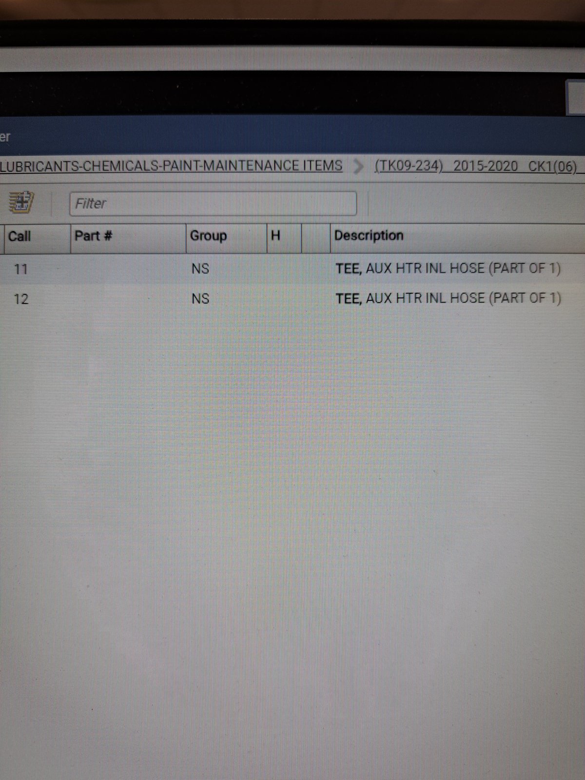

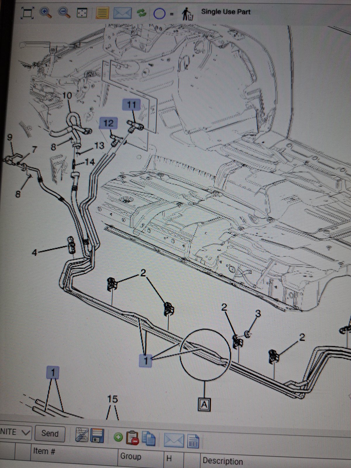

The T's for the rear heater are not serviceable separate. They are part of the rear heater lines #1.
ok,,,,,,, thank you for clarifying, still needed a part number
which appears to be
More Information for GM GENUINE 1534693
{Alternate Inventory Numbers: 15-34693, 84524267, 84170679, 23499086, 87846082}
and it is shown as ac line, but is actually both ac lines and both heater lines including the T"s
which from all appearance look like they are indentical to the T's for the GMT900's
rockauto has it for $209
and my local dealer price is $600

the part you seek is 84524267 or as shown below
basically you have to buy all this pictured crap to get the T's
***PLEASE LET US KNOW IF A GMT900 FITTING WORKS IF YOU DECIDE TO TRY IT

the lines are fine it's just some moron decided that they shouldn't sell the T"s separate which is a complete waste.
If I have to order the whole aux line set for $209+ tax and shipping, then it will most likely all end up in the garbage except the T"s
I'm probably going to order the K2 heater hoses and the gmt900 T's and see if the hose fit's the T's, if not then I will have a spare set
if the hose fits then the aux heater line should fit also
The service manager from my local dealer is going to call me in the morning and I am hoping he will know if they fit or not.
30,570
48,057
service manager from my dealer called me back this morning and confirmed in the shop they are using the same GMT900 T's but... now the white one and black one are swapped to the opposite side because of the way the aux heater lines are angled going to the rear.
