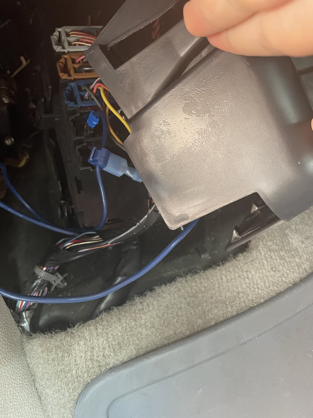

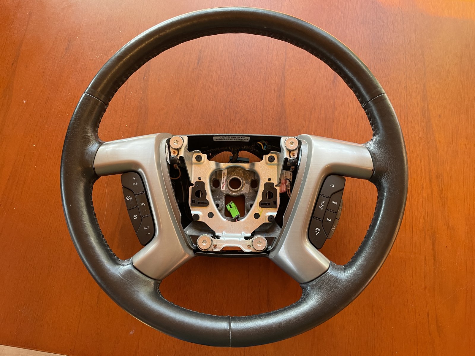

Was able to hunt one down sooner than I thought! Found a really nice one out of a '14 Tahoe! I have clockspring 25966964 on order, so should have everything I need to give it a go in my '09. This wheel is actually in a little better shape than my current wheel, so that's awesome.

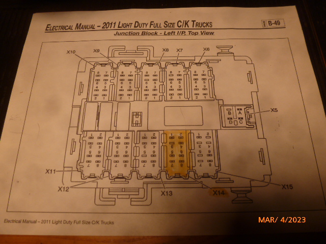

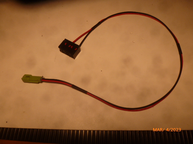

Picture is the harness I made for my 2011 Silverado to connect the column side of the clockspring to the under-dash Junction Block, cavity x14. This is for switch power and a ground.
I am not sure if the Tahoe has this Junction Block and an empty x14 spot for a connector.
I am not sure if the Tahoe has this Junction Block and an empty x14 spot for a connector. View attachment 393642View attachment 393643
Where did you get the connectors/ends? And which PIN numbers on x14?
