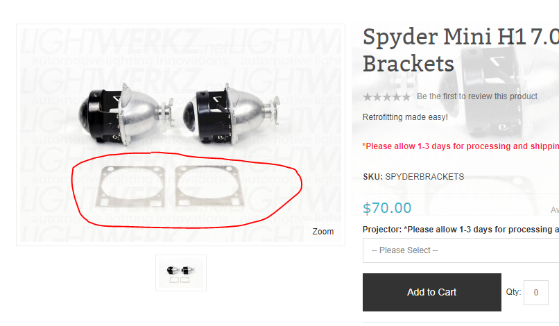

Found these brackets on lightwerkz and retrofitsource
"C-Brackets replicate the factory mounting points allowing for a no hassle installation"

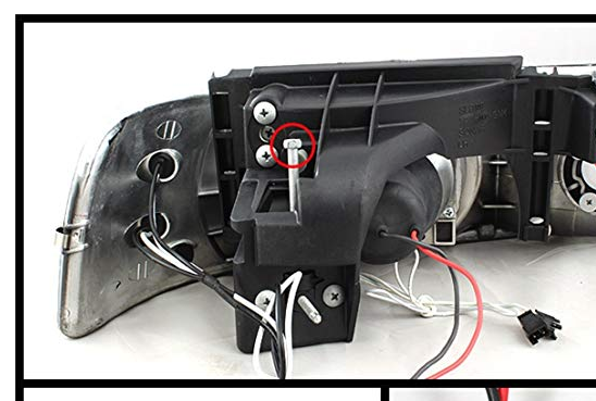

Sounds to me like it is replaceable without opening the light assy. I'll take one of my lights out and see if I can remove the halogen projector from the back by unscrewing it and verify that the bracket is made for my particular lights.
If it that easy I am all over this! :head3:
