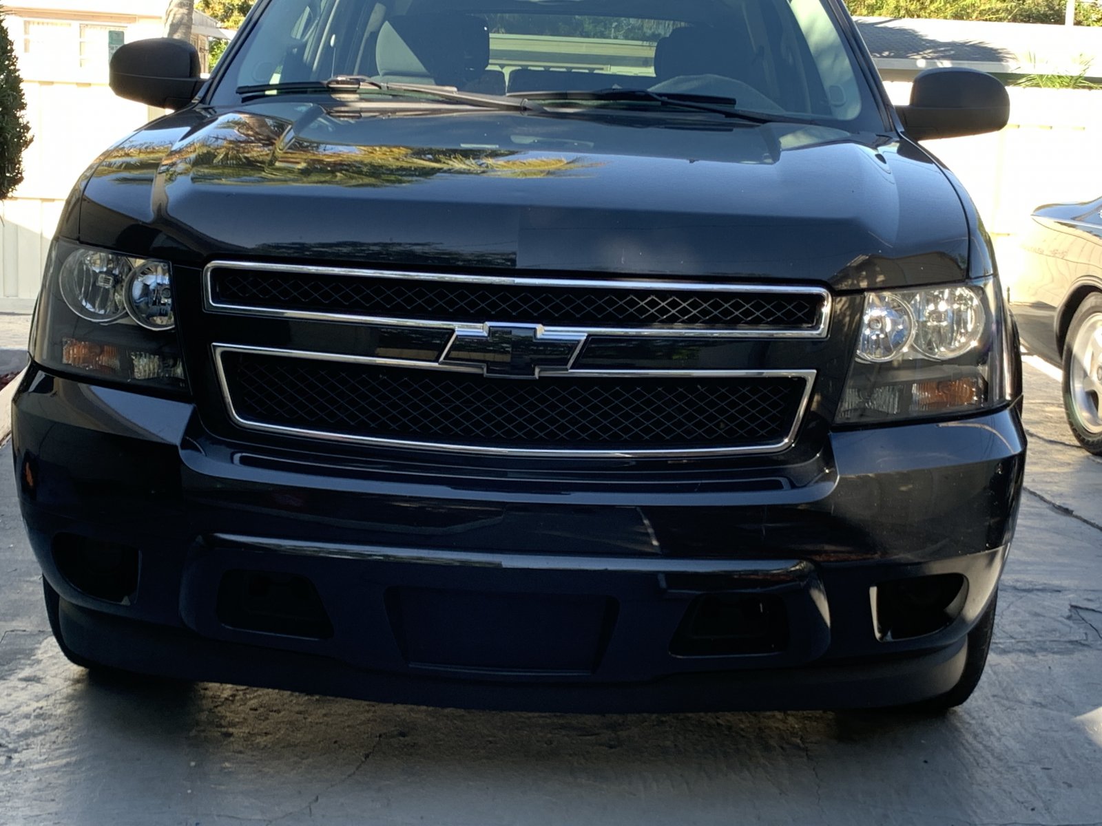

I ponied up and bought new OE ones. My kids, who like everything LED, say my new lenses and bulbs are much brighter than they used to be now that everything is new.
The numbers on the right were the current, the others original. They come with all bulbs. Paid over $550 for both, they are a bit less right now.

These are aftermarket, with the clear reflective lens not the amber ones. $134.00 let’s see how long they last, better than the yellow OEM ones i took off.
