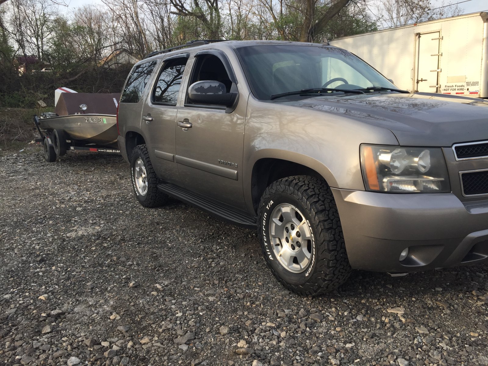

What about the inside of the lenses? If it is yellowed on the inside your are pretty much screwed right? That's my situation. :/

Doesn;t really show up too well in this pic but the I had the outside of the headlights polished and the haze is on the inside now.

That is strange. The only thing I can think of that would cause that would be condensation due to a sealing issue, or perhaps too powerful wattage of a hid that melted or discolored from the inside. Other than that did you try turning off and turning your headlights on again?:crazy:

LOL I have no idea I had this truck for 6 months it's got over 300K on it.
