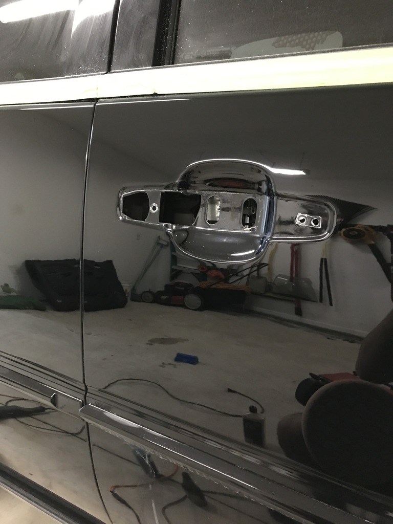

I wrapped up the buffing last night.
I removed the door handles real quick to get up close and tight. I also had to remove the mountain of caked on white wax from the previous dill weed "detail" shop.
Finished!
Very pleased with the results, I still need to seal the rear bumper but I ran out of microfiber towels.

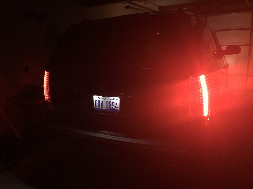

I also swapped the license plate bulbs to LED to match the rest of the vehicle. I plan to swap the reverse lights and under mirror approach lights to LED as well.

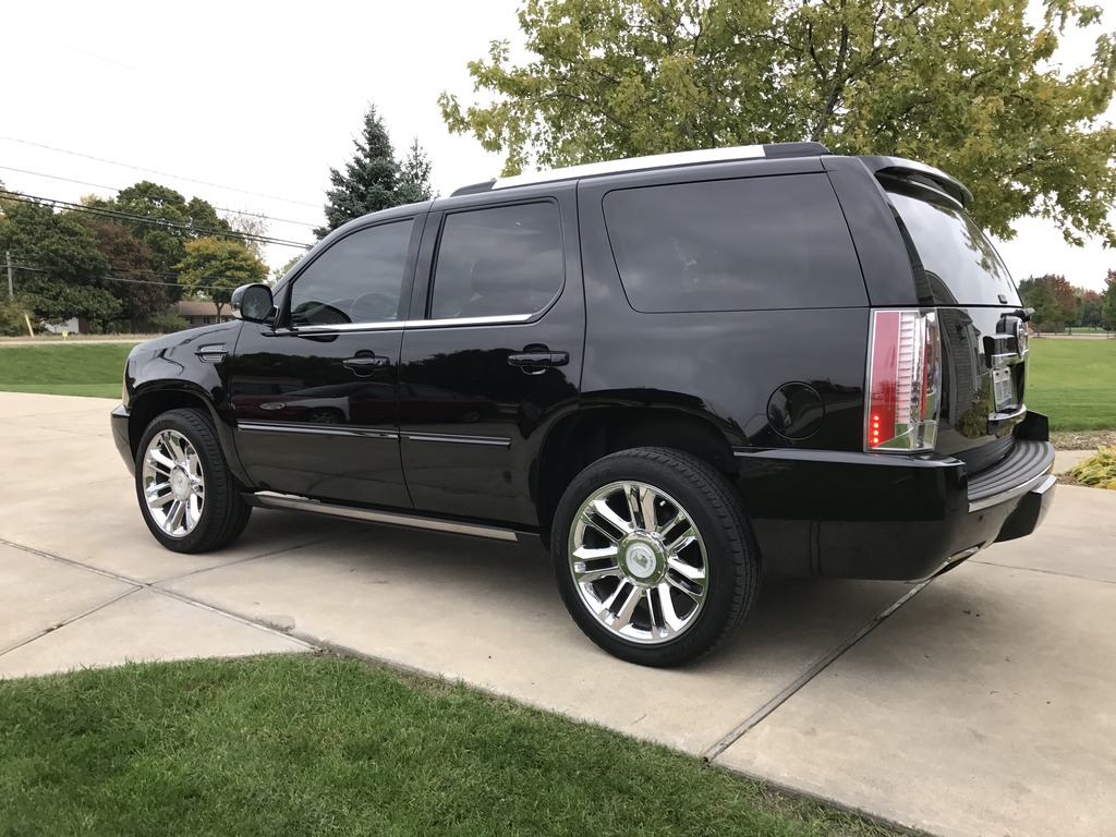

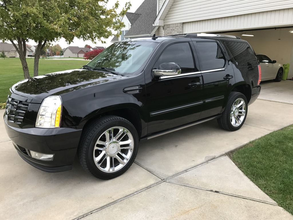

Pulled it outside for a quick picture!
I fixed the fog lights too! they haven't worked for years. A little digging resulted in my finding the fog relay to be missing. kind of random but I am happy it was a $5 fix!

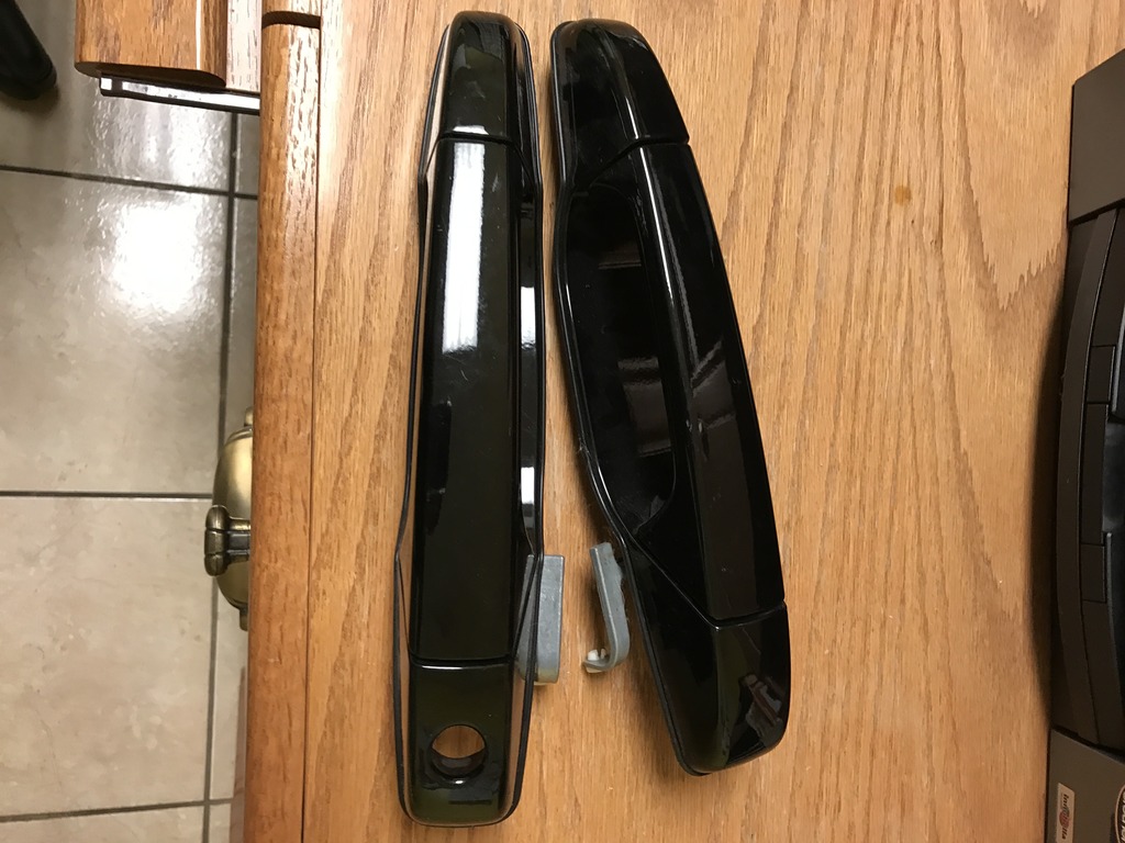

Friend gave me his Front door handles off of his 2013 Sierra for $20, now to find the rear handles.
Very happy with how the truck has turned out so far. I am also WAY under budget which never happens in car world or escalade world for that matter!

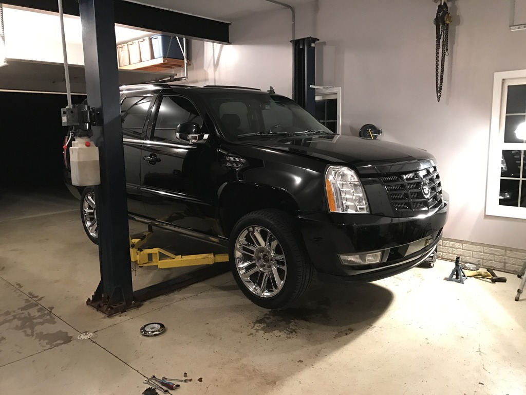

Got home from work this morning, my other two door handles I purchased off of ebay showed up along with my new front struts.
Swapped the handles real quick and was super pleased with the result.
I went over to my dads house (next door lol) and used the lift to make quick work of front strut replacement.
2 hours later, struts are swapped. They were both 100% seized. All of the oil was blown out of them too. Truck literally drove like a dump truck. After swapping the struts it rides like a caddy again and I am very happy.
I am going to enjoy the truck now for the time being. Spring time will bring lowered suspension and new wheels are tires.
