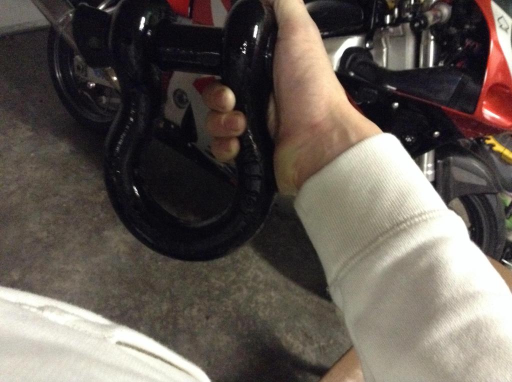

Got some powder coating equipment and all supporting tools needed to powder coat in my garage. So I tried my hand at it tonight with some D-rings I'm considering putting on the tahoe. Did one so far and here's how it turned out. I think it looks great.
And here it is in my hand as a reference to size

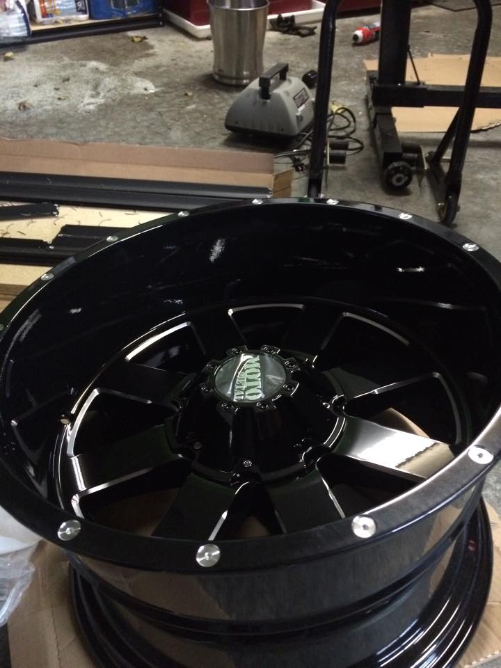

Well about to board a plane to fly across the country to finally pickup my new tahoe! So excited. Owned for about 2 months now and not seen or driven it, it's killing me!!!! But finally in the morning when I get off the plane I will get my new tahoe! Also, these showed up today at my grandparents house! Thank god for they shipped in time so I can get them put on for the trip back!

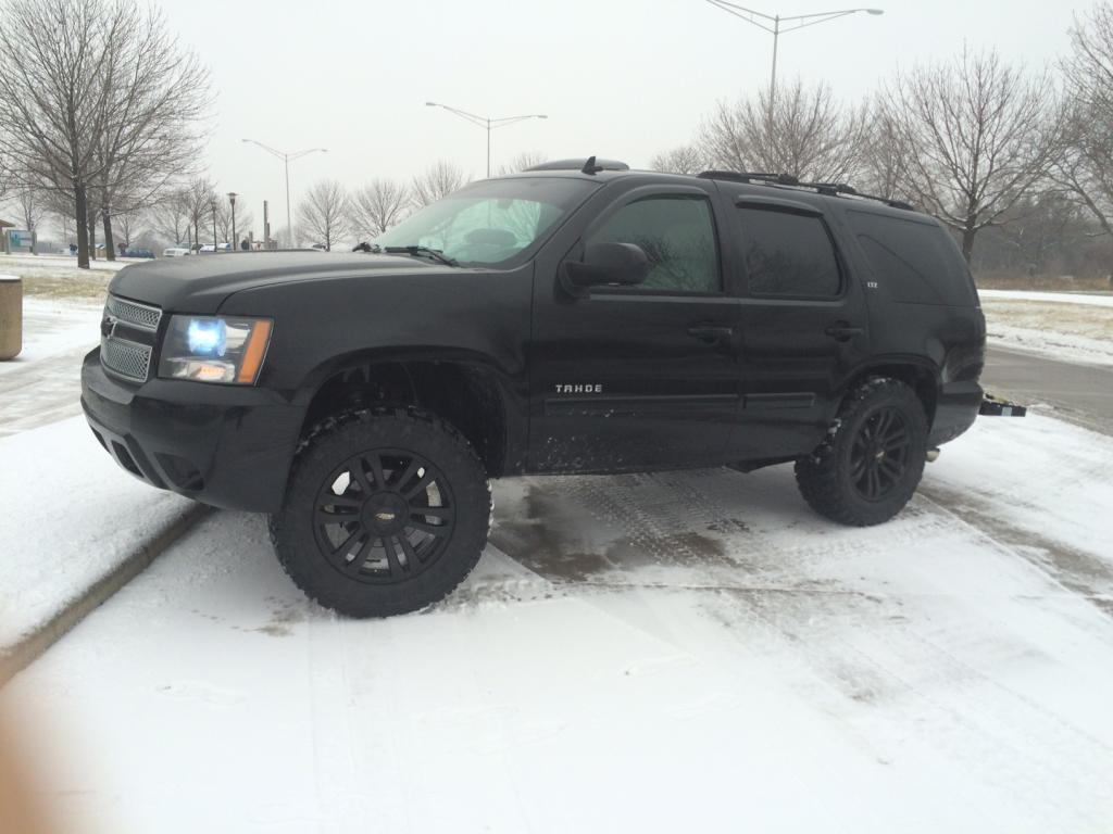

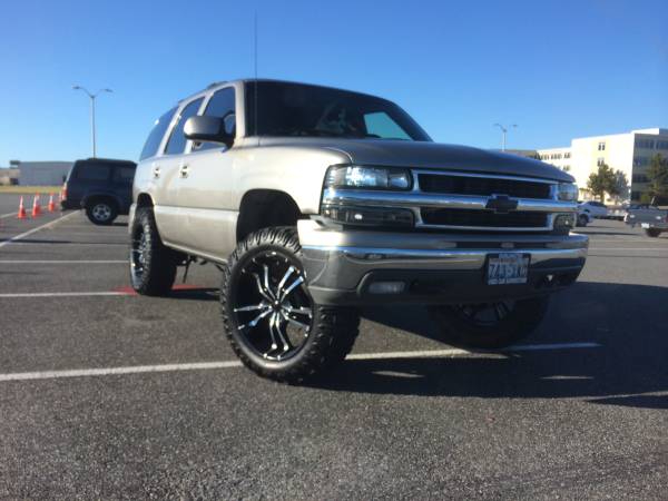

Ok, quick update here. Made it across country safe and sound a few days ago. Had the new tires put on in NC before I left and today before I went back to work I had the new wheels put on. Crappy cell phone pic and a short update for now. Have a few pictures from the trip and some other upgrades I did already to come. Trucks dirty but it's something to look at until I have more time!

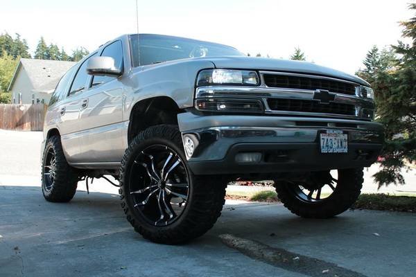

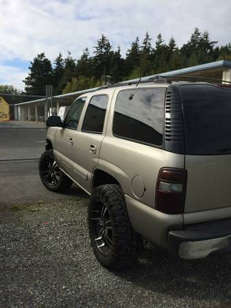

Ok, so while I had my Tahoe a little apart today in the garage while I was swapping tires onto the dodge (build thread in the other vehicles section) I noticed that at some point in time some genius stacked leveling kits up front and of course the already known no lift out back. Scored some spacers for the rear from a buddy for free and tomorrow one of the leveling kits is coming off. Time to get this Tahoe looking better than ever. As some know, I took off my 35s and put them on my dodge and the Tahoe now has 33s. Well, it doesn't look the best right now, hence why i'm taking the lift off tomorrow morning before the super bowl. Don't really want to drive it like it is, looks too goofy. Pics tomorrow.
bdt115
bdt115
Dec 7, 2013
37
Oak Harbor, WA
Ok so changed thing up a bit here and been working on my toyota build, among other things. Ordered a lift for the rear of the tahoe, some new 2 inch spacers all around, a new k&n CAI system and then some parts for the toyota. I'm wanting to start swapping the interior to all black...anyone Parting out? :)

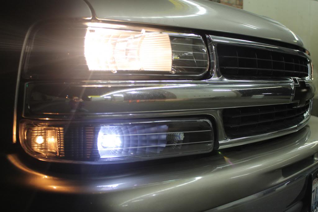

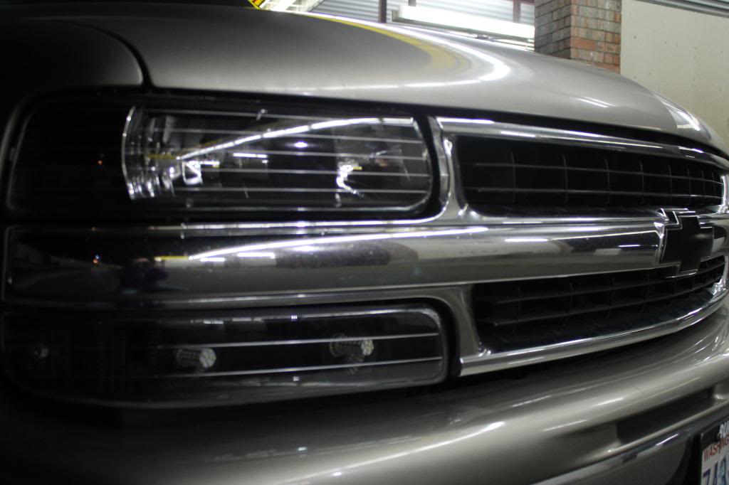

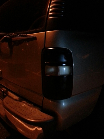

ordered stock headlights and stock fog lights and then ordered these clear led tails
I know I know. they're pretty ugly but they're all getting custom painted :secret: can't wait to finish them...should look great once done :anitoof:
