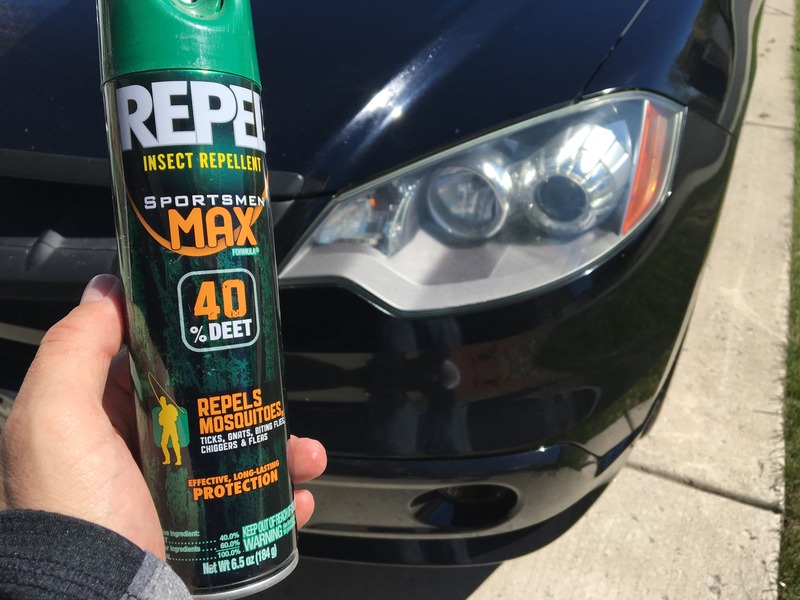

I heard OFF bug spray clears up lenses really well
This really does work but it has to have 40% deet. It goes away after a few months and can be reapplied.

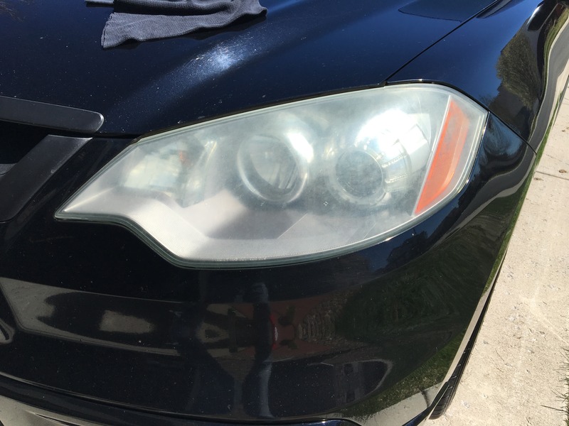

Well here's mine after a couple hours work. Mine came clear coated and it started to spiderweb and peel so I had to sand it all off. I use the 3M kit that's $18 from Wally, and needed to use some 400 grit sandpaper first to get the clear off. The 3M kit has 500, 800, 3000, and a polishing pad with compound. Works great for me!
Before & 400 grit
Both after 500 grit
800 grit & 3000 grit
3000 grit & polished with compound
It's late but I'll post more tomorrow after I shine her all up!
