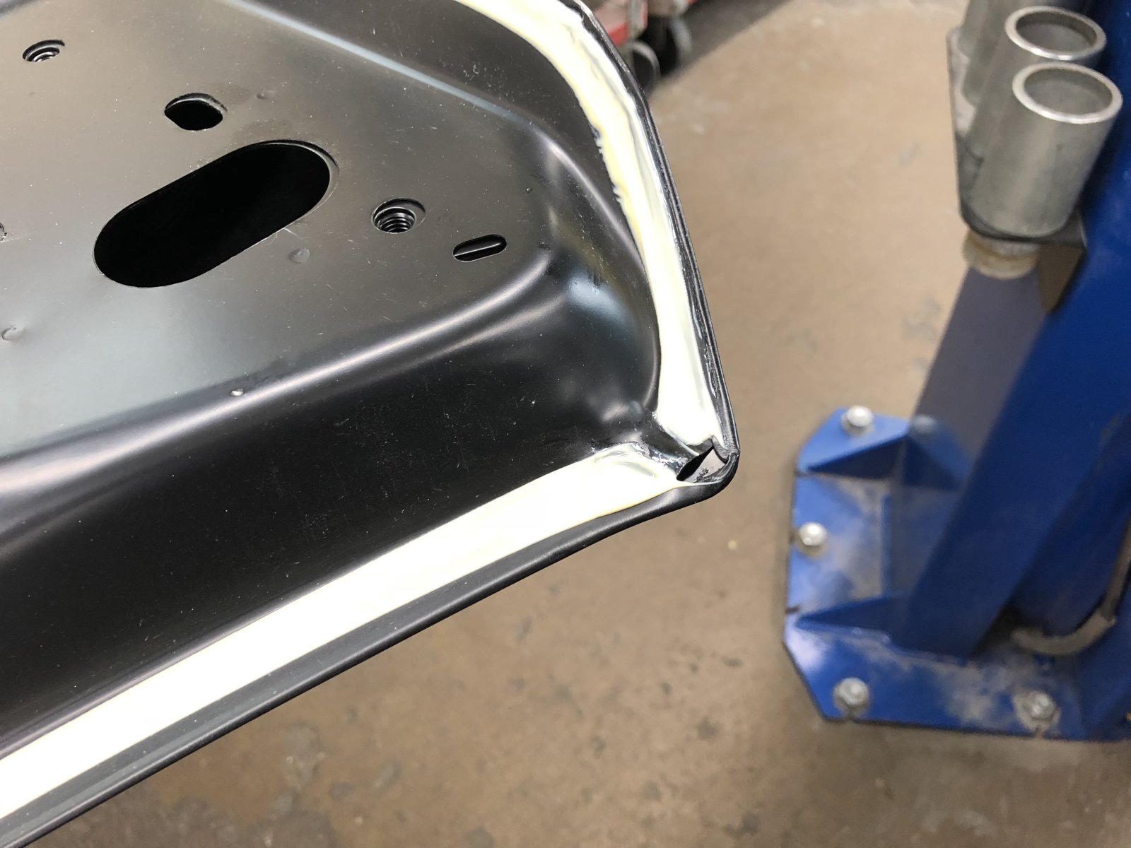

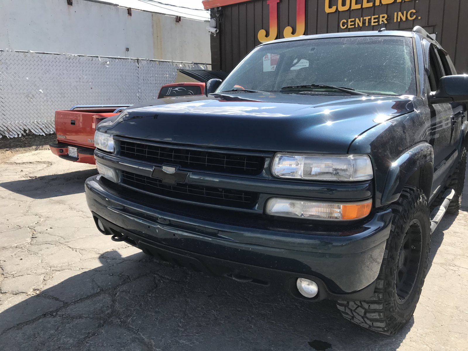

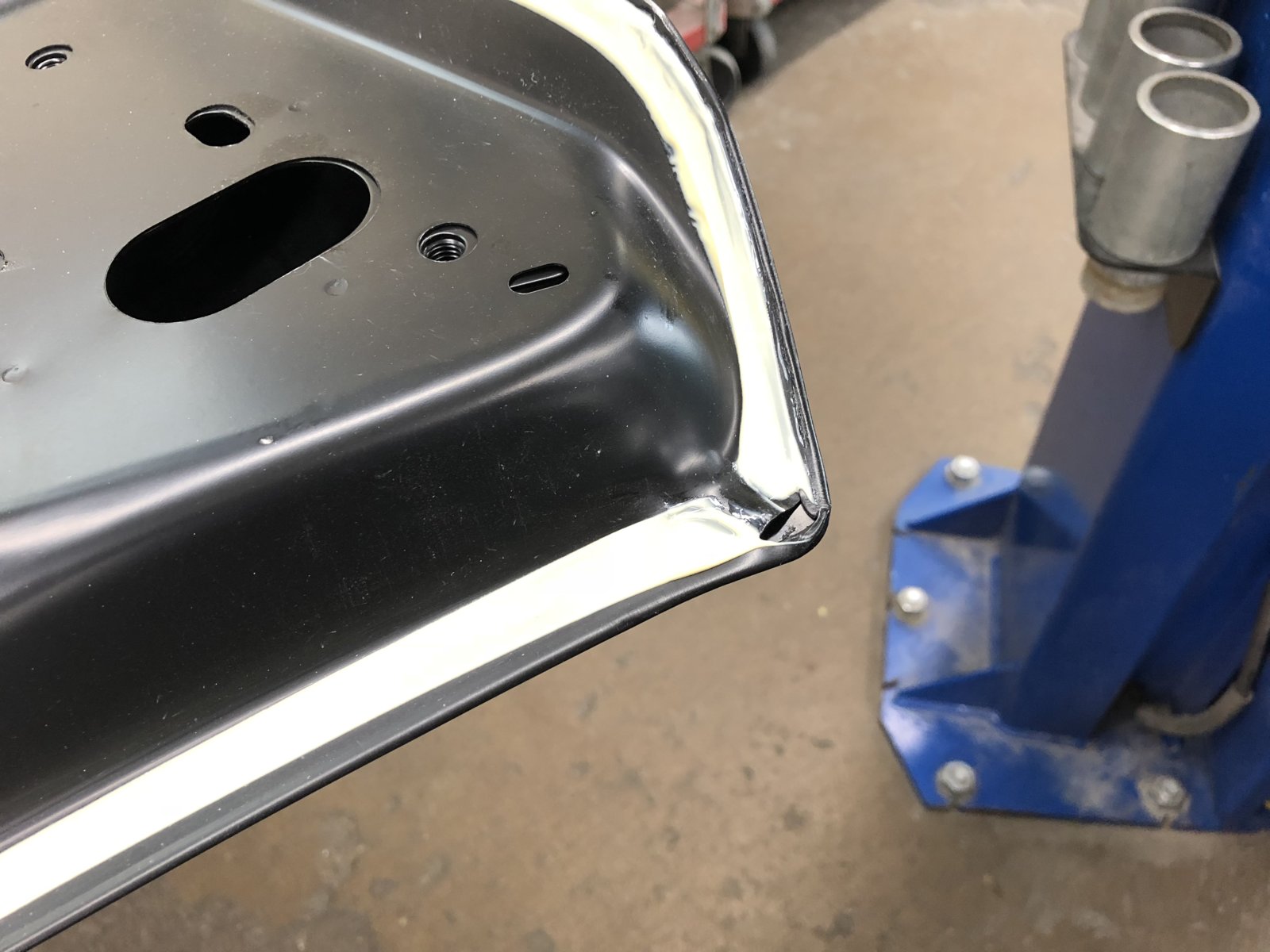

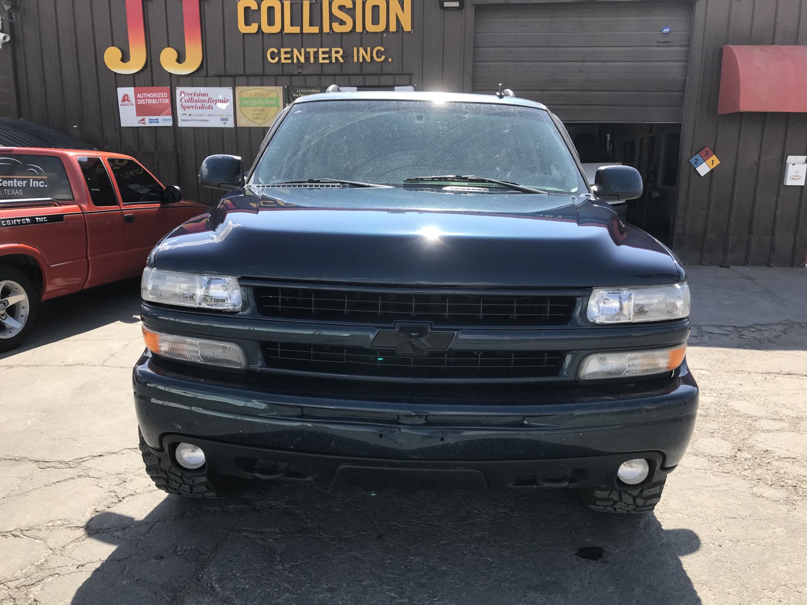

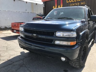

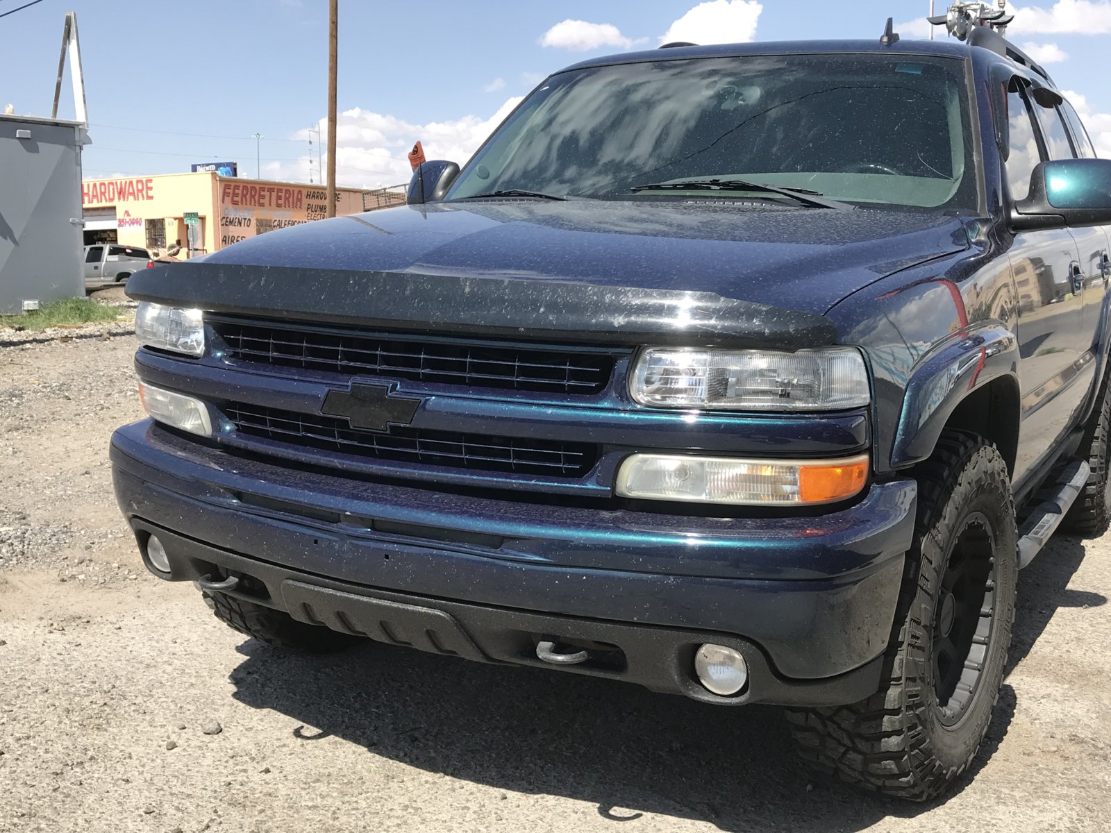

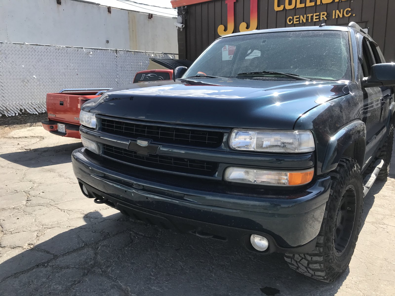

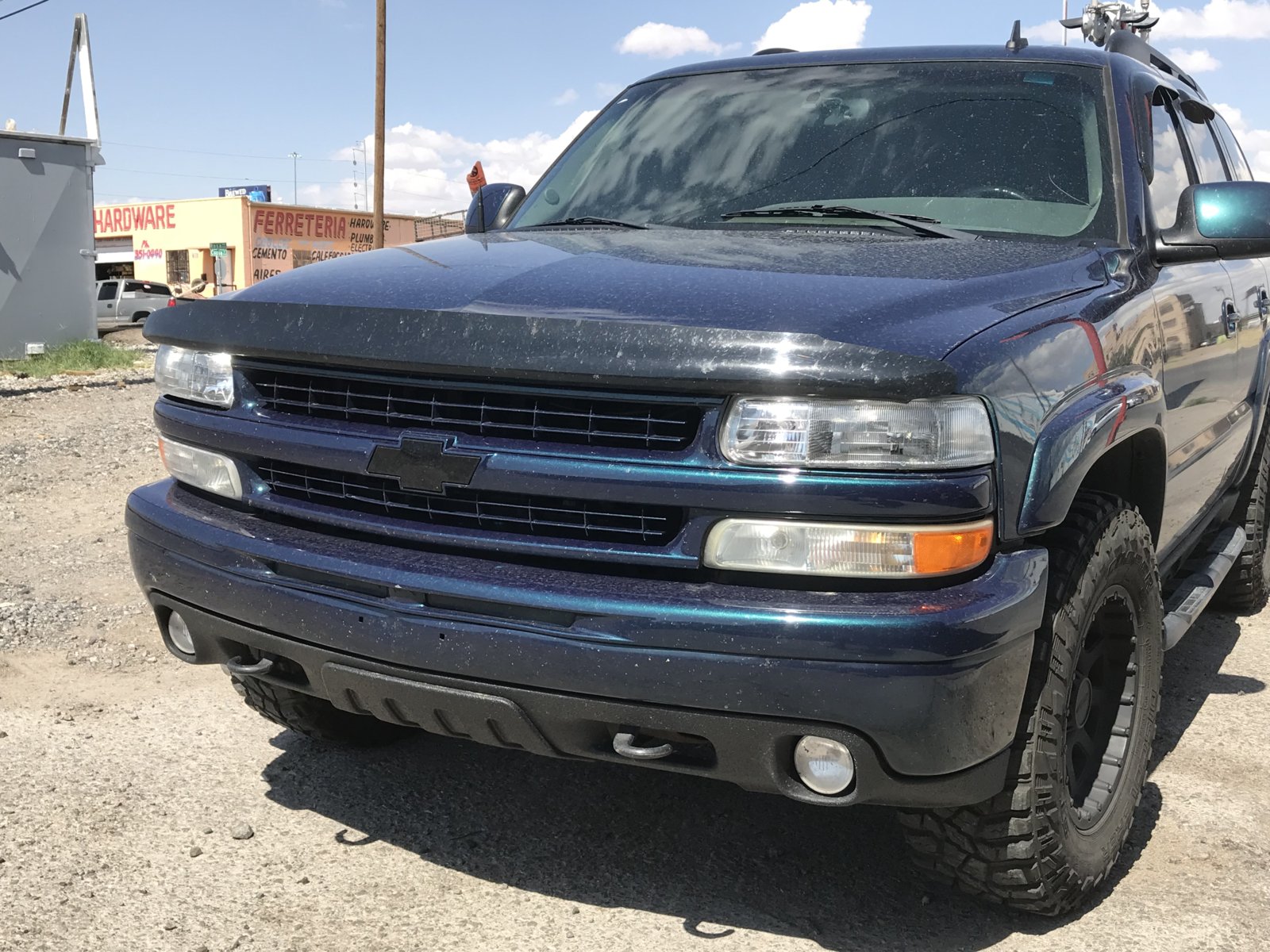

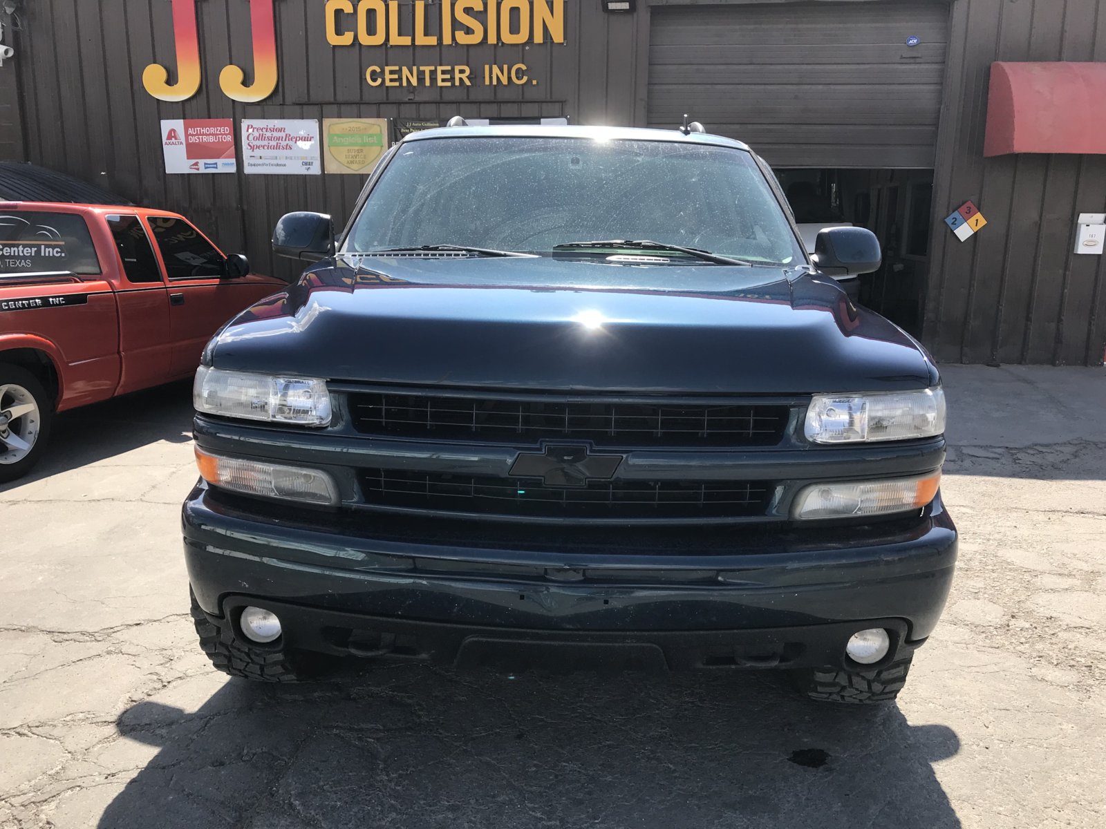

Finally got my HD hood mounted up! Used the brackets that came on the HD hood
751C1646-A37A-4866-BBF2-988418CC837B.jpeg 406E7243-710C-4D48-87B9-541CF8175CD1.jpeg 9FC50CCE-8BE4-4A61-A7F9-0574CEB187EE.jpeg
TheGreatGazoo
Jun 14, 2018
59
114
Hellinois

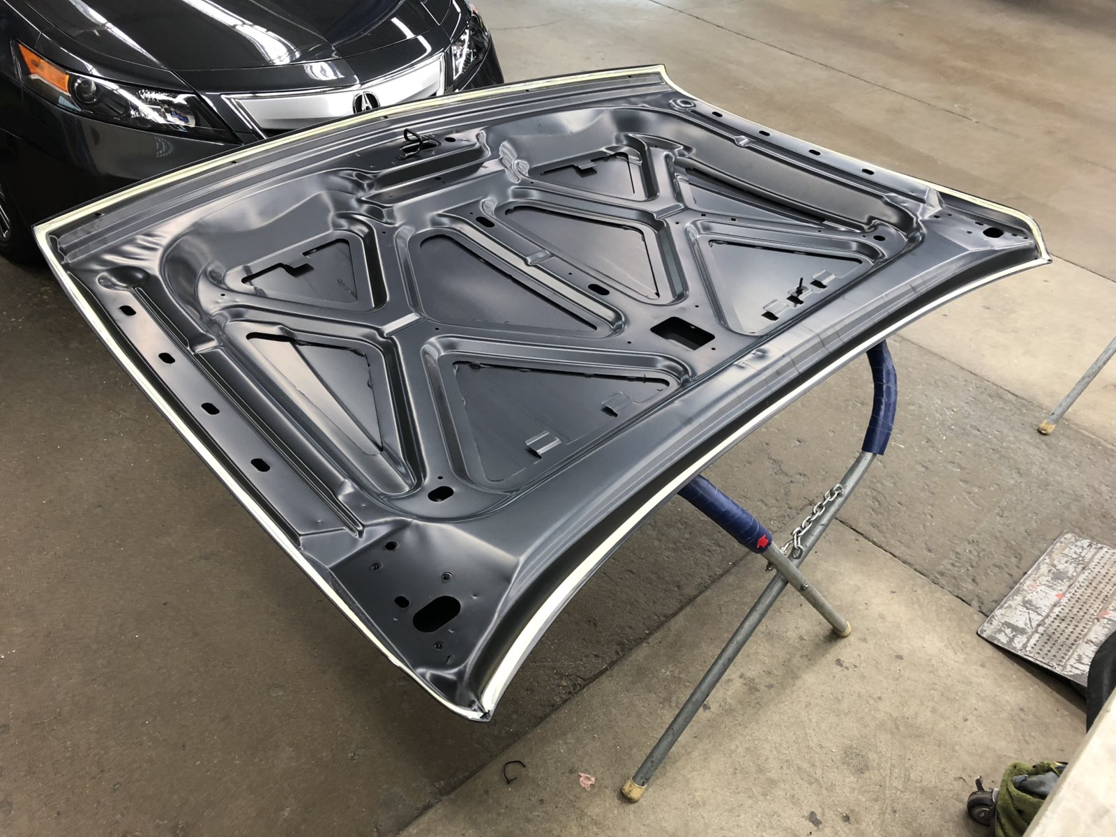

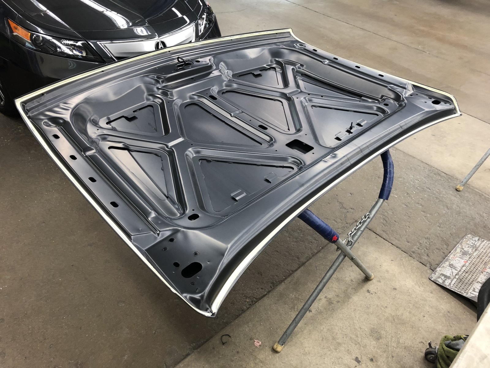

I'm guessing that's paintable but I'd still be concerned the paint will chip at the caulk. What exactly is your reasoning for caulking there?
The first reason is you’re replicating the factory appearance.
The second - We’ve encountered problems with certain aftermarket companies parts rusting up and it always seemed to start at the seams. This was our answer.
The product we use is from SEM and it’s a seam sealer (they have a few to choose from). I used the term caulk.
It’s just an extra step to try help the parts survive Chicagoland winters...
52,954
SEM makes good stuff. Seam sealer isn't what most people would call caulk so that's the reason I asked. The factory doesn't use a seam sealer at that location though, correct? At least not on any of my hoods. I take it you work at a body shop?
Yes sir I do and yeah, force of habit (typing how I talk). We work on the German cars mostly but that’s due to the dealer accounts. We’ll fix anything.
Most of the newer vehicles today are all seam sealed, especially the German ones. It’s just common practice around here.
We don't have rust issues here , glad we don't have to worry about that stuff. I'll never work on German cars again; my friend owns a body shop and he won't even take one in anymore. Things are overengineered and purposely made to be hard to wrench on. My daughter had a Passat and I hated working on that thing.
Once you learn them, they’re as easy as a Honda. It just takes time... I love working on them, no room for error and everything has to be spot on. I doubt I’d ever own one but I’ll fix them all day. Same with Maserati, weird shit, but with the higher labor rates you just can’t loose.
And I wont lie, I enjoy test drives to check for “wind noise”.
