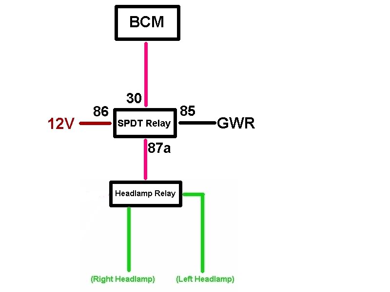

I sure would like it if the headlights didn't turn on when I remote started the car.
Like Dismay wrote, you could use your Ground When Running wire from the remote start, if it has one. I wired it up like this:
It uses one relay to interrupt headlamp signal until you take over with the key. For 03+, it's A4 at the gray connector on the BCM. I don't know which wire it is on the 00-02's.
Or you could do the ebrake wire like Dismay mentioned. It's the same concept.
