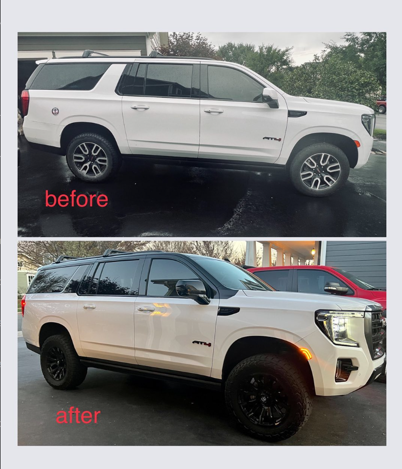

All you need to do is swap the factory links front and rear. No need to buy anything. Takes ten minutes and gave me at least 2.5". My neighbor showed me and he has 2956020 (33.9"). Minor rubbing. He had to trim small sections of the wheel well fabric and a little trimming on the under valence. It looks great. I hope they don't mind that I grabbed a screenshot.
I am thinking I'll go with 285/65/20. That will give me 34.6" tall and 11.2" wide. The 295/60/20 required trimming at 11.6" wide so I'm hoping that little less width with the right offset will save my bacon. However, being that it is .7" taller, that may cause rubbing too as it increases the radius from the hub. Will report back at some point.

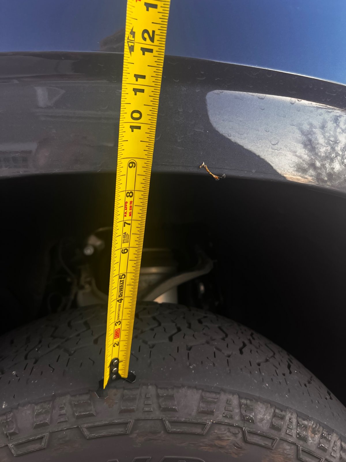

I'm using the adjustable links on my suburban. When it was stock I measured the normal ride height then the "lifted height setting". When i installed the links i adjusted them so now my Normal height is lifted height setting. Rides a little stiffer. I didn't get a alignment but the tires are wearing down so you will need a alignment after you install them.
