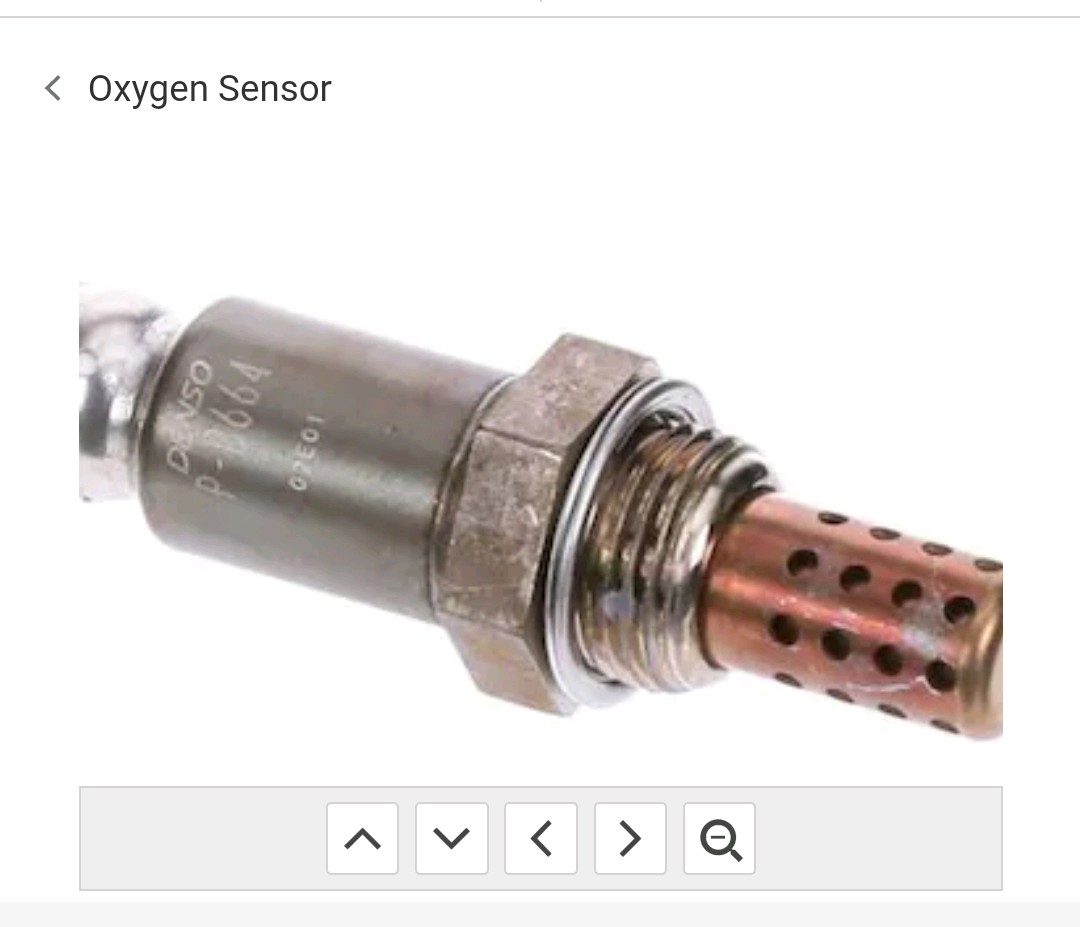

Great timing and looking forward to your alc % results! How are you testing it- test tube with water method? I've never heard of the Denso P-B664 in all of this.

Denso 234 4668 is what RA was saying for mine that I ordered :shrug:
Kind of interesting when I look up the Denso 234 4668 that O'Reilly's shows a picture of it, and if you zoom in, it is the P-B664... I don't put a great deal of faith in what sellers post for pictures but it is curious just the same. Also, get your tinfoil hat ready... 4668 is kind of like B664, but BACKWARDS!!!... lol
I can't recall if I ordered the old ones from RA or not, I would have to go back through my old emails to see, and to be honest, I don't think I care that much.

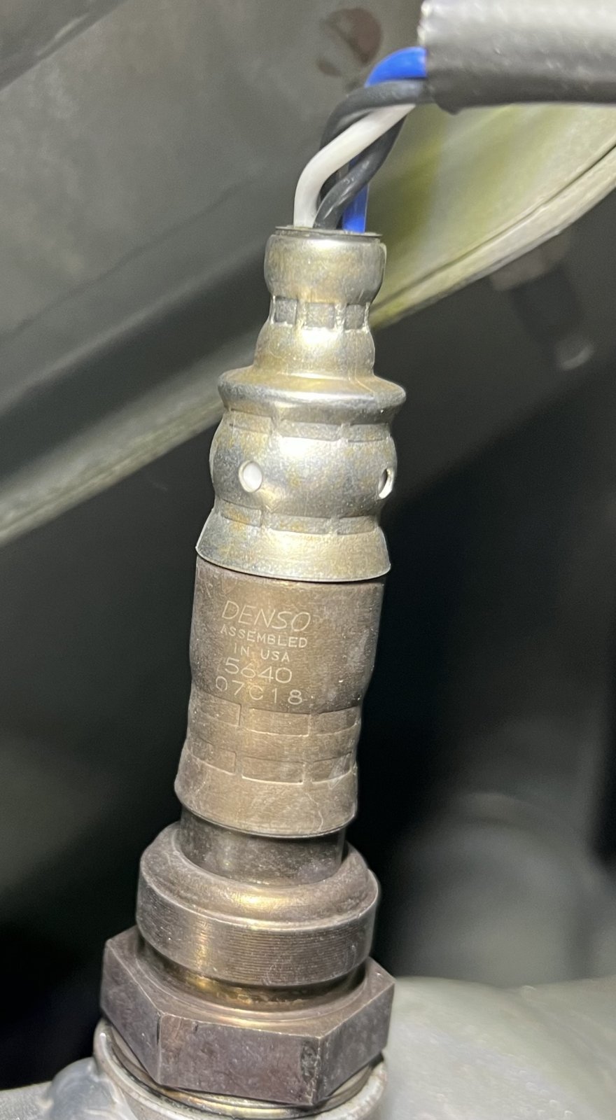

Looked at my O2 sensors yesterday.
This is one of the 234-4668 sensors I ordered in 2020 for the front/upstream. I did crack it loose and turn it to see if there were any other numbers:

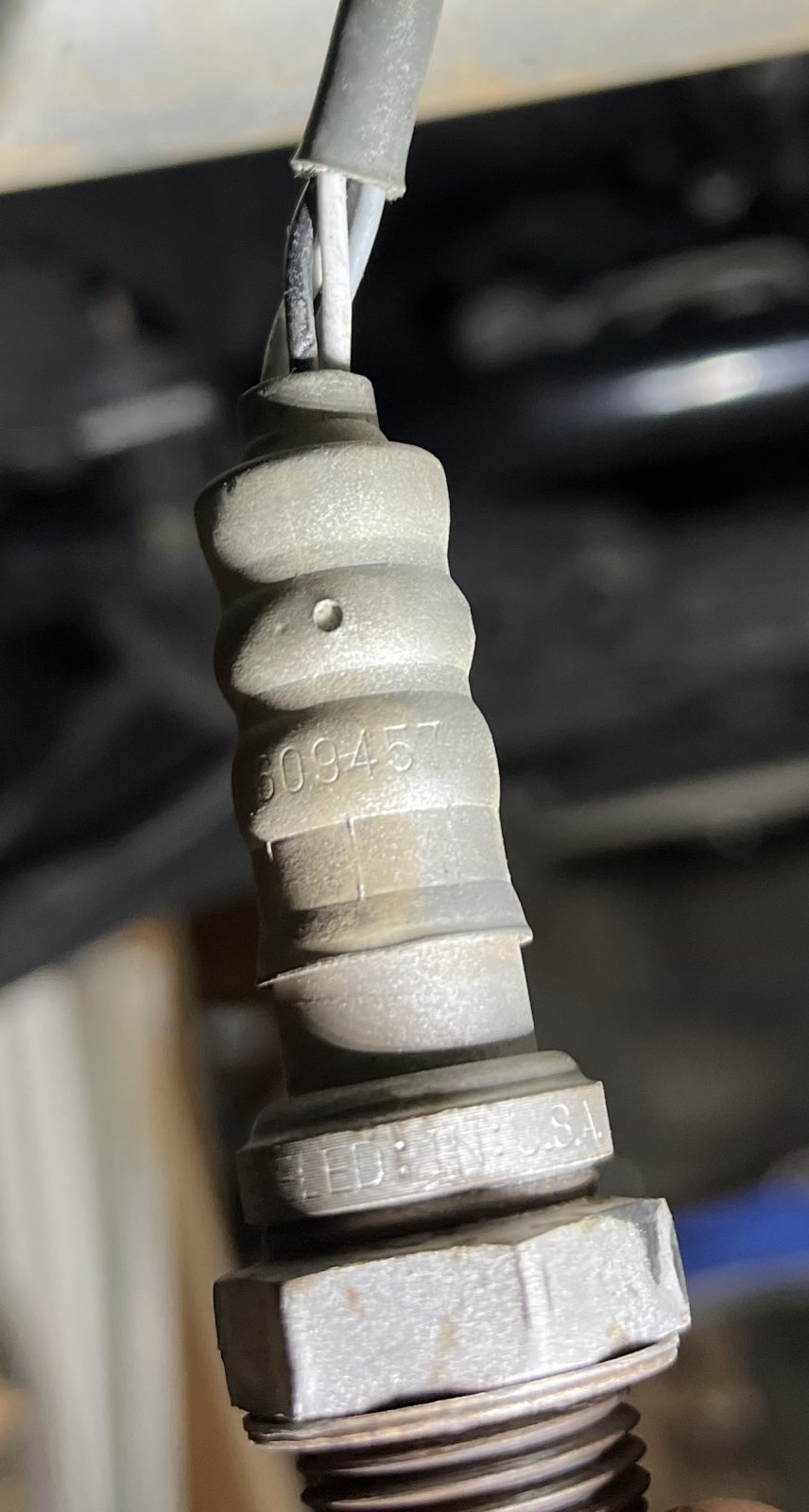

...And the rear/downstream. Probably original. I'm just using these as hole plugs since I have them deleted from the tune:
Interesting that it says "ACDelco" on it. A really brief search to see what the part number "12609457" cross-references to for Denso shows 234-4256.

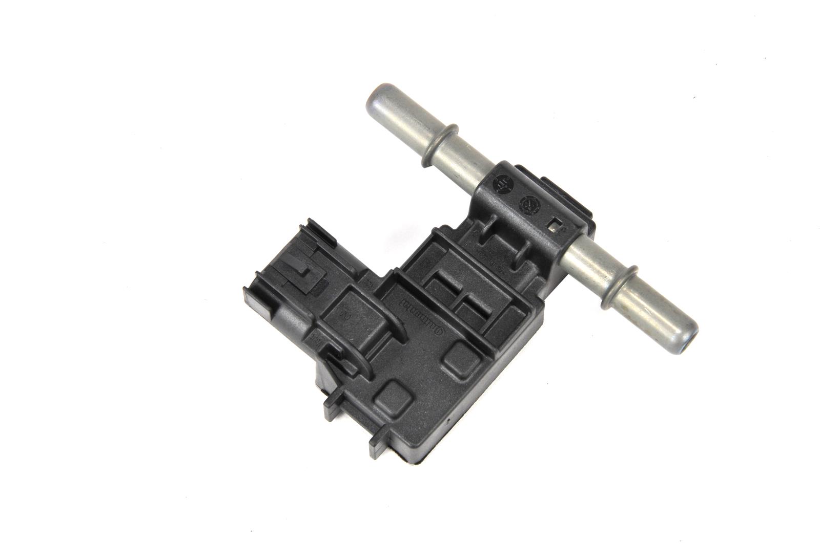

Slipped my light and phone up above the tank to see what the fuel supply QD situation looked like:
The alcohol sensor looks like this:
To not make any permanent modifications to the fuel system in case I need to revert, I'm thinking of making two adapter hoses out of Nylon or PTFE (whatever the factory "plastic" fuel line is made of). One will have a female QD on each end and the other will have a female QD and male QD. I'll mount the sensor in a reasonably accessible but safe location as close as possible to the "splice". The hoses will be in a loop formation with the sensor in the middle. Pretty much the exact idea that the kits use with the AN fittings locating the whole shebang alongside the left bank fuel rail. Or, if it'll be easier and just as clean, I might put the sensor near the firewall, splicing into the rail inlet. The wiring would be way easier and shorter with this option. I'll have to go pop the hood and stare for a while.
