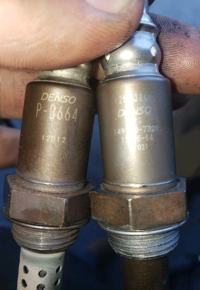

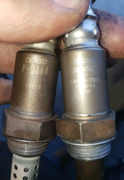

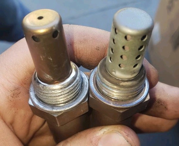

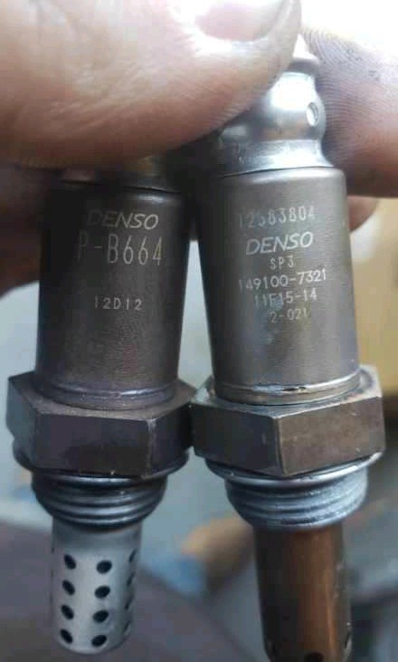

Swapped upstream O2 sensors today. Out, with the Denso P-B664, and in with the GM/Denso 213-3866/ 12583804. Been having issues with ethanol percentage being calculated to high for a while. Started with replacing O2 sensors a while back to no avail. Replaced fuel pump to see if that would help, and as preventative maintenance, no change. Changed MAP sensor and MAF sensor, no change. I also keep getting a P1174 code almost every time I drive it. Checked and re- torqued the intake manifold bolts, a couple on the driver side were slightly loose, maybe a 1/2 - 3/4 turn. All for nought.
All this talk about O2 sensors prompted me to swap to the "factory original" O2 sensors.
I did notice they are definitely different when I had them out as seen in these pics. OG style has less holes around the side and one hole in the end.
Just figured I would add to the confusion, I mean discussion... lol
I will post later on if this has corrected the issue with the P1174 and the ethanol composition issues. So far no check engine light after driving 75 miles back from my brothers house.
Great timing and looking forward to your alc % results! How are you testing it- test tube with water method? I've never heard of the Denso P-B664 in all of this.
