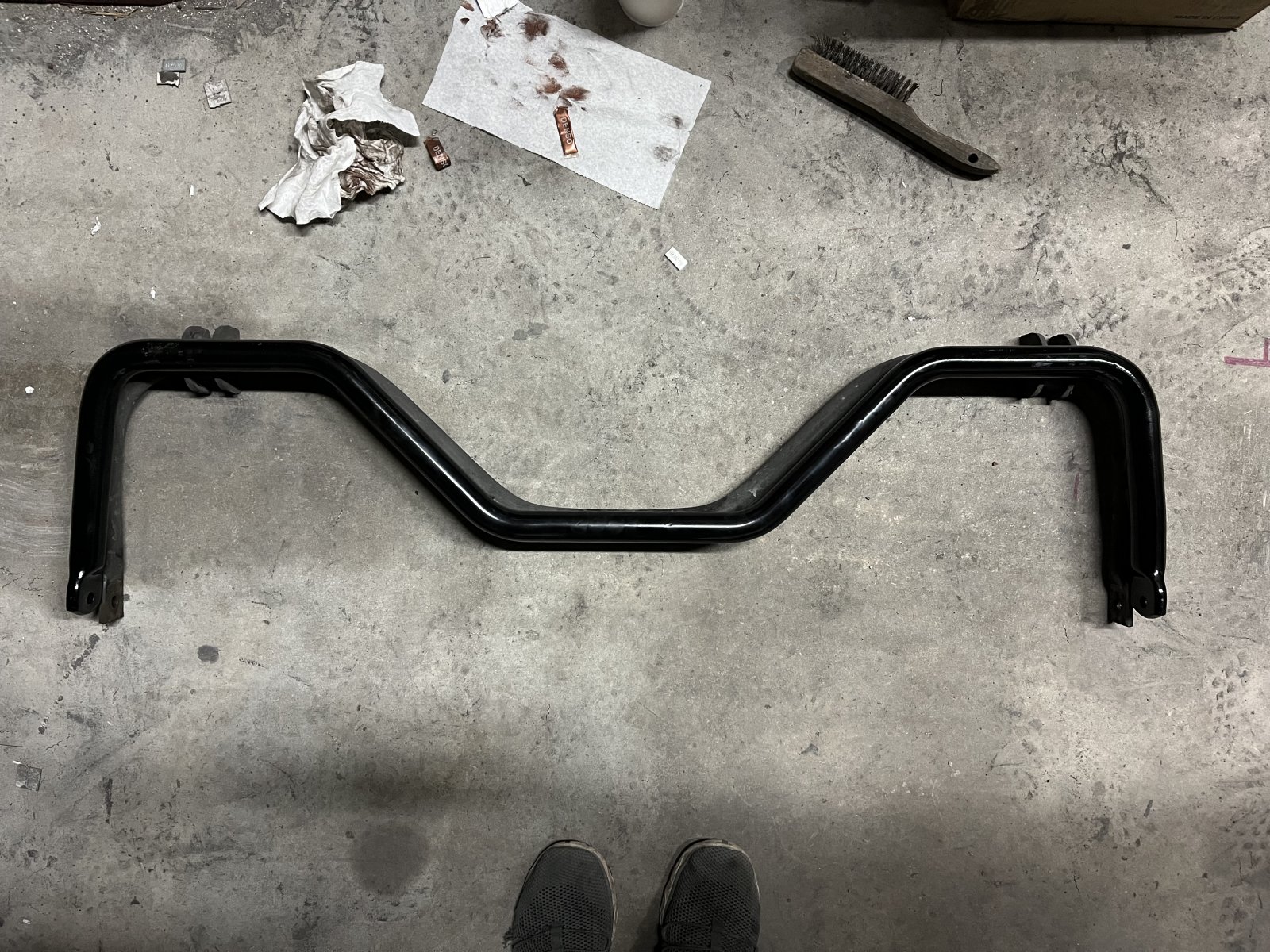

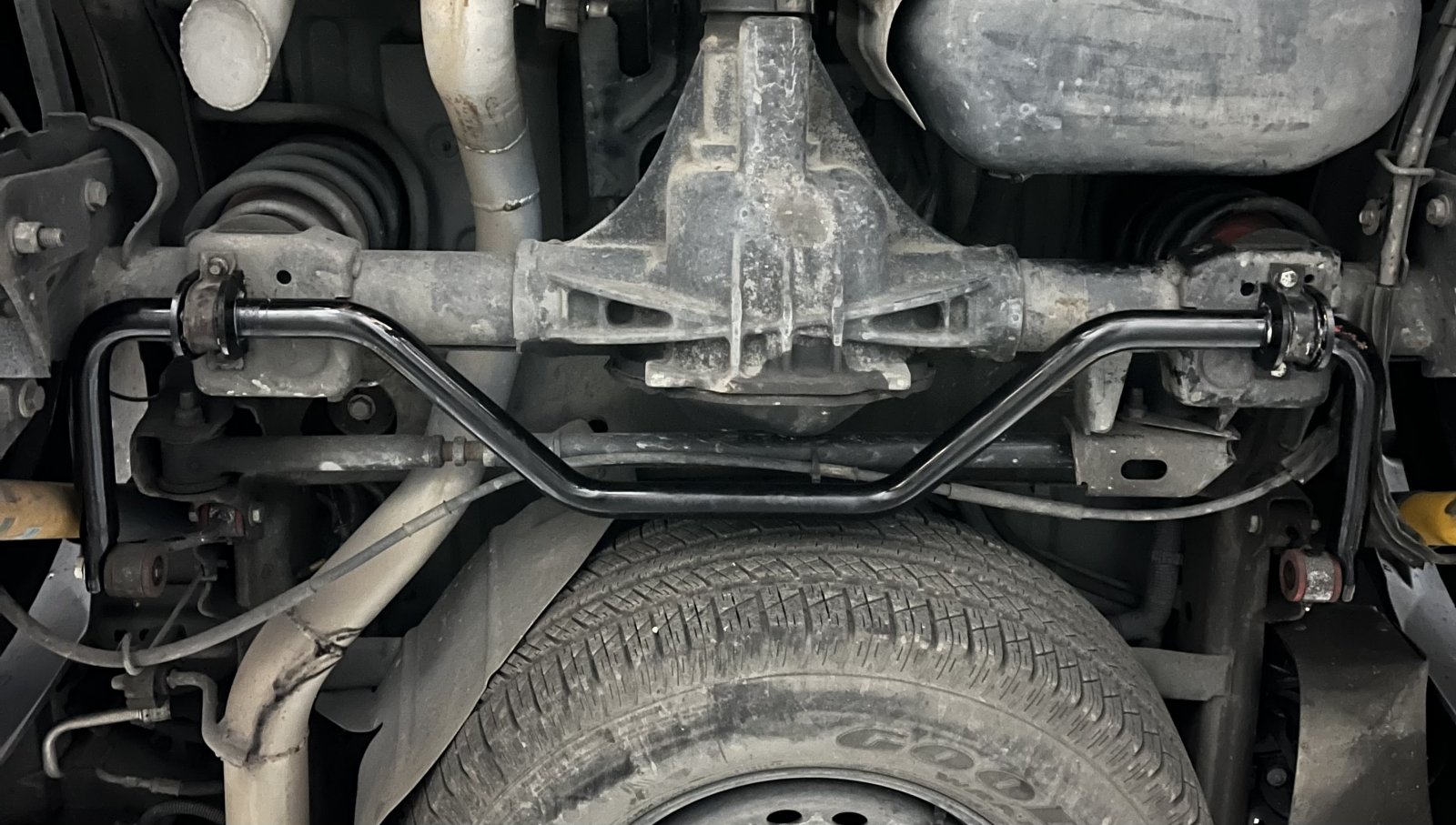

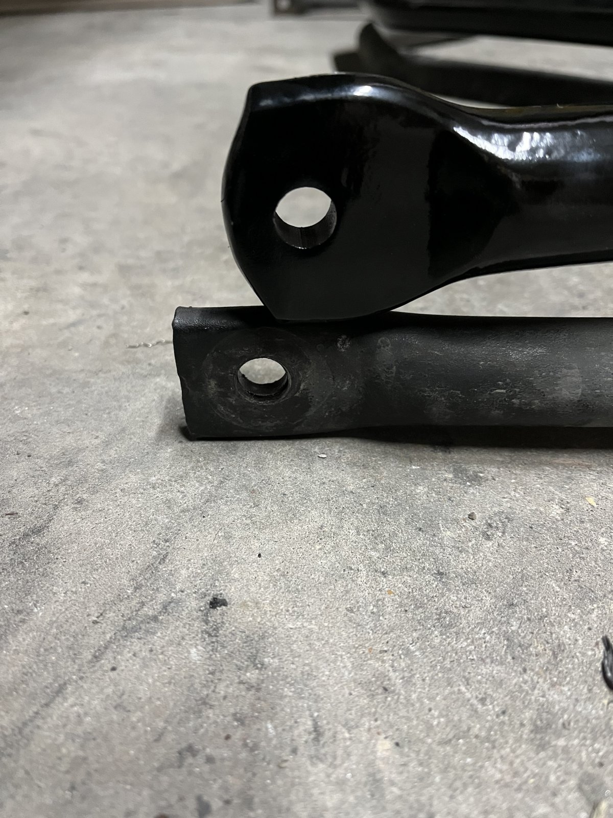

Comparing rear bars-
Mostly same shape with slightly more clearance where it matters:
Factory bar is 28mm, hollow and 9.8 lbs.
Nolathane bar is 33mm, solid and 24.2 lbs.
End link holes are right at 1/2" closer to the axle. I had the bars centered with each other at the axle mounting points. Also, the holes were more true to size- the 1/2" bolts had noticeably less slack than in the factory bar:
The Nolathane axle mount bushings have thicker bases, so bolting up that offset axle bushing was a struggle. I couldn't finish because I need longer bolts for the end links. With the original bar, the bolts would be flush with the nuts when tightened. I'd be lucky to get half a nut threaded with how thick the ends of the new bar are:

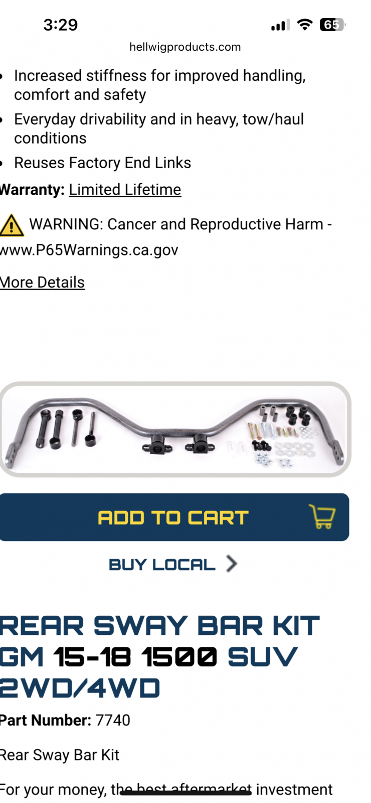

I have to wonder what the difference between this sway bar and the hellwig bar is.
the hellwig says it fits 2015+ but the brand your using says it doesn’t. They look damn near the same but obviously I’m not comparing them in person
Edit
Actually if I just did a minute of research I wouldn’t have to ask this.
Rockauto list the same part number for rear sway bar on 2008 as it does for 2015. So assuming they’re the same shape still confused why the websites fitment says it won’t fit 2015
Even if i go to nolathanes website. They only offer the front sway bar when I input 2015 Yukon

A lot of manufacturers and retail sites don't bother updating fitment info beyond a certain age. The body style changed for 2015, so they might assume the undercarriage might have changes as well. It's why a lot of sites say a drop spring fits '00-'14 when, in actuality, it'll fit up to '20. It's probably more of a CYA thing. They're not necessarily saying it won't fit or work, but they can't guarantee that it will and it's not worth their time to investigate. But, for an individual's firsthand experience in seeing this particular area is the same across the generations, we'd know better. How often do you see Amazon's fitment guide saying "This does not fit 2015 GMC Yukon" for items many other people have bought specifically for this vehicle?
Size- and material-wise, the Nolathane appears to be functianally the same as Hellwig with the exception of the color and rear bar. The Hellwig rear bar has three holes to adjust firmness and includes adjustable end links. The Nolathane bar is advertised as being 1mm thicker, which I'd say is totally negligible. Being lowered and needing offset links, the adjustable Hellwig links would be a waste for me. For suiting me better and costing a few hundred less, I'm plenty satisfied with the Nolathane.
I bought them as a front and rear kit off Amazon, Nolathane part #REV013.0030. I documented each bar's part number here: https://www.tahoeyukonforum.com/threads/growing-up-doesnt-have-to-suck.93510/post-1735470. If all you want is the rear, you might be able to find it by that number. Or just do yourself a favor and upgrade both. :thumbsup: There's still one kit left on Amazon cuz @pwtr02ss hasn't bought it yet. https://www.amazon.com/Nolathane-REV013-0030-Swaybar-Suspension-Stabilizer/dp/B07VFD1QDM

I only questioned the rear because it didn’t show fitment. But the front says it’ll fit. I’m considering them since I also don’t want to spend hellwig money

That's kinda odd. I looked up images of the rear suspension of a 2015 and it looked essentially identical. AFAIK, it'll work fine.
