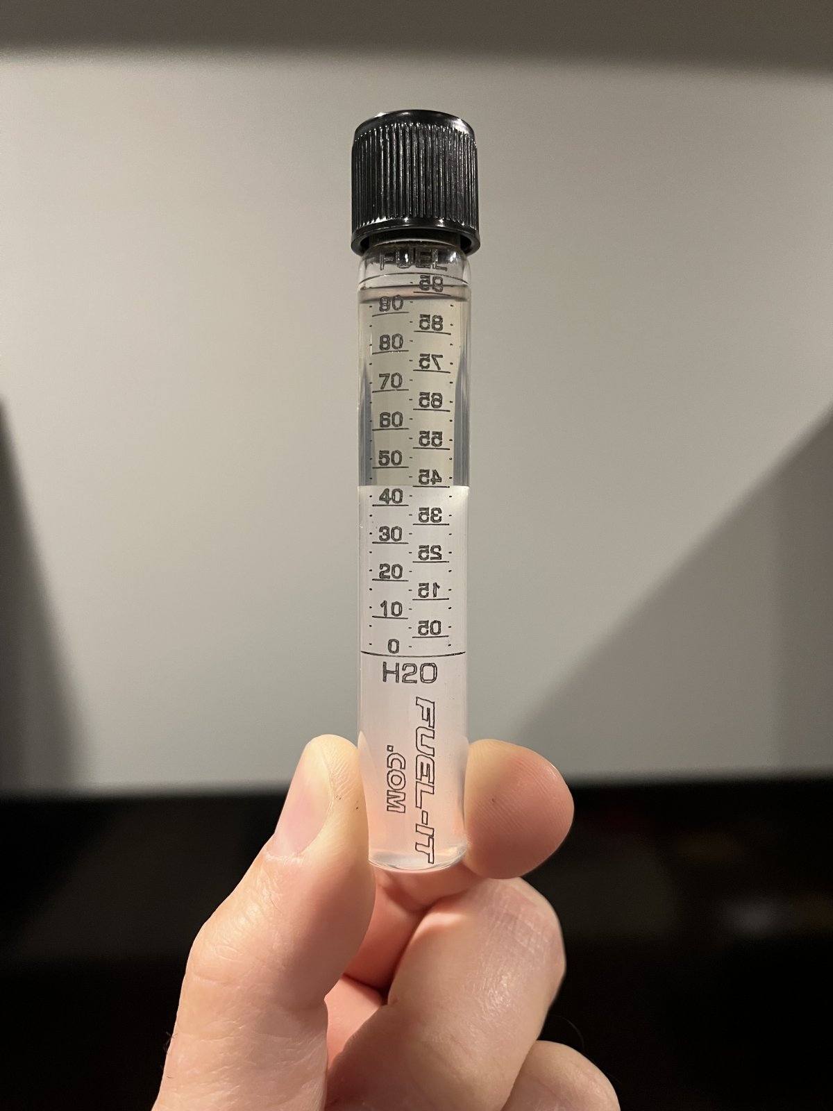

Last Friday, I was on my work phone walking another tech through some stuff so I was in work mode. I stopped for gas and accidentally put 9.3 gallons of 87 in my Tahoe before I realized what I had done. I drove it home gently. Took it Saturday morning to a RaceTrac about 22 miles away cuz that's my nearest E-85 station. I've been wanting to try a tank of E-85 since replacing the O2 sensors a couple years ago, anyway. I brought my laptop to scan for knock to see just how bad it was. Maybe the 45° IATs helped, but I could drive pretty normally and it was fine. But, as soon as I got a little frisky with the throttle- 4° of KR.
I got 16.75 gallons ($2.38/gal for those counting) of the corn oil and continued down the highway to get some miles on it to see what the virtual sensor would settle at. I've only tried E-85 once before, a couple of years ago. The highest it calculated back then was around 22% with an actual measured content of 65%. I've done the engine work and replaced the O2 sensors since then. Today, the highest I saw was in the 50s percentiles. After about 11 miles, it seemed to have settled at 40.8. The E-85 made a huge difference. I got a little more aggressive leaving each traffic light while watching for KR and there was none. I pulled in to Walmart and, while stopped at the far end of the lot, stomped it and saw 2°. I went in the store for a few things and grabbed a couple bottles of Lucas Octane Booster as well. Once home, I took a sample at the fuel rail to see what the actual net alcohol content is, then poured in the two bottles of booster.
The fuel in the test vial settled to 45%:
I'm feeling a lot better about mine accurately calculating the alcohol content. But, I still want a physical sensor.
I've been racking my pea-brain trying to figure out what that E45 blend yields in octane. The interwebz say that E85 is around 108 octane. I guess I need to know how many gallons I have of whatever is now in the tank to calculate it. I just thought I could equate "If 85% alcohol equals 108 octane, then 45% alcohol would equal 52.9 octane." I know this isn't right. I'm not mathing today.

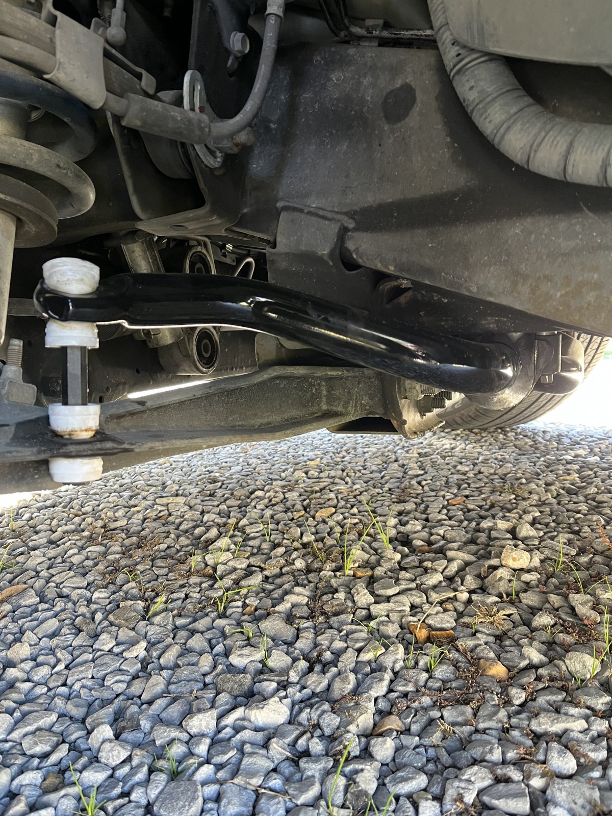

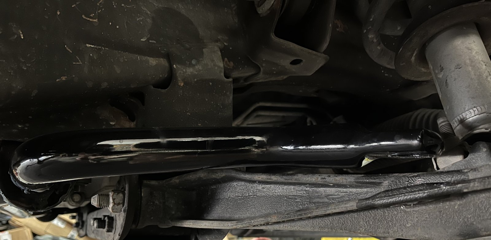

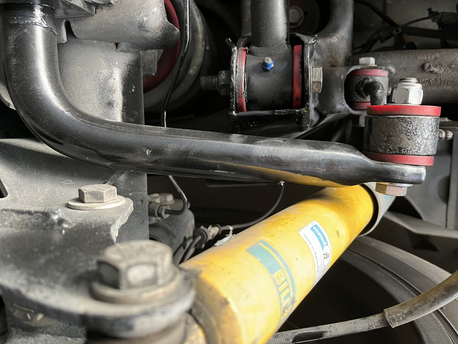

Was parked at a friend's house yesterday and had my wheels turned. I've decided that I don't like the angle of my front sway bar. My end links, while shorter than stock, are still way too long:
These links and bushings were new when I installed these bars about 1.5 weeks ago. Side view showing angle of bar:
Roughly eyeballing it looks like I could chop that center hex stock spacer to put the two bushings it separates touching back-to-back and the bar would be about right. Or, remove those two bushings altogether and use a single thick bushing between the bar end and control arm. I'd have to see how much misalignment actually takes place during the range of motion. There's not much uptravel cuz the tire is stopped by the inner fender. Down travel is probably my bigger concern and that might not be an issue, either.
Those upper link bushings are definitely hurting with that angle. I would imagine somebody out there makes custom or adjustable links.
have you tried mounting it the other way around? swap left and right sides
45,013
I haven't. But I stared at those pics for about five minutes then held my laptop upside-down to help with a visual, because I eat crayons. It would help with the height, but not the front-to-back slope of the flattened end. The bar needs to be as parallel as possible to the ground and it looks like shorter links are all that's really needed. My only concern is if the holes will be aligned with it that close. Worst case, I move the sway bar back on the frame a little, drill some holes and through-bolt it. All in all, a relatively easy fix. I bet the bar will be even more effective once it's properly aligned.

I haven't. But I stared at those pics for about five minutes then held my laptop upside-down to help with a visual, because I eat crayons. It would help with the height, but not the front-to-back slope of the flattened end. The bar needs to be as parallel as possible to the ground and it looks like shorter links are all that's really needed. My only concern is if the holes will be aligned with it that close. Worst cast, I move the sway bar back on the frame a little, drill some holes and through-bolt it. All in all, a relatively easy fix. I bet the bar will be even more effective once it's properly aligned.
yea i dont think the length is going to be any different but i think the mount of the bar will sit more parallel to the LCA. mine would do the same thing lowered, lifted i flipped it over from where i had it when lowered.
is your drop all spring/shock? no spindles?
45,013
1.75" spindles and 1.75" struts (lowered spring perch).
I can hold my original bar up into position, but flipped, to get an idea. It'd be MUCH lighter holding that in place for mock-up.

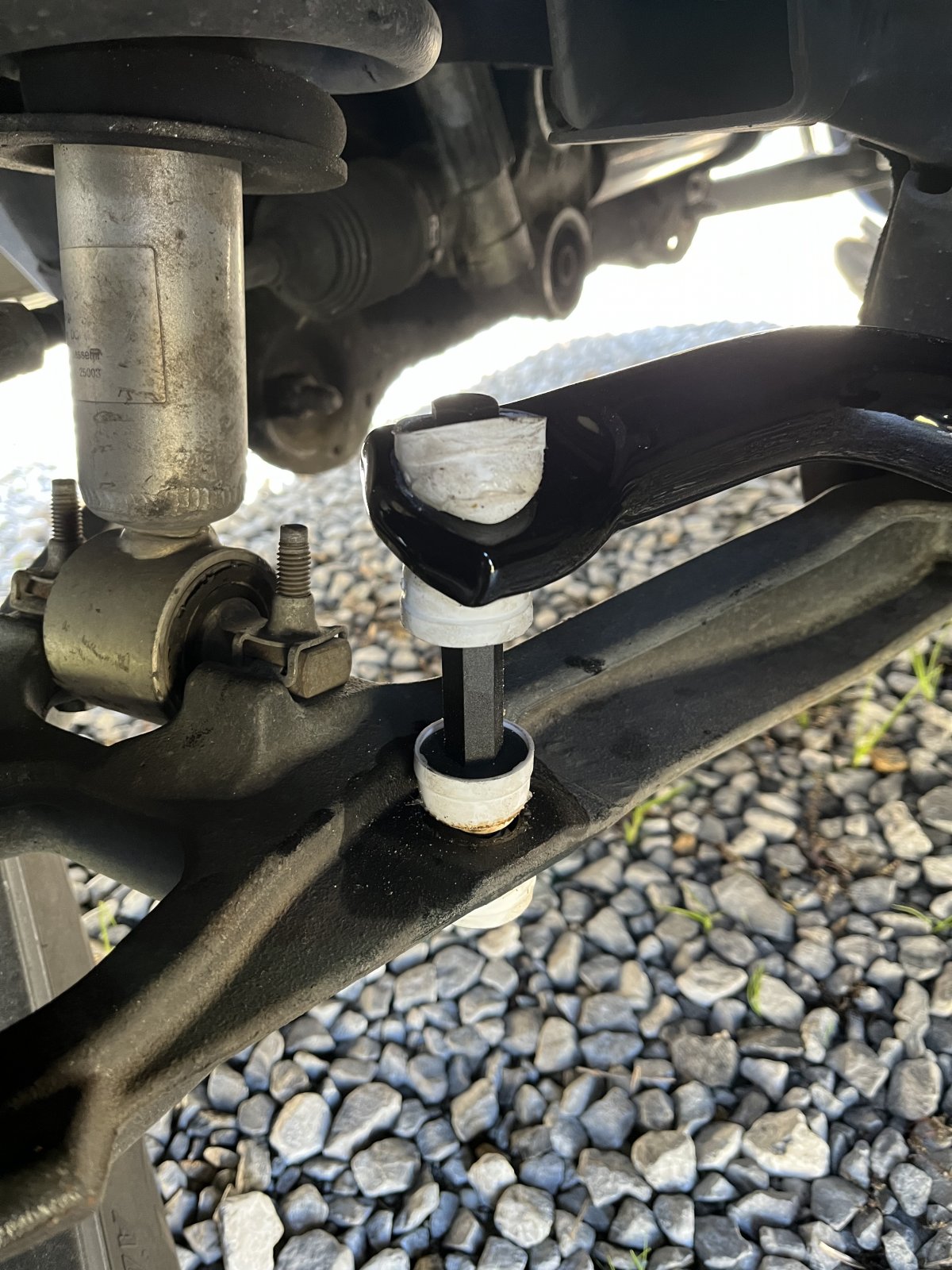

Here's the scoop. I removed the wheels and set the lower ball joint studs on some blocks and the rear diff on a same-height block so that the Tahoe would be resting at its normal angle, with the weight on the suspension. I removed the end links to inspect the misalignment of the hole in the lower control arm to the eye in the sway bar. Here's what I have:

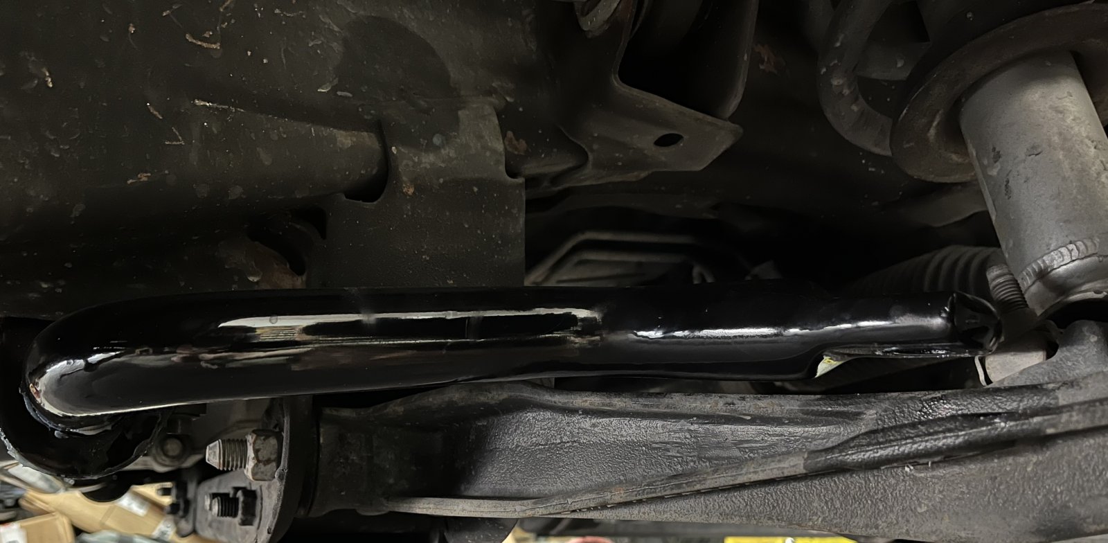

I rotated the bar as flat as reasonably possible-

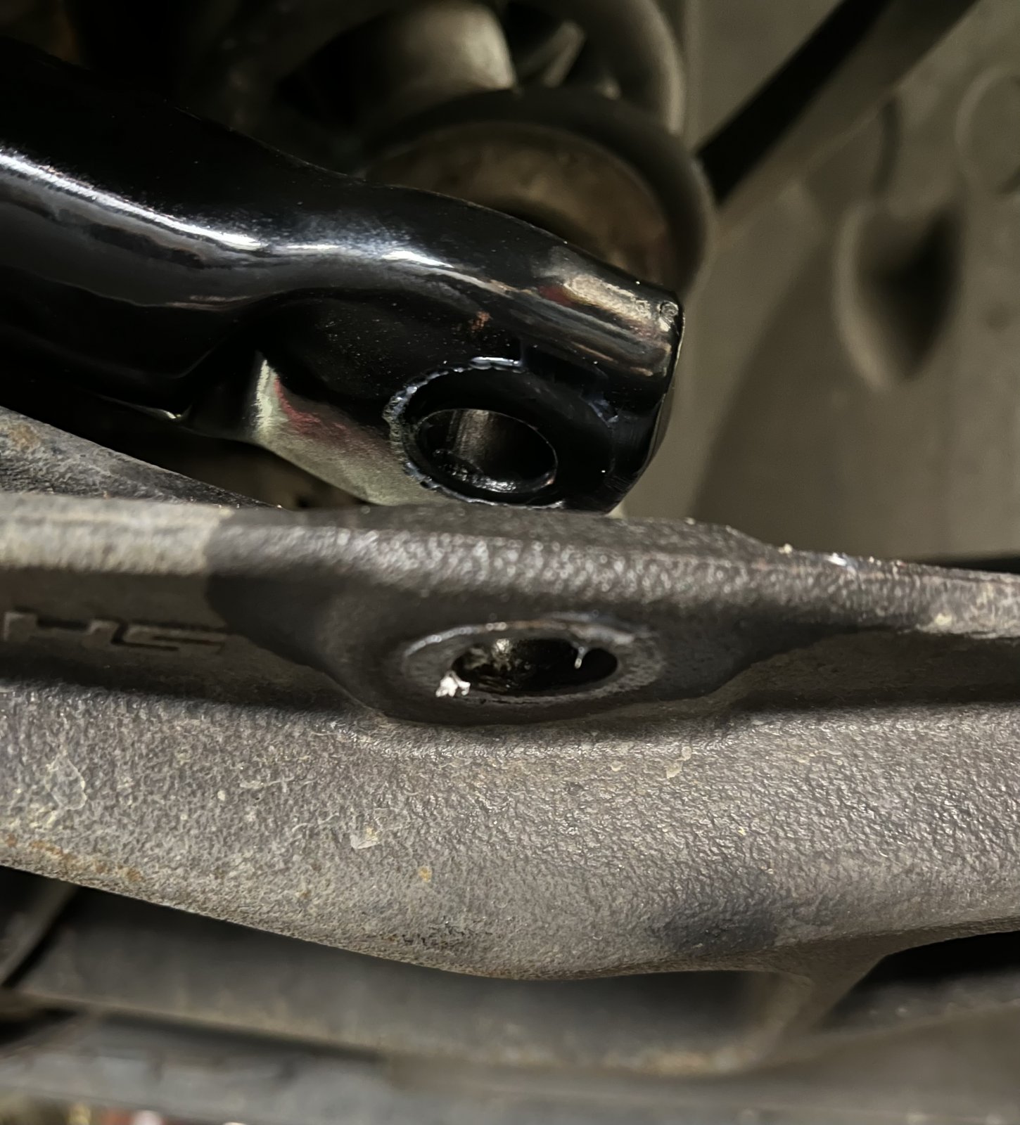

Eye is about 1/2" forward-

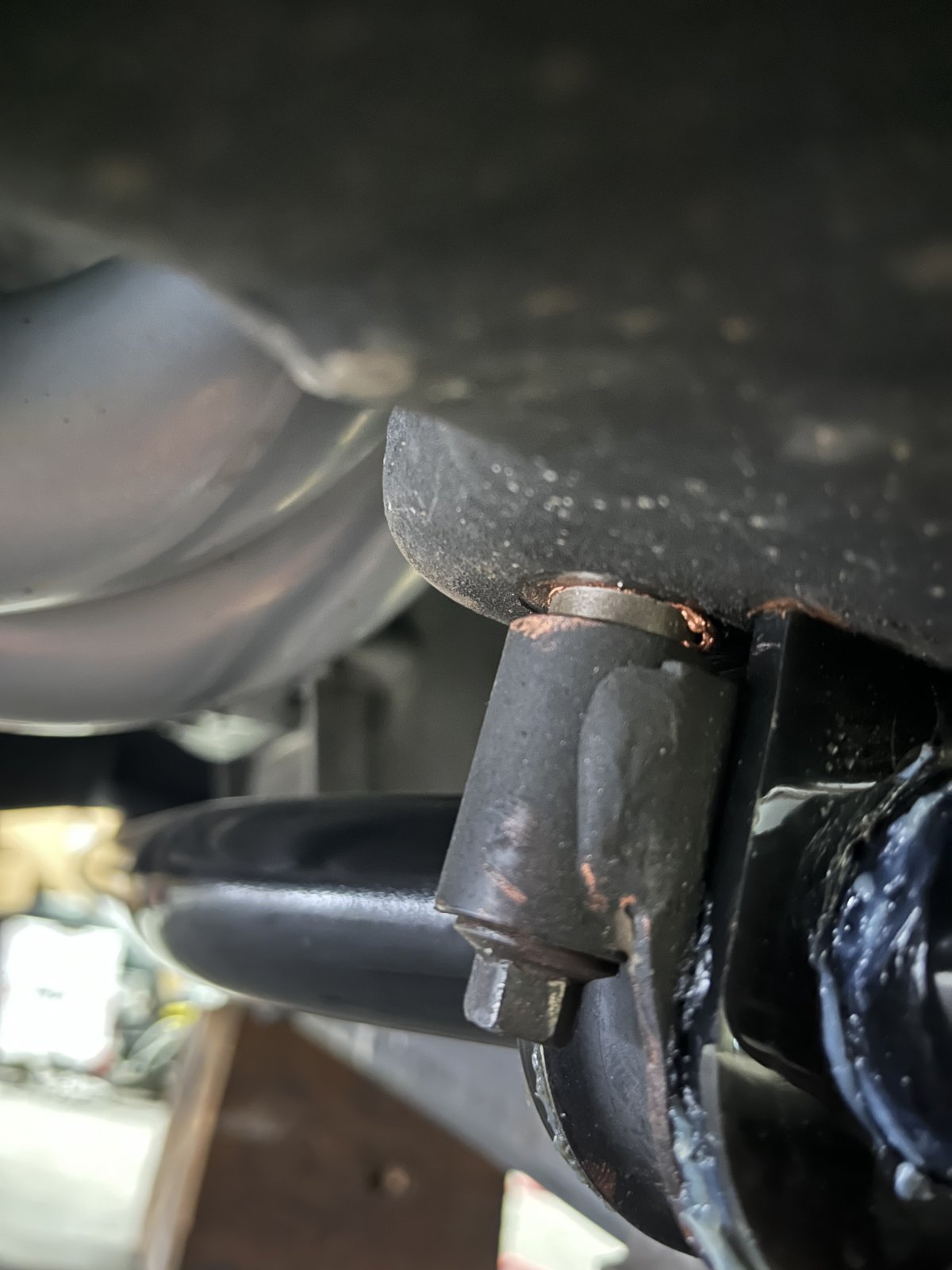

And maybe 1/4" inboard-
I'm not worried about that 1/4" inboard misalignment. But I have two options for fixing the bigger mess. OPTION 1: I could move the sway bar back, but I don't have much space in the bracket for the rearmost bolt. To get the absolute most gain, I'd drill a hole as far back as possible then shave one side of the head of a bolt down to the shank and drop it in from the top. The head being against the "wall" would keep it from turning and I'd use a nut on the bottom side. The frontward half would just be drilling a hole and bolting it. I'd use a flat plate for a shim instead of the ring currently in place, as seen in the pic-
OPTION 2: Make custom offset end links. This is really where I'm leaning. There's not enough space between the adjacent surfaces to use any kind of offset (Z-shaped) bar stock. Also, the angles of the two flat surfaces aren't parallel, as seen in the third pic. I'd need the two bushings between the bar and LCA to be as back-to-back as possible. Due to all the angles involved- the misalignment of the holes and the angles of the surfaces, I'm thinking of bolting the upper and lower bushings to each component with separate bolts. I'd put the head of the one going into the sway bar under it and the head of the one going into the LCA above it. Snug them up just as they fall out so the bushings aren't forced at any funky angles. Then, weld the heads together just as they meet. Even slicing half off each head to "Siamese" them together if that's necessary. Reinforce as feasible. This would simultaneously account for the hole misalignment and the angles. I'll look into using regular donut style poly bushings since they'd possibly be flatter than these thermoplastic ones, giving me a few millimeters more breathing room between the bushings.
I didn't have time to do any more than just assess and take pics. I might get back into it and decide to just slide the bar back and use regular, straight, but really short end links (Option 1). Either way, I wanna wait 'til I have time to actually do something about it and not just look at it.

Ugh. I don't like having to do a bunch of things just to find out I can't finish, then undo everything I just did to reschedule for another day. Such is life.
I'm not worried about that 1/4" inboard misalignment. But I have two options for fixing the bigger mess. OPTION 1: I could move the sway bar back, but I don't have much space in the bracket for the rearmost bolt. To get the absolute most gain, I'd drill a hole as far back as possible then shave one side of the head of a bolt down to the shank and drop it in from the top. The head being against the "wall" would keep it from turning and I'd use a nut on the bottom side. The the frontward half would just be drilling a hole and bolting it. I'd use a flat plate for a shim instead of the ring currently in place, as seen in the pic-
