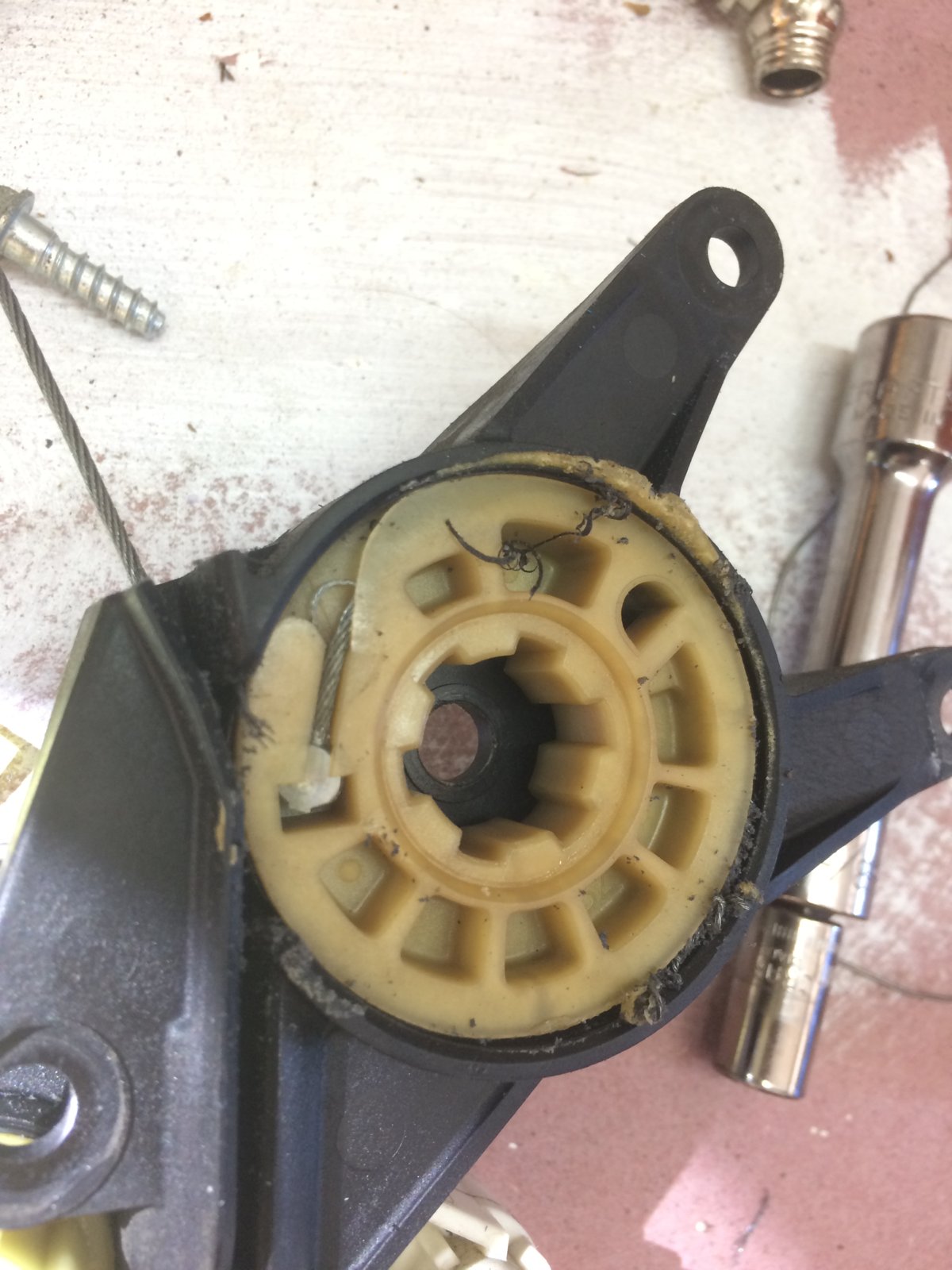

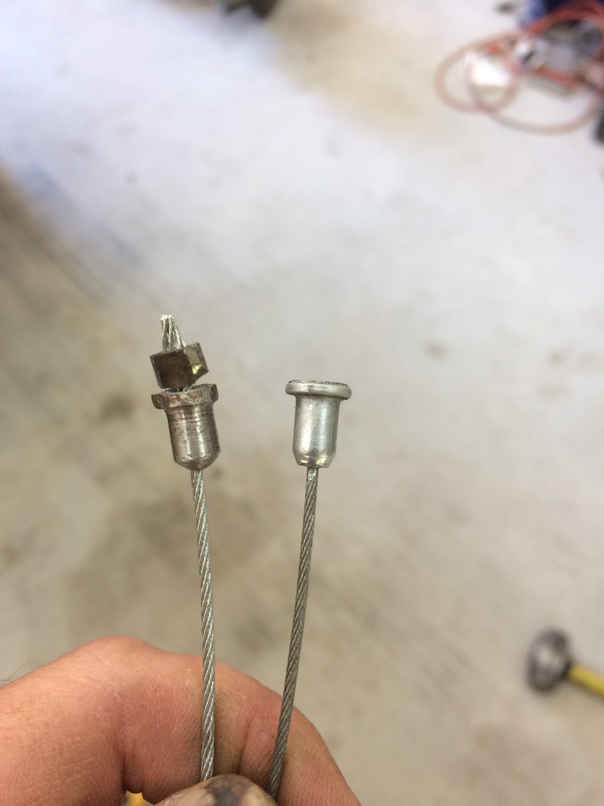

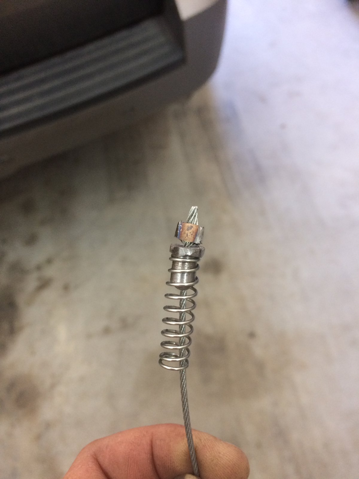

Pulled the regulator this morning to investigate. I used some suction cups on the glass along the outside window sweep to hold the window up while the regulator was out. Found a cable had frayed and wadded itself up on the drum inside the housing. Out of the three (I think that's how many I counted) cables, this one was the only one that didn't go in a nylon sheath. I decided I had nothing to lose by trying to fix it with what I had on hand. I had a roll of 1/16" galvanized cable, which is a little bigger than the original, but looked close enough to give it a shot:

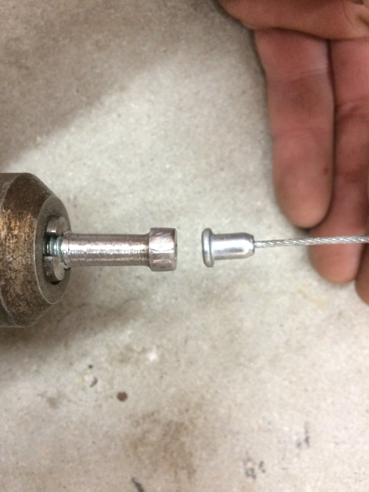

Drilled a 1/16" hole straight through a 5/16" bolt:

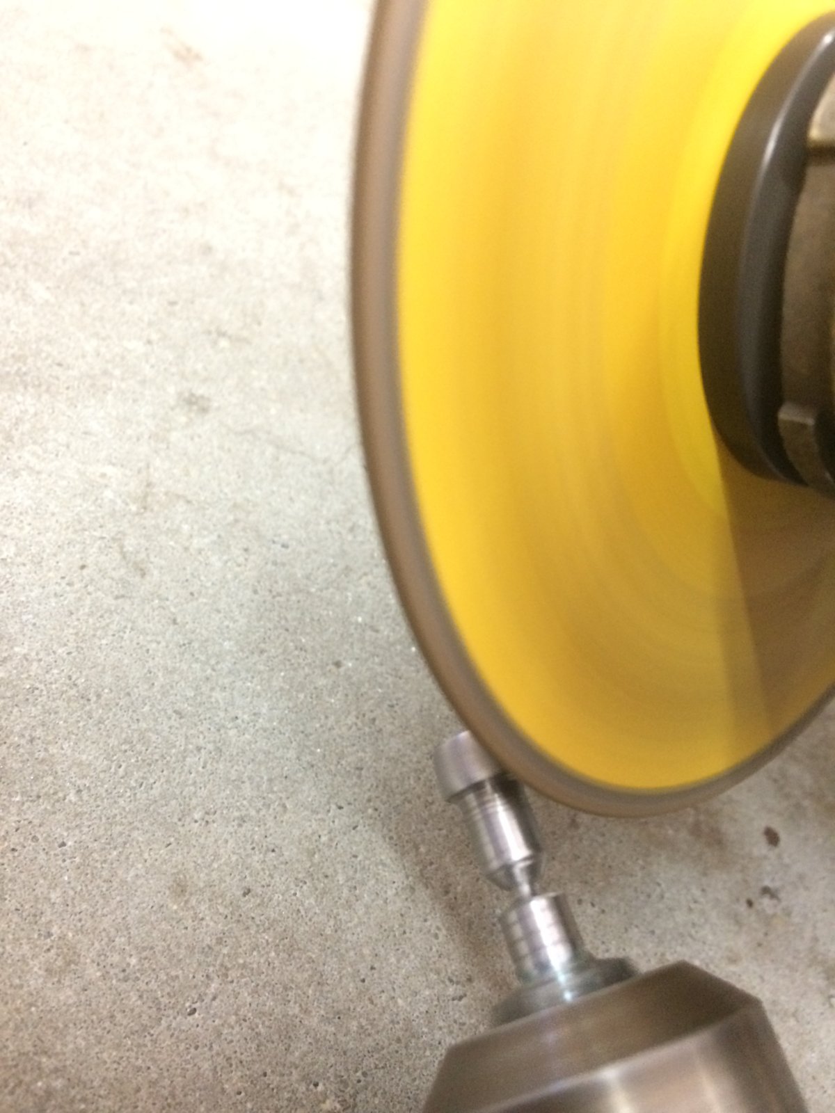

Then chucked it up in a drill to spin it while I turned it down with a grinder, checking it with a digital micrometer, until it matched the original cable bead/spring seat:
45,014

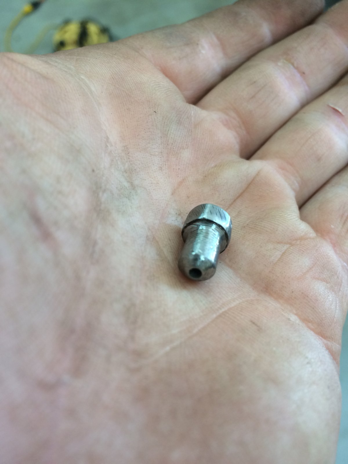

Getting there:
Closer yet... :
Good enough for me:
Used a chunk of steel with a 1/16" hole through it to act as a cable bead:
Spring fits like it should and the whole thing compresses inside a cylindrical hole:
Didn't take any more pics, but all that was left was to make a cable bead for the other end at the same distance as the original. I drilled a 1/16" hole in a piece of 1/4" thick aluminum flat stock, cut it out and ground it down to a size that would fit into the hole on the cable drum. After routing the cable around a pulley, wrapping it around the drum four times (I counted before I took the old one off) and locking the other end into the notch on the drum, I greased the hell out of inside of the housing and closed it back up. I reattached the motor drive to the guide to finish reassembly.
I liberally greased everything that moved or slid and tested it with a 12V power supply. It seemed to operate quietly and smoothly so I reinstalled the regulator and door panel. Everything else on the regulator looked to be in fine working order so I feel this will last for a while.

Nice skills!

Thank you! I just wish I had a lathe!

That's some great ingenuity. I remember once changing my ds window regulator and the cable came unwound. Took me over an hr to figure out how to get it back in there correctly--and get it to stay. Great job McGyver!

That’s definitely a macgyver right there! Fantastic work! Wish I had skills like that! Haha
45,014
Thanks guys. I just got back from running more errands and was trying to find reasons to put the window up and down!

Nice work!
Thank you!
I'd like to update that the driver's window is now working even better than it did right after I repaired and reassembled it. I'd say this is because the grease is now better distributed and coated on the tracks.
I have another small mod to do that involves removing the door panels, so I'm going to clean and lubricate the other three regulators as preventative maintenance.

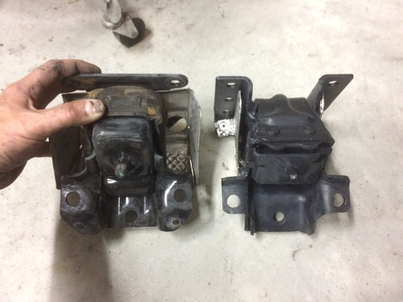

How come the H3 mounts are so much beefier looking?! I would think that a tahoe or burb being a bigger truck would already those beefier motor mounts given that’s a bigger truck with a bigger motor? Why does the H3 have bigger?
45,014
I think they're about the same size, just the shape and design is much different. The stock mount is hydraulic, meaning it's basically a thick rubber bladder filled with fluid to absorb vibrations. It's a weak design, though. The H3 mount is more of a traditional design with solid rubber encapsulated by a metal shell.
PG01
Nov 6, 2016
15,886
21,729
Up here to the right
@Bigbeardenali1992 Chase, just want to make sure you know stock in @iamdub pic is on the left and new h3 is on the right.
