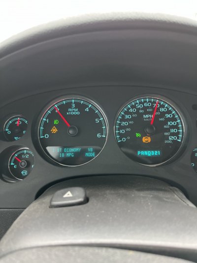

Left the house with the DIC displaying "27 MILES TO EMPTY" to go to the nearest source of E85- a RaceTrac 22 miles away. Grabbed $30 worth which was 11.721 gallons at 2.559/gallon. Went for a steady cruise in the opposite direction, away from town, to avoid traffic lights, etc. to let the fuel composition relearning get its stuff together as quickly and accurately as possible. I don't know if that's even necessary with the physical sensor. But, whatever. Made a U-turn and went home, totaling about 36 miles of mostly cruising after the refueling.
I noted an average of 18 MPG at 70 on my test course home:

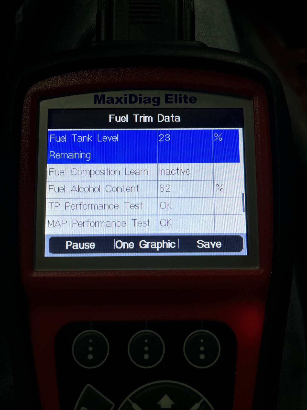

That's pretty good MPG if there's any decent amount of Ethanol in this load. I pulled into the shop and realized my RH headlight was out. Popped the hood to get a fuel sample and gave the headlight a slap and it lit up. Collected the sample and saw that the headlight didn't come on when I turned the key on. I removed the air filter box to replace the bulb. Just used a stock one from a spare headlight housing. Cleaned the air filter and reassembled it all. Threw the Autel on it to see what the PCM had the alcohol content at then closed up shop.
Alcohol content is showing 62%:

It takes almost 24 hours to finish separating in the tube. So, I checked it this evening:
The line is fuzzy. But, if it were the meniscus, it'd be just under 65%, like 62% to 63%. The sensor settled at 62% yesterday, so, I think it's doing great! It's only my second time testing it, but it was pretty much the same last time- within 2% of the water test. Due to the variables involved and the fact that it is consistent with reading that 2% differential, I'm gonna say it's pretty damned accurate. It's WAY better than the virtual sensor consistently calculating as much as ~30% low. Yeah, some new and different oxygen sensors might would've helped that. But, I did the physical sensor conversion for much less and I'm convinced my 23K-mile "wrong" O2 sensors are perfectly fine for their regular fueling duties.
Speaking of fueling, I'm gonna call this load E64. I was averaging 18 MPG on my test course yesterday. If E85 is 27% "weaker" than E0, then this E64 should only be 20% weaker than E0. Meaning, I should have a 20% drop in MPG from my norm with all other factors the same. My norm on E10 (I never bother with E0) is 22MPG at 70MPH. Drop that MPG by 20% and I'm at 17.6MPG. Considering that's actually E10 and not E0 I'm comparing to the E64, it's scaled down a tiny hair. So, it all checks out beautifully.
