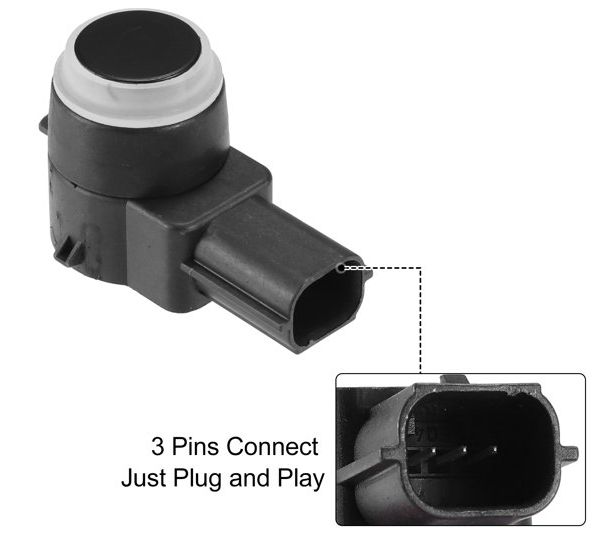

I wanted to ask if anybody has had to replace a ground wire (3 pin) switch that attaches to the trailer
harness. There are four, each equally spaced out on rear Tahoe plastic bumper cover. They look like
small round indentations.
The reason I'm asking is the wife backed into a retaining wall and dented in the bumper and broke
off the ground switch. The damage was not immediately apparent. Drove to church and somebody
spotted us and alerted us that we had no brake lights (left and right, middle window ok).
I have attempted to locate the switch with no success. Already checked at RA. My second option will
be my local Autozone and if not there then the Stealership.
Thanks in advance. Sorry can't load any photos at this time.

The way it's described it sounds like an object sensor (reverse parking sensor) mounted in the bumper cover -- not necessarily a switch. Unless you're talking about something else.

Sorry, forgot to mention it is a 2013 Tahoe, LT, 5.3 liter. Yeah, need to get some photos for you
all...my apologies. But, yes, that looks like the part. Just need to find out where to get it.

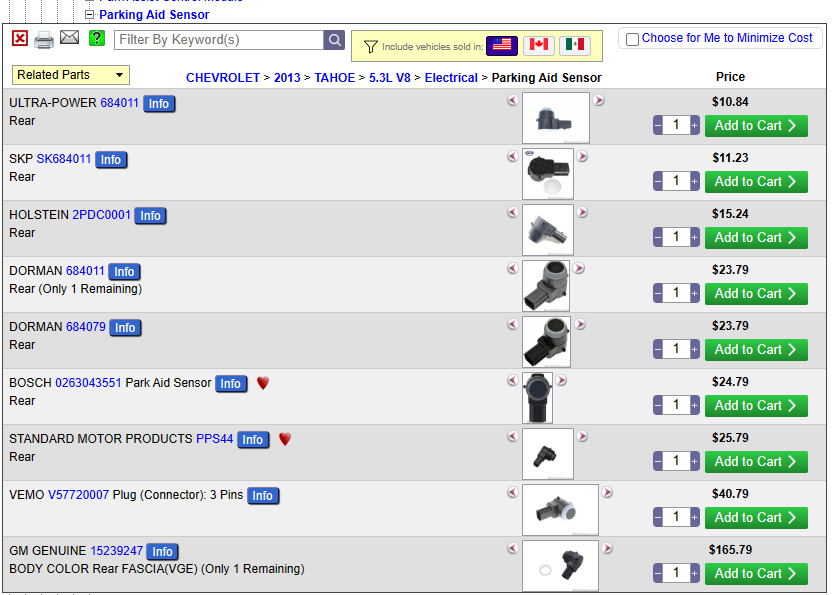

Rock Auto and typically any auto parts store has them or can get them.

Latest update: brake lights working after installing new bulbs. Oh yeah!
Got sensor a few days ago...ready to put on but waiting on Tahoe because

Well, another year and here is the latest on this thread. The sensor went in fine
and no codes or anything on dash. Thank you Lord this issue now fixed.
