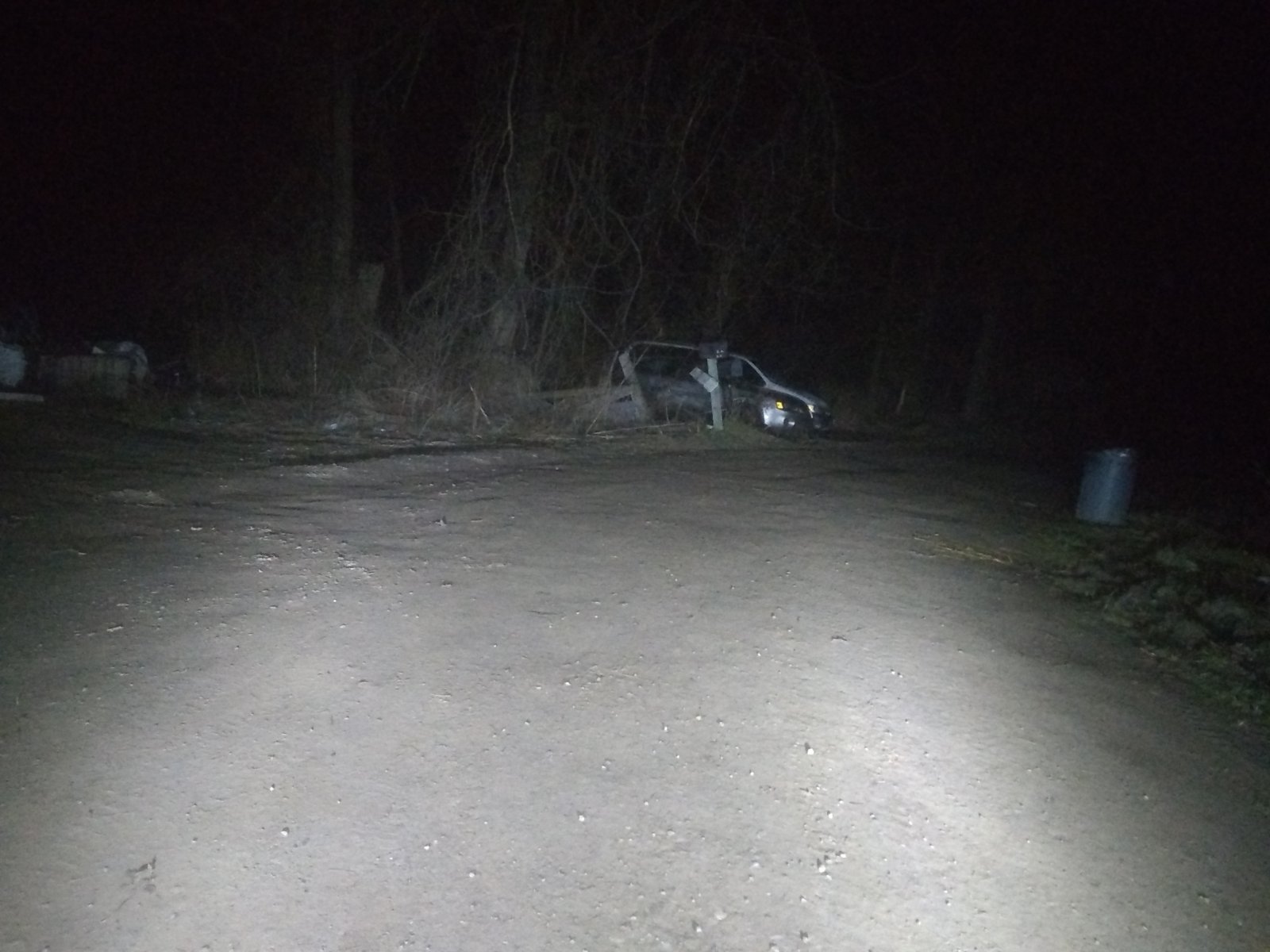

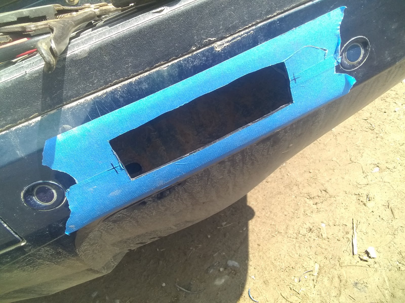

Put flush mount led lights in my rear bumper for reverse lights today. wired them into the reverse light wire and ground wire on wiring for the trailer plug. Getting screws on was only challenge not much room for my hands in there. Just used a razor knife to cut the bumper. Definitely can see to back up at night our driveway way is about 1200 feet long and half the time have to many vehicles in the way to turn around so I just back all the way out good reverse lights are important to me these should work good I can see almost halfway down the driveway and way out to the sides now. It curves by the mailbox there should have took pic aiming straight down the driveway. What have others done for reverse lights on there burbs or hoes?
