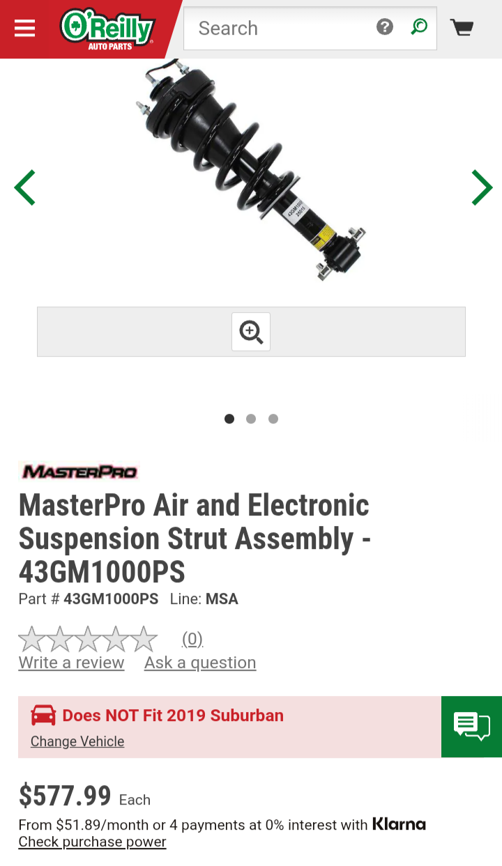

So here is a plot twist! I pulled measurements on the struts that came out of the truck. Went to oriellys and pulled measurements on a new 43gm1000ps strut. Exactly the same measurements. So I went to the local Chevy house. Pulled measurements on the 84977478 strut. It was 1/4” longer.
Old strut and the one that is in the car now, exactly the same measurements. Oriellys guy suggested that new one needs to be “relearned”. Thinks it’s an electrical issue.
Holy crap, they might be right.
I did watch a video on relearning the magnaride height. Sounds like a dealer operation. I would try calling the dealers around you to see who knows exactly what you're talking about, and take it there. Or do some more research on it first.
Compounding this issue is:
The O'Reily cross reference for the GM part number does not reference to the 43gm1000 for some reason. I think it should.

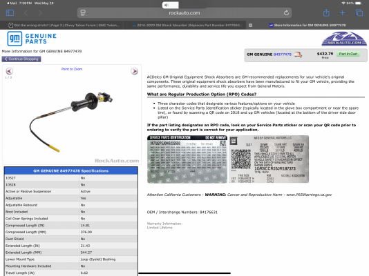

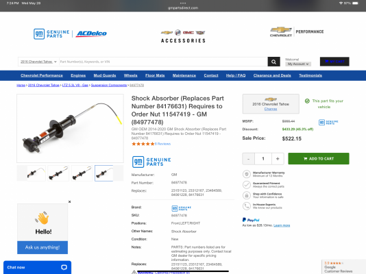

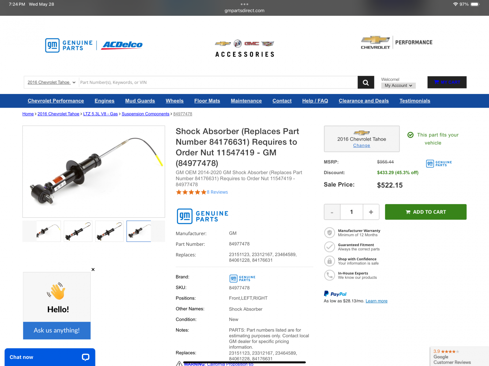

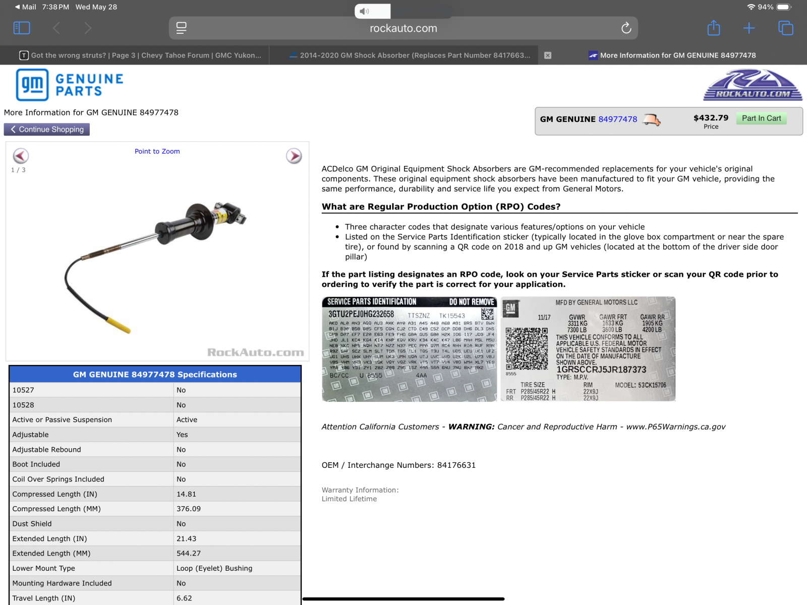

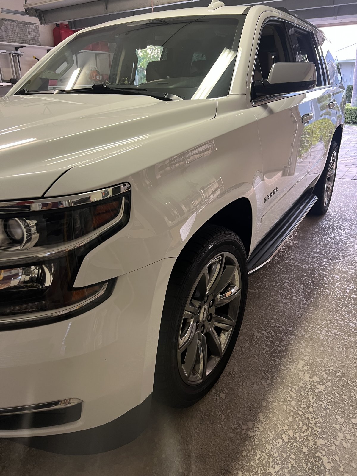

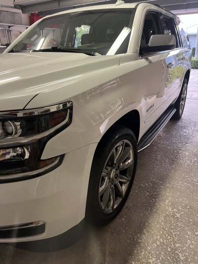

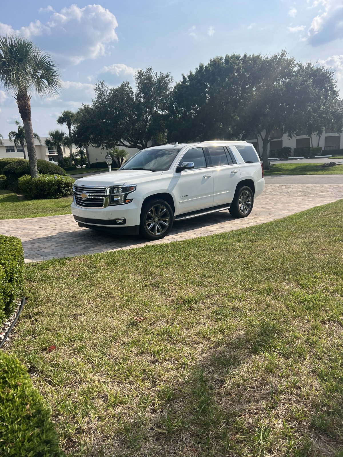

Have been lurking for a while decided to join today
I have a new to me 2016 Tahoe LTZ bought it in Florida no rust, it needs new magnetic ride shocks replaced. I plan on doing the job myself just have the springs swapped at a shop.
I have been doing quite a bit of research on the subject
The part number in question on Gm parts direct Gm# 84977478 LH/RH costs $522
On Rock auto the same part is $432
The original Gm shocks need you to remove original spring and reinstall on new shock,
They don’t sell Gm shocks with a new spring installed. Other manufacturers do though but from what I gather they don’t last very long
Welcome to the forum and thanks for chiming in! Nice Tahoe.
This is a good point, @weldernotmechanic, im betting the coils are a little thinner on your MSR unit.
