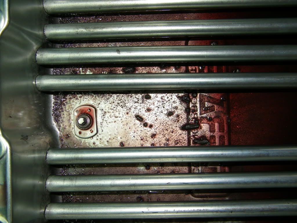

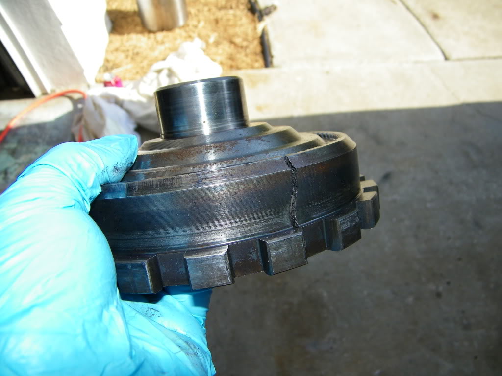

lol I am on my 3rd mega monster in my camaro. They are up the road a bit from me. Here is the plant from my mega monster. This is what they call a HD plant. looks stock to me. Did all this while actually cruissing at 45mph as it was going into lockup in 4th. I thought a bomb went off. I thought I lost my exhuast or a drive shaft or even rear end. just the trans again. They have been good about fixing it once it actually breaks but a pain in the ass non the less. This is just my experiance with them so far so it's not that this is the way all of them are going to be this is just one mans experiance. Blew the first one up on stock hp and street tires. had a bad sunshell. the second was on my 383 lt1 and street tires. I have never race that car. It has never been to the track.

^ Looks like "mega monster" needs to start doing something different.....
"Blew the first one up on stock hp and street tires"- this should not have really happend with a well built "HD"/"performance" transmission.
Im sure they are some what good at what they do.however,seems like something is out of whack.
This is why I think there is no such thing as a 'built' 4L60e especially if you were just cruising in a car that is roughly 2000 lbs lighter than these SUV's. Add the stress of any additional power, the extra driveline parts for 4wd guys, a lift, bigger tires, or do any towing and you're on borrowed time unless you babysit them.
