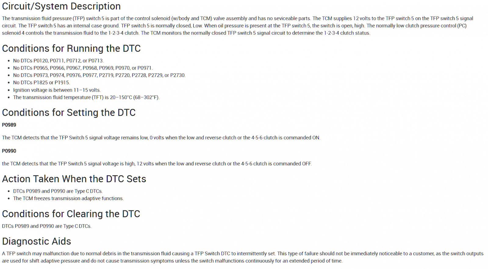

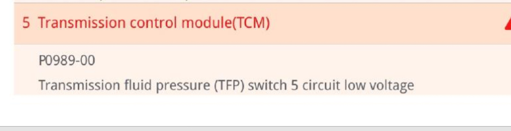

Any thoughts on a PO989-00 code? 2007 Yukon Denali 6.2 with 6 speed tranny. 160k miles. No noticeable performance issues at this time.

Oh nice, so if I’m reading this correctly, this is what it SHOULD be reading as when I’ve looked at it I’m in park. Or am I NOT reading this correctly and I have the beginnings of a problem?
I read it as you probably have dirty fluid and if it keeps happening you may need to overhaul the TECHM and or Valve Body. This can be done without removing the transmission from the vehicle.
Let's ask Nick, I just stayed at the Holiday Inn Express last night: @NickTransmissions

I kind of wondered about the transmission fluid quality myself. We had a full flush, drop the pan, change the filter in 2023, and the car only has 11,000 miles on it since then. It’s at the shop now to get the oil pan dropped and cleaned, the oil pick up tube O-ring replaced and the crankshaft sensor replaced. We’ve asked them to check the transmission fluid because of that code.

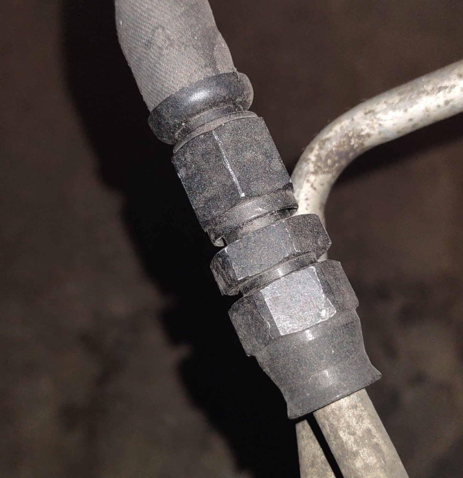

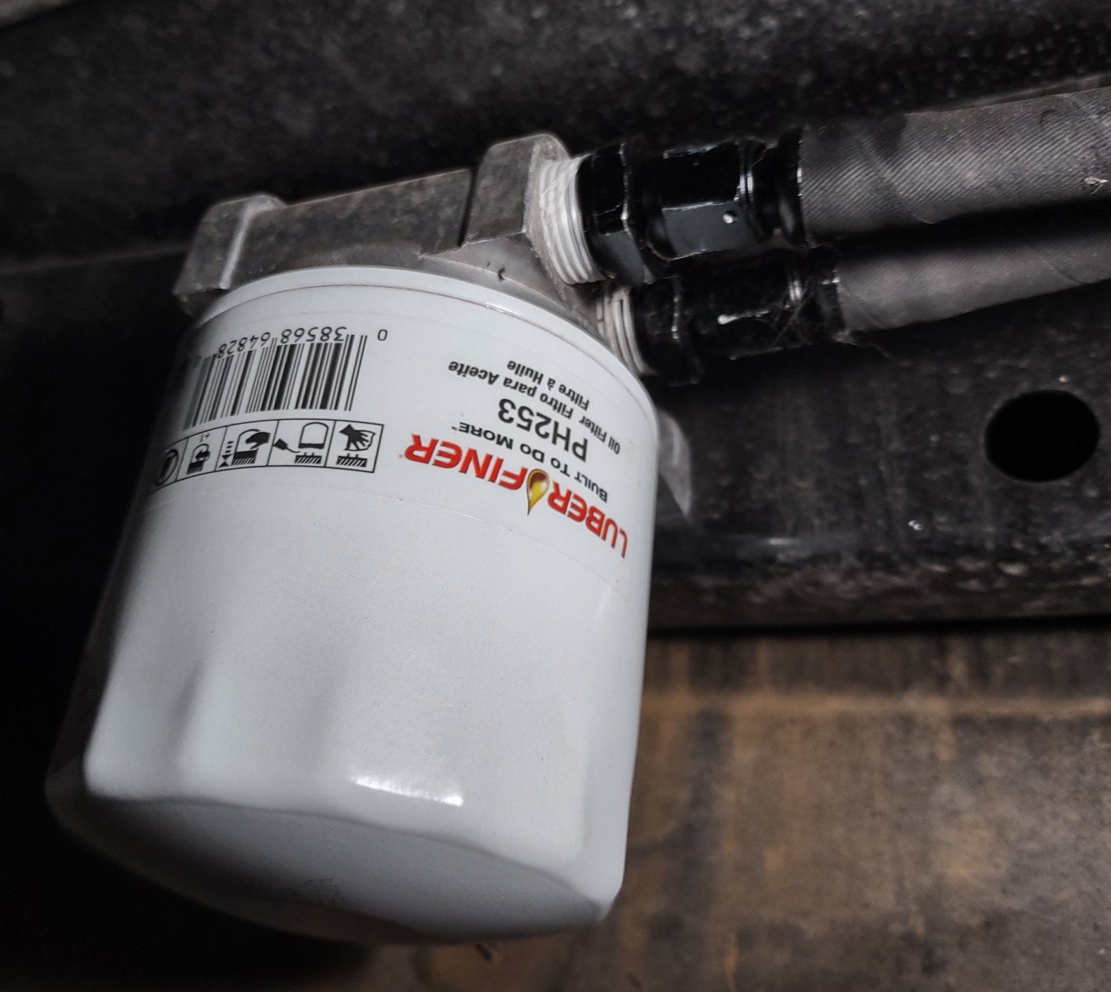

I converted my OEM rubber transmission cooler lines to AN6, using 3/8 compression fittings to adapt to the OEM pipes. Then an AN6 adapter to the radiator. (And an inline hydraulic filter on the return line)
Once a year, I disconnect the AN fitting on the return line, and connect a clear 6 foot hose to it, with an AN fitting ....start vehicle until I get 4 quarts out. Then add 4 qts. Repeat 4 times. Every other year I dropped the pan and replaced that filter, but it's always totally clean. Not even any dust at the bottom of the pan. That in line filter is doing wonders.
Almost 180,000 miles and the fluid has always looked excellent. With a complete fluid change every 12,000 miles roughly, hoping this transmission will outlive the entire vehicle....
View attachment 467560View attachment 467561
