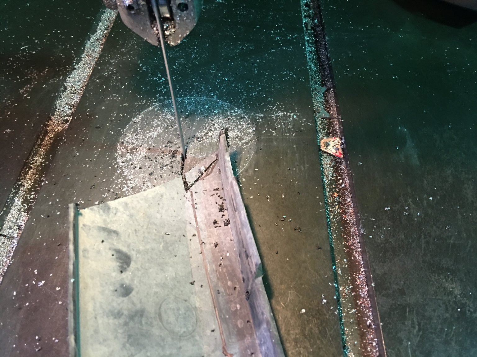

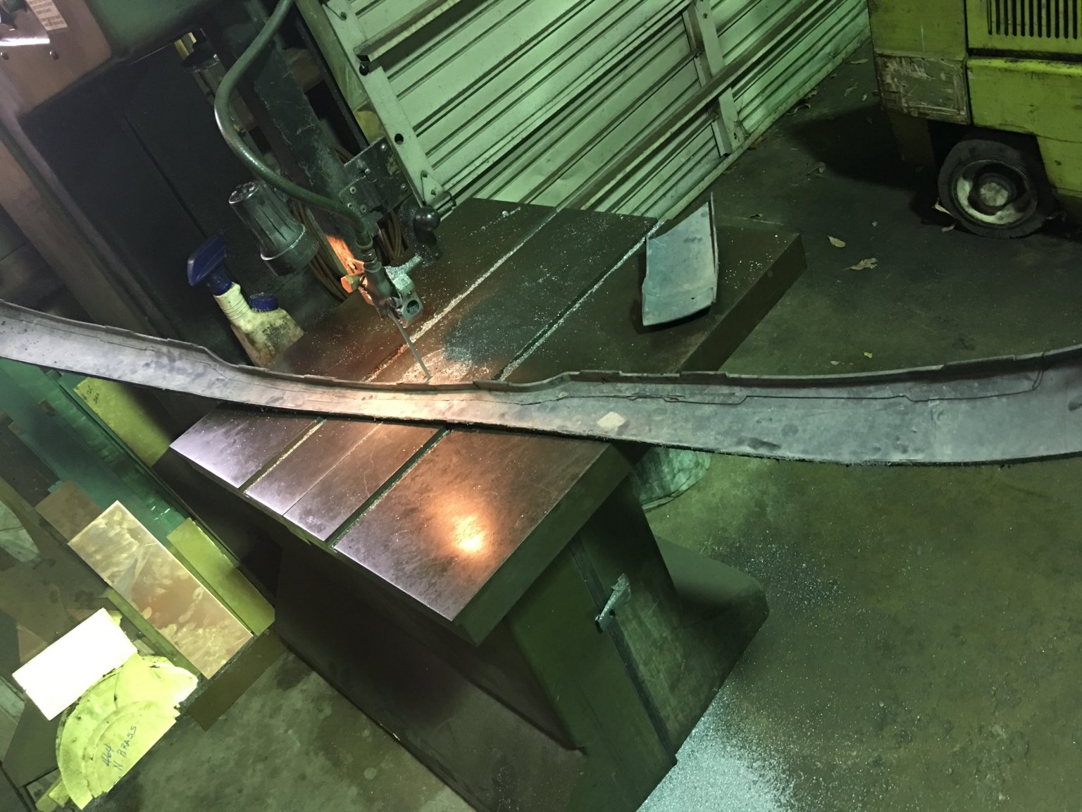

Well finally got around to finishing the truck up. Cut the lower valence, painted it(it looked horrible), and did some fender liner trimming. Having a fab shop at my disposal made all of this very easy and an afternoons work. Even with my bad ideas taking up time. I'll get into that later....

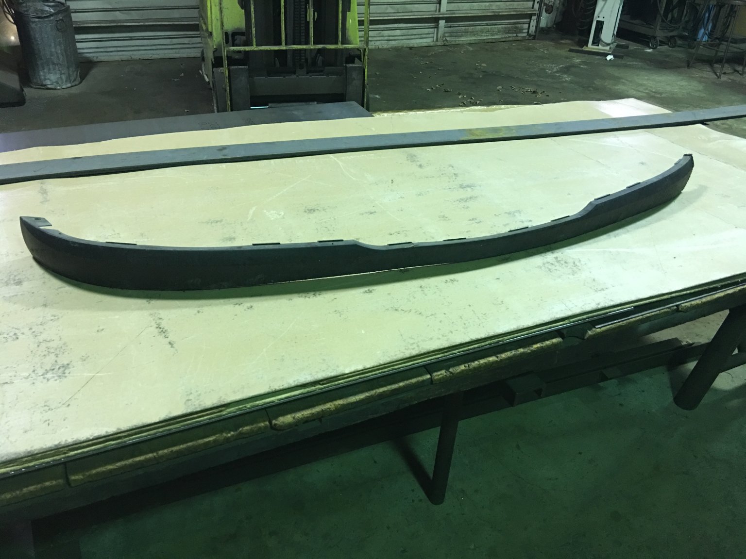

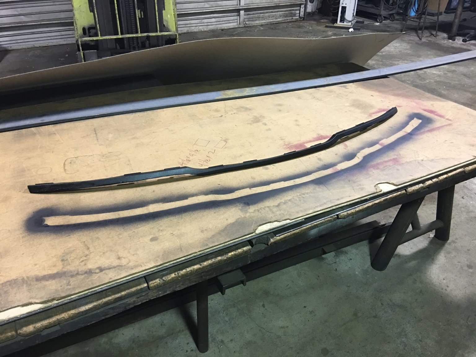

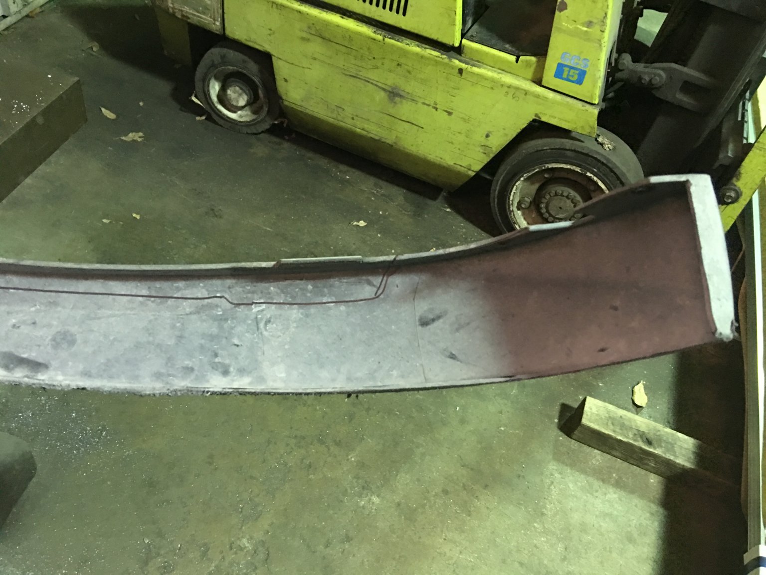

I'll start with the valence. Easy as hell. Was done in 5 min. The band saw made the job a breeze of course. And cleaned it up on the table grinder. Then did 4 coats of black plasti dip. Probably wont last but made me happy for the moment.

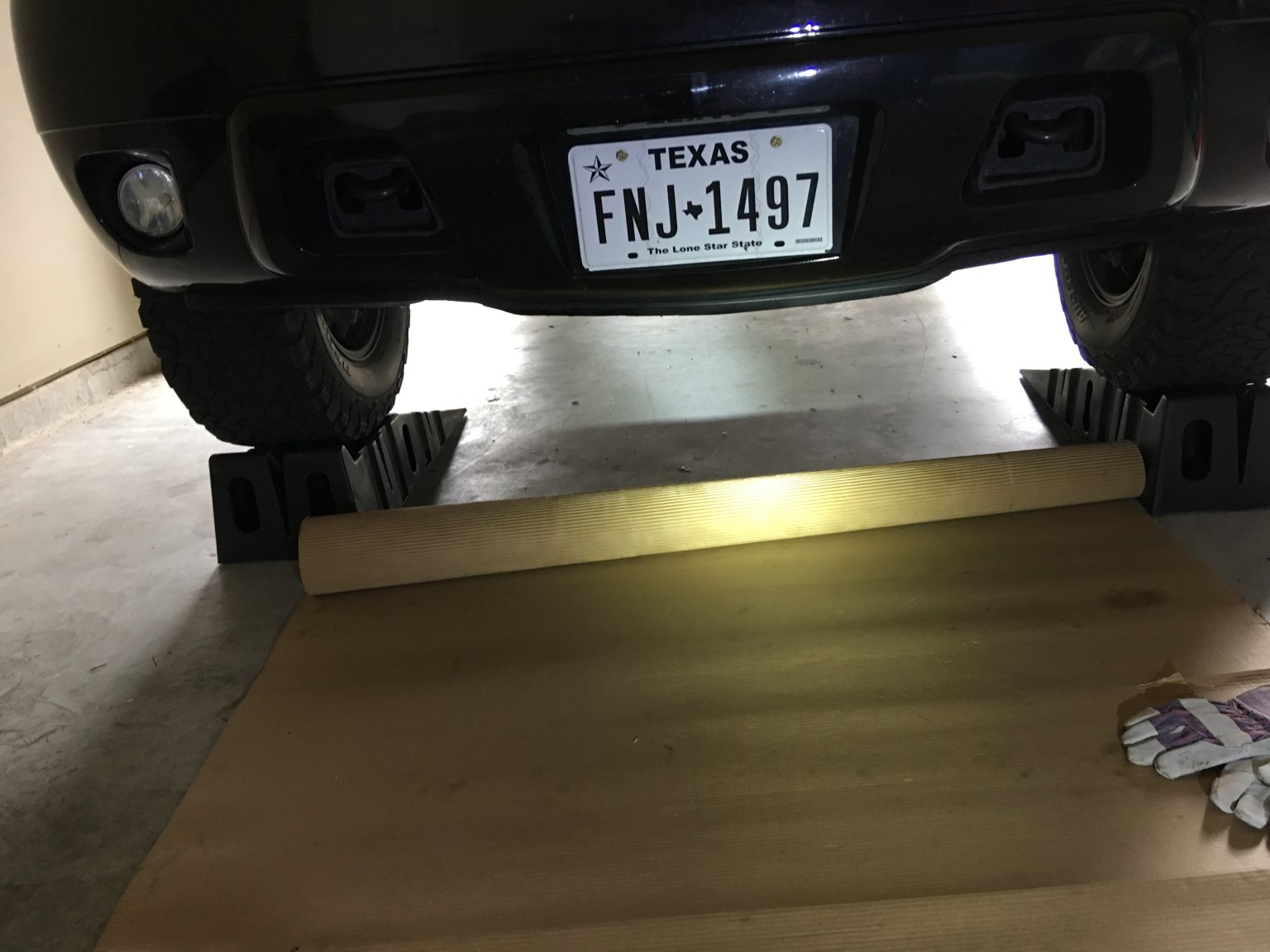

And the finished product. I'll try to get pics in better lighting soon. But at the moment the truck is clean and its raining outside so its gonna have to wait.

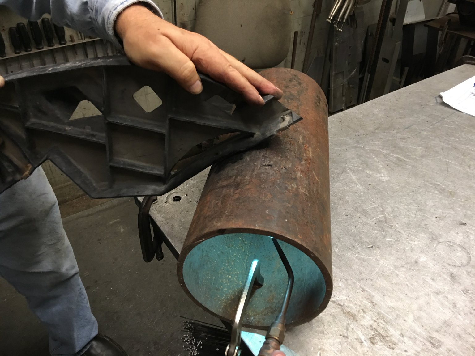

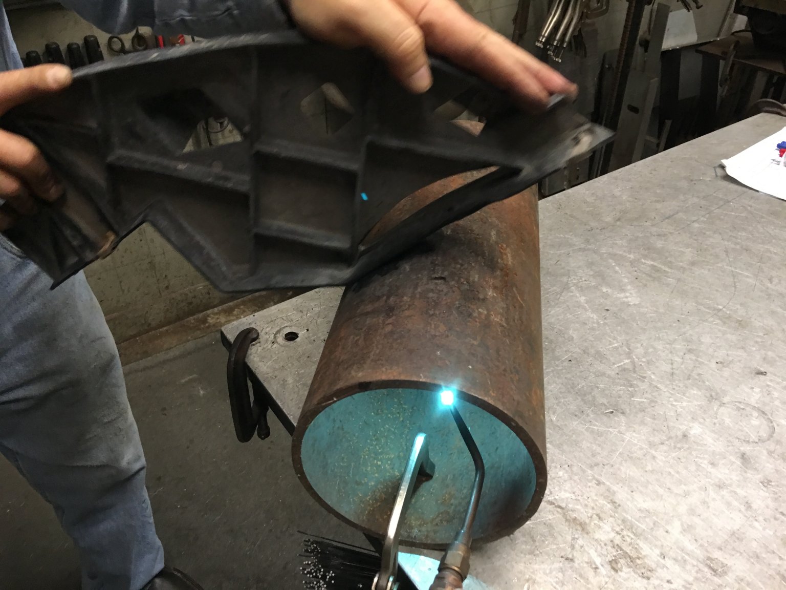

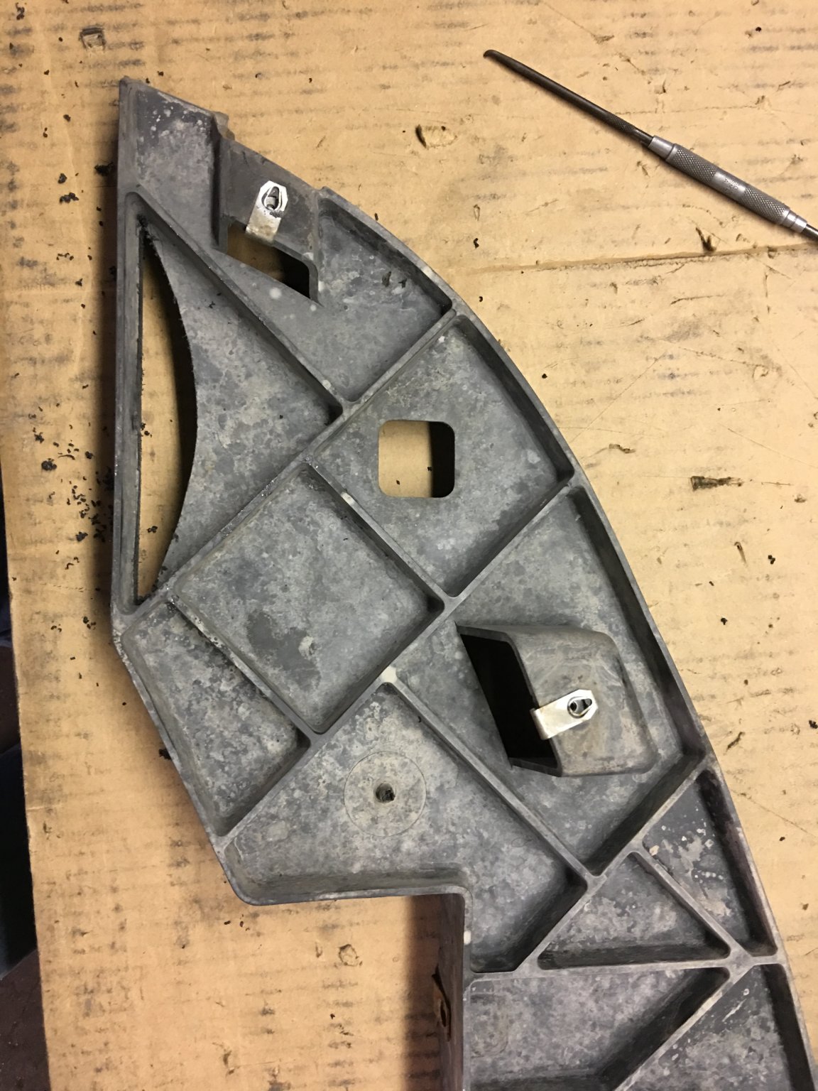

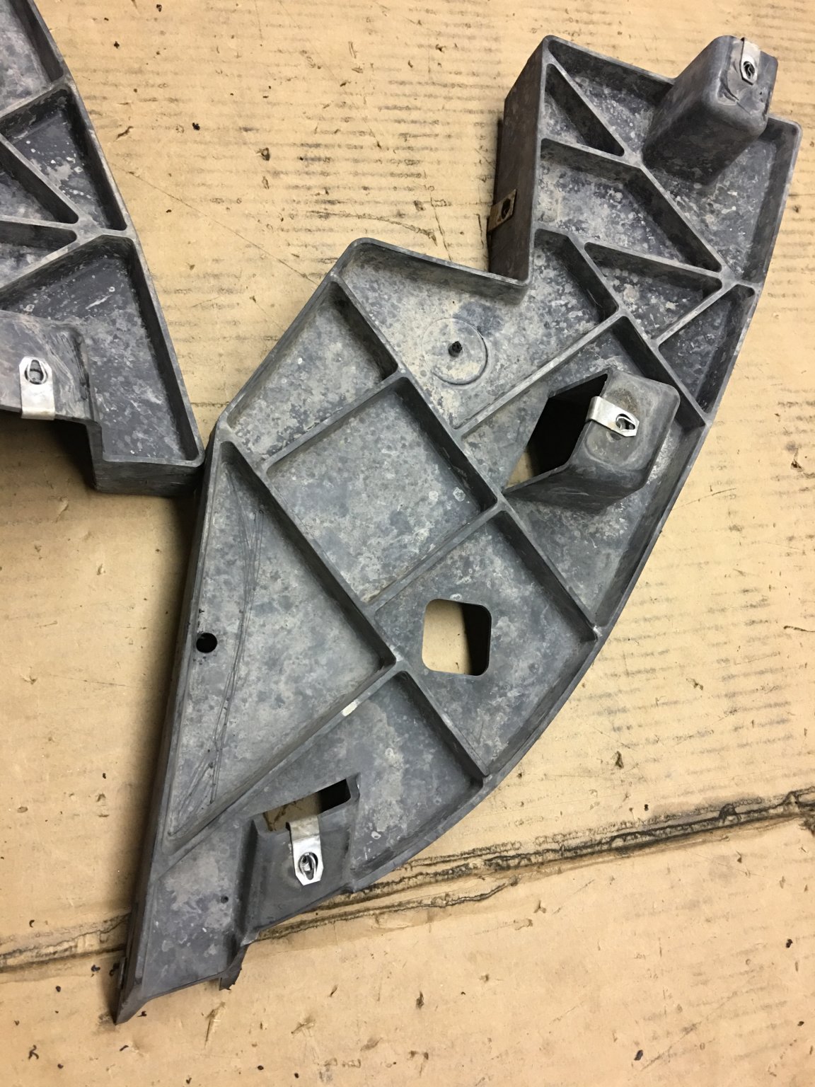

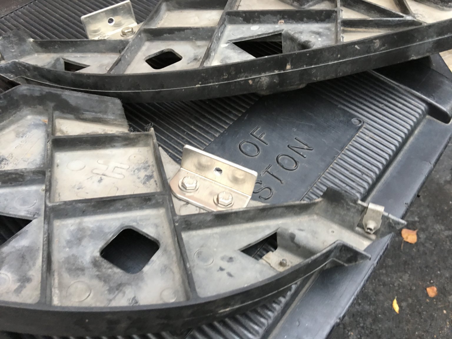

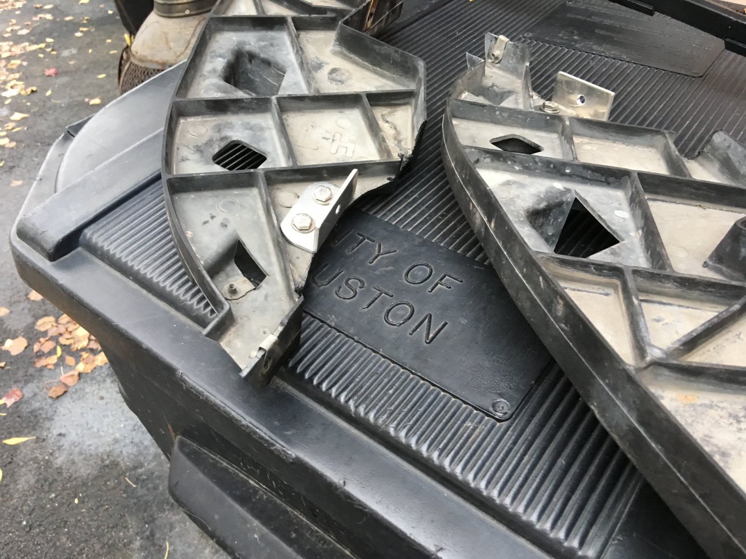

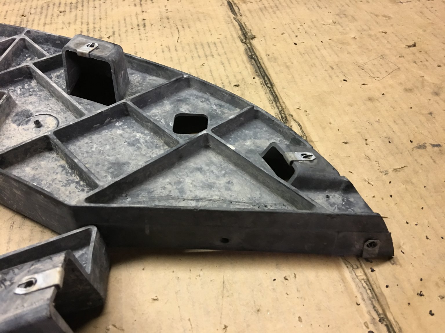

Had a thought that I could cut a slot out of the brackets and heat the remaining plastic and reshape it to retain the original mounting holes. This did not work. Dont do this. It was a waist of time. Here are picks of me attempting this with my dad giving me a hand. In the end it just burned and melted rather than reshaped. So no harm done other that waisted time. I just cut it all out and went on with the original plan.

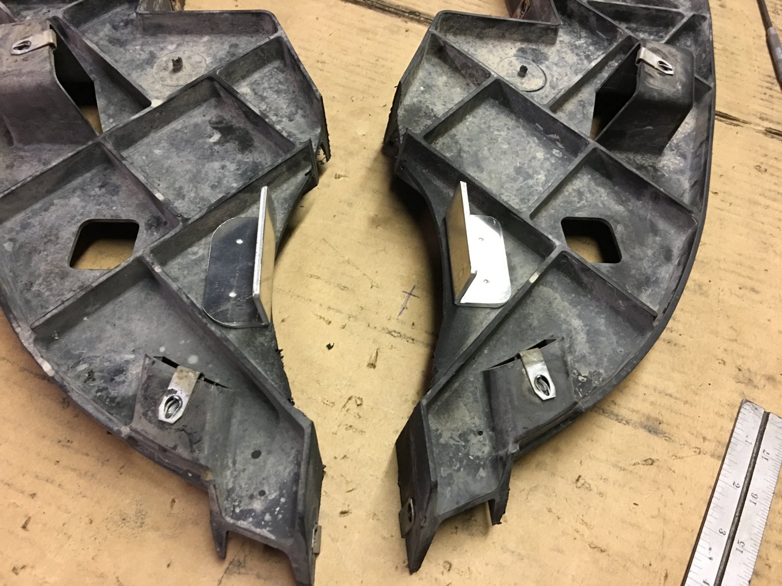

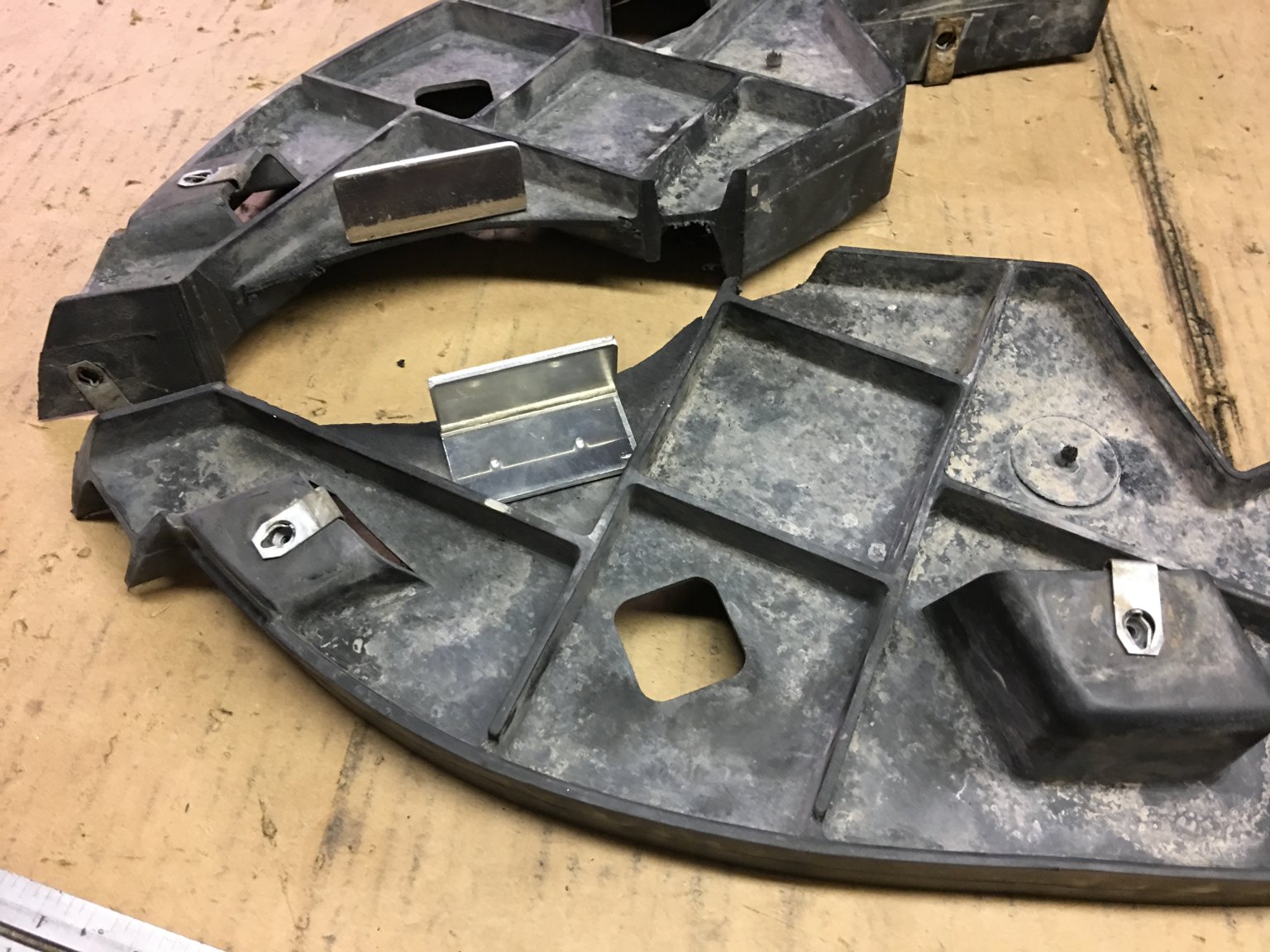

Ok so back to plan A that 01Konvict told me to do in the first place. Make some 2" brackets and mount them. This is not my best work as I was kind of running out of time so I was more or less eyeballing things from here but it honestly doesn't matter as long as it works. Brackets are 1/8 thick aluminum and I made them roughly 2 1/8" square and made a 90* bend right down center. I used 1/4-20 stainless steal bolts and matching harware. Once again real easy to do thanks mostly to having access to my dads fab shop.

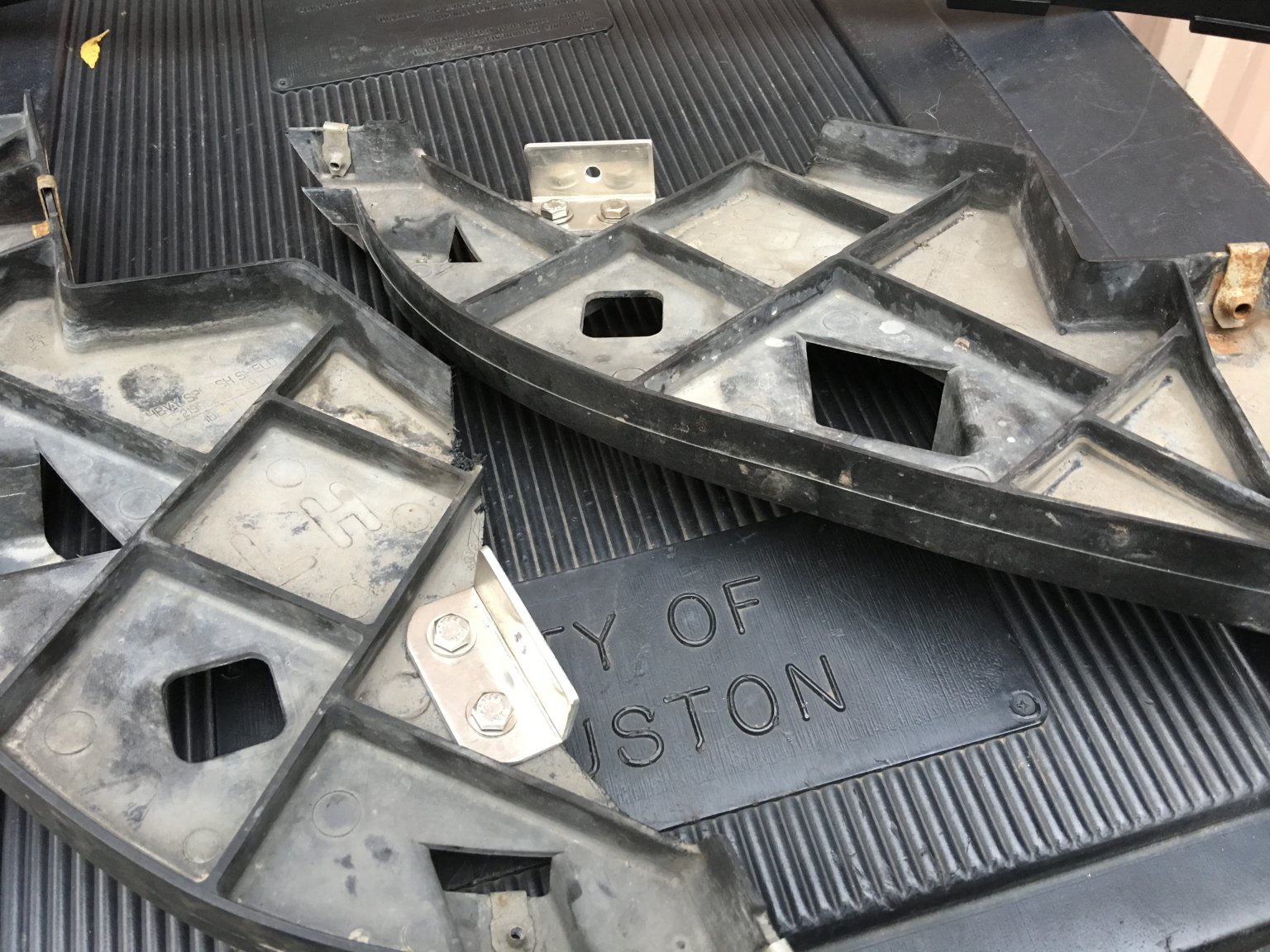

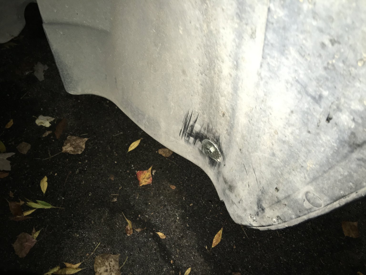

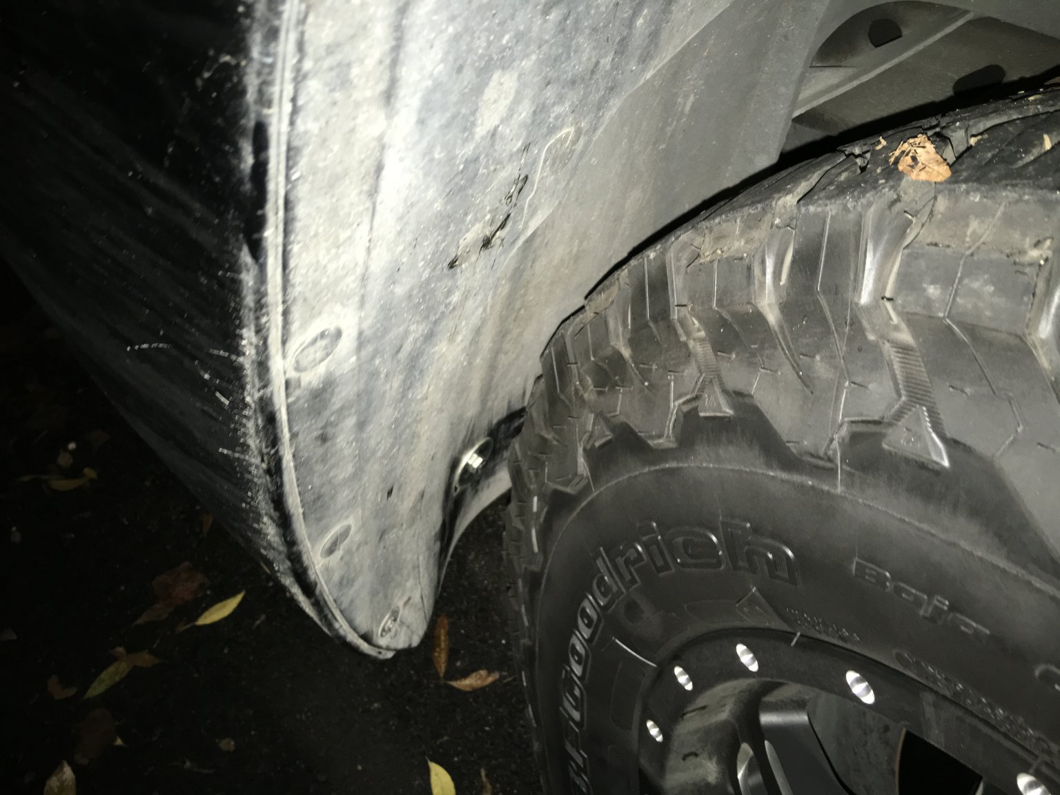

And finally I mounted them up. Used a pick tool to scratch the fender liner through the bracket hole and drilled. Ran a bolt through with a decent size washer and used a heat gun to soften up the liner to take the new shape. Very easy to do.

Good work on the valance and bumper fender bracket. Easy to use a L bracket to retain factory liner hole.

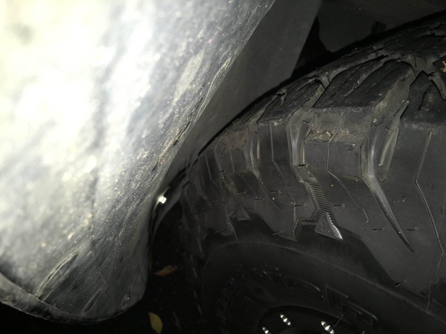

Thanks! I also had a little bit of rubbing on the rear of the fender. I didnt get any pics but I just removed the liner and used the old BFH method to massage it back a little and now everything clears.
