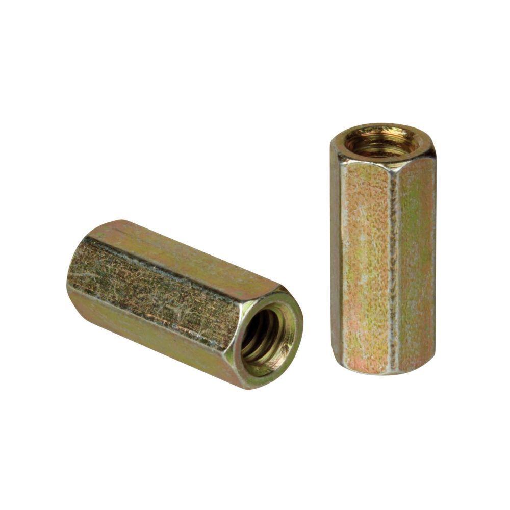

Yeah, that sucks. If leaving the links just straight was viable, that's a relatively easy fix. Cut the stock ones, thread each end, and get a threaded coupling to make the length adjustable.

Good approach to using the factory style straight links and still off-setting the swaybar. So, using the idea of cutting the factory links in half, removing a little length in the center, then threading the rods/shafts and using a threaded coupling for adjustment is certainly a good budget alternative now that the DJM ones can't be had affordably.
Or if you have a the skill and a welder, just cut the factory ones, measure, remove length, weld back together.
