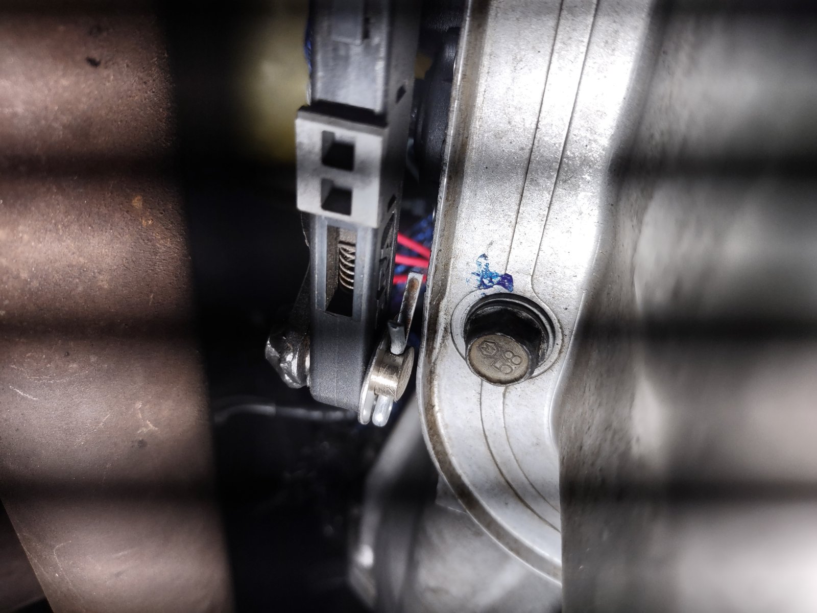

This isn't exactly relevant, it's what I did on a 4L65E in a Hummer, but you get the idea.... fabricate.
