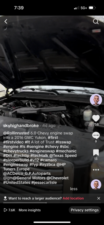

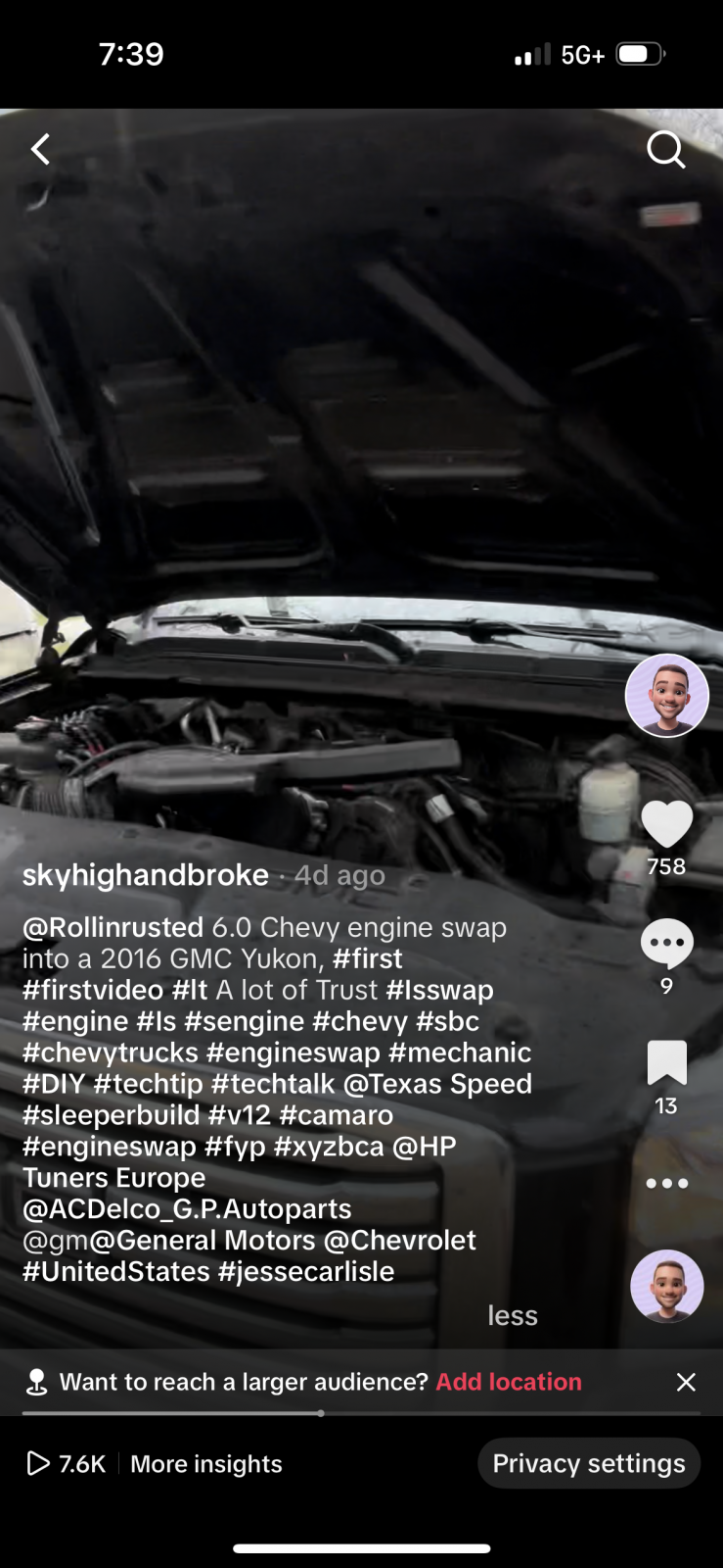

2016 GMC Yukon L83 died from a plugged vacuum pump shortly after the transmission died from the thermostat in the transmission line. New transmission flipped the insides of the thermostat fixed. When the engine blew I decided to install a L96 without doing any research. lol my bad, with 2 months after completion $5500 into everything and made my own engine mounts. It is now complete

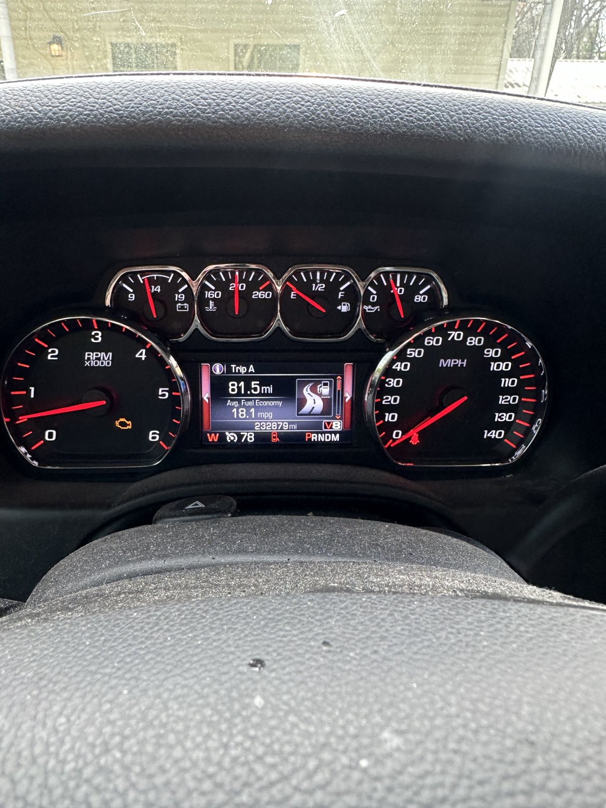

Update: Yesterday I went into hptuners I couldn’t change the tire size but I could change the gear ratio it looked like the ECM was at 4.10 and the Yukon was 3.42 so I did change that. I also disabled the rear o2’s because I had to steal the Y pipe from my 2005 Chevy pickup and the cats were already cut out of it. There is a way better throttle response now. Eventually I will get a new Y pipe. I welded in an extra cat just before the muffler to quiet it down a little. I imagine this will not help the MPG as much but. 3.42 should make a difference in the calculation. I will be driving it again this weekend 300+ miles and I will have some results. My wife drives it everyday but only a couple miles. It is 14 mpg now so hopefully will see what the weekend brings. Just thought I would give you an update I’m trying to learn all the schematics of hptuners as well so I’m not changing anything I don’t know what it is.
