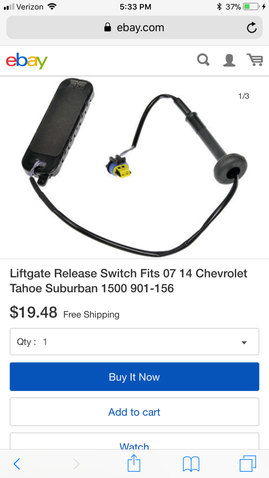

Easily replaced on the back of handle. 4 screws on back of handle and rubber andcswitch come off and you can test it there.

Ok I find this switch already also on RockAuto. I have to order it first. But i try to test it. Do i need an special screwdriver because ** i can release this 4 screws behind the handle. Or do i have to remove the plasitc cover inside of the tailgate. Sorry that I don't have much experience on this model of car and asking Newbe questions. If you say its easy so i think i get it unscrewed without removing the plastic cover inside of the tailgate. Thanks for your help still for now.. its helping me a lot.
