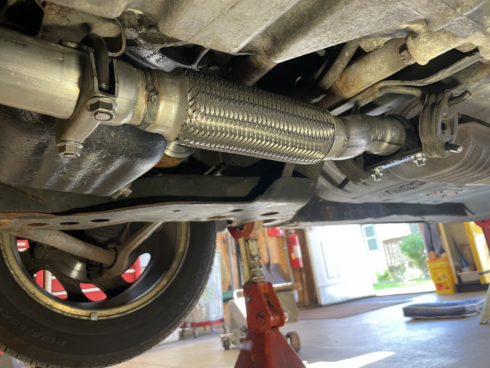

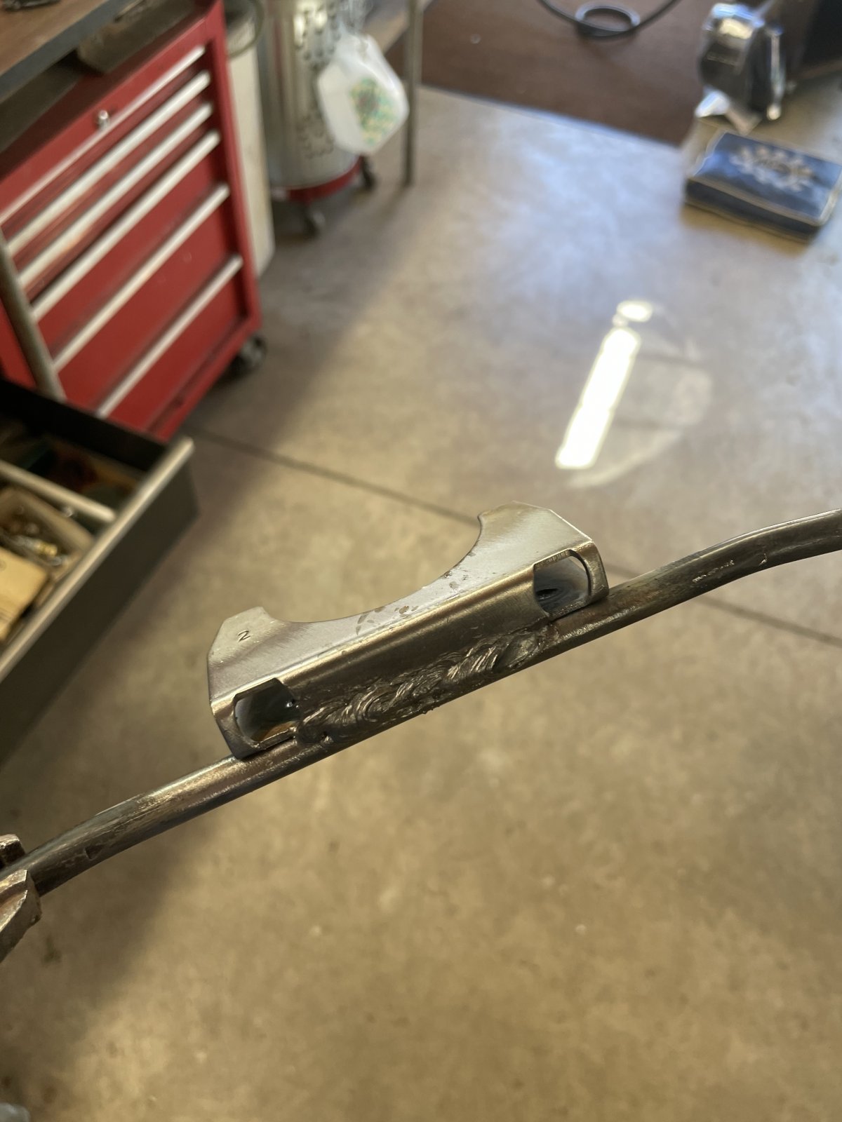

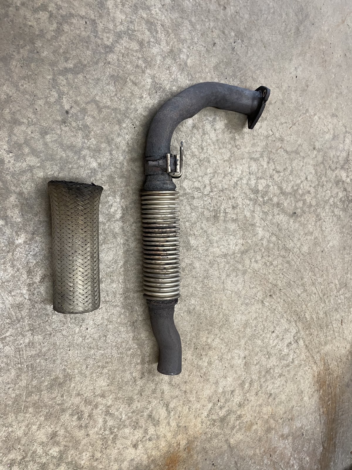

Well it was time to change the front exhaust pipe that had the leak. Amazingly I got the manifold flange off without the torch but I did soak it down twice when hot with PB blaster. I had to make a new mounting bracket because it was welded to the section of pipe that I need to slip the new pipe over so I welded some round bar to the clamp I was going to use.553B90EB-865A-4396-9C5F-F9EEFDEADD0D.jpegD8924057-724E-4788-81C1-1E8FFD6BD636.jpeg26FC41D5-0A92-47FA-ABD6-7E7928620CC9.jpegB6DF90AD-C1B4-4204-BC7D-F7655D5483C6.jpeg
