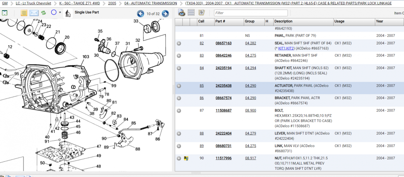

Project Denali
Nov 30, 2016
148
150
I haven't worked on a trans cable on these trucks yet so not sure about the part your referring to. Maybe sharing this diagram will help you.
