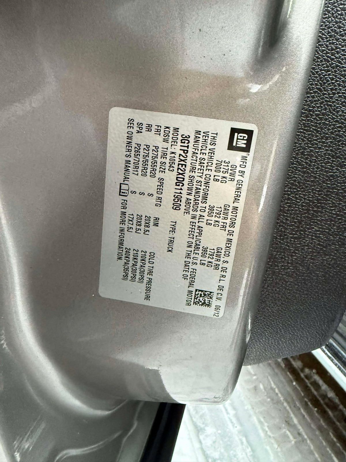

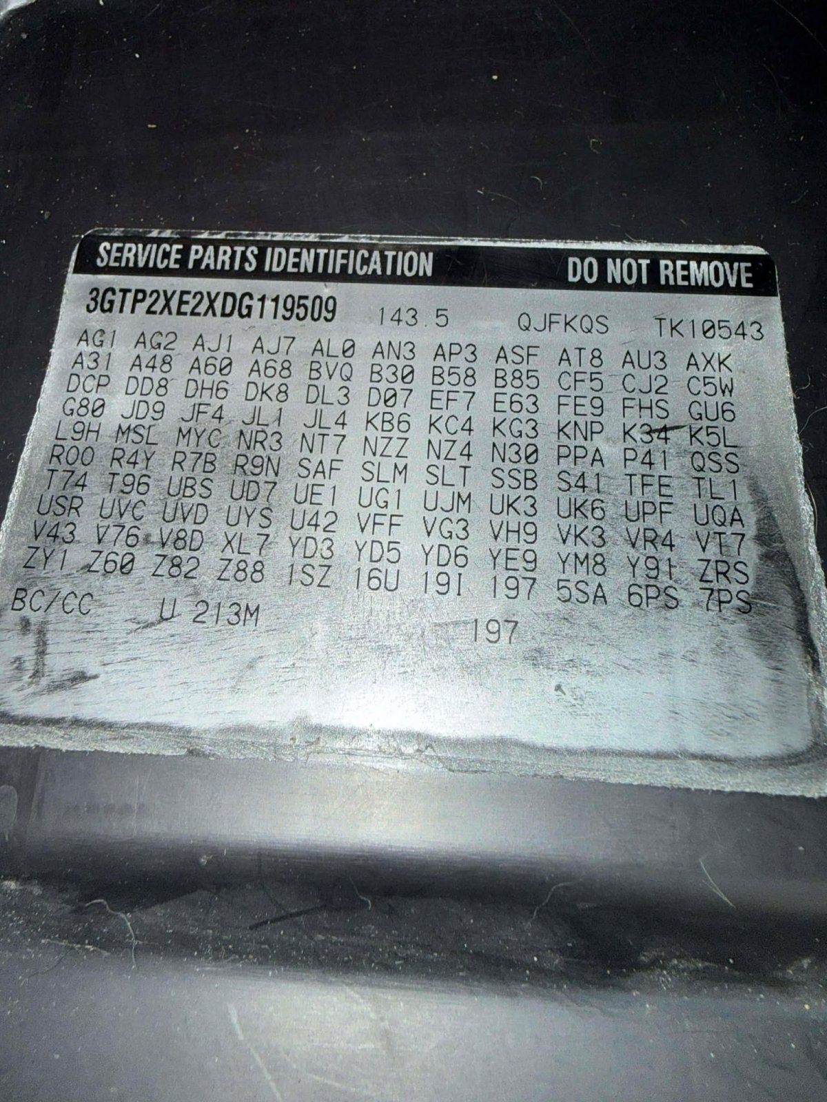

I'm looking at a 2013 Crew Cab Denali Pickup. Deciding IF it's got enough (max package) for
trailer tow capacity and maybe a few other items.
I'm attempting to post the RPO & VIN tags on this here so I can request some help.
I know its a denali, 6.21L, AWD, crew cab.
But I'd like to find out before I make a trip the Gear Ratio, ETC Mechanically before I head
out of town to take a looksy
Thank You
30,738
48,416

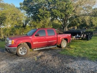

3.42 (gu6), has enhanced cooling package (k5l) but not the max tow packaged (nht)
good luck on your hunt, finding the exact one you want can be difficult at best

Hit this link but check to make sure I entered the VIN correctly:
Thank You So Much. I did some searches, but only found just huge lists of the codes

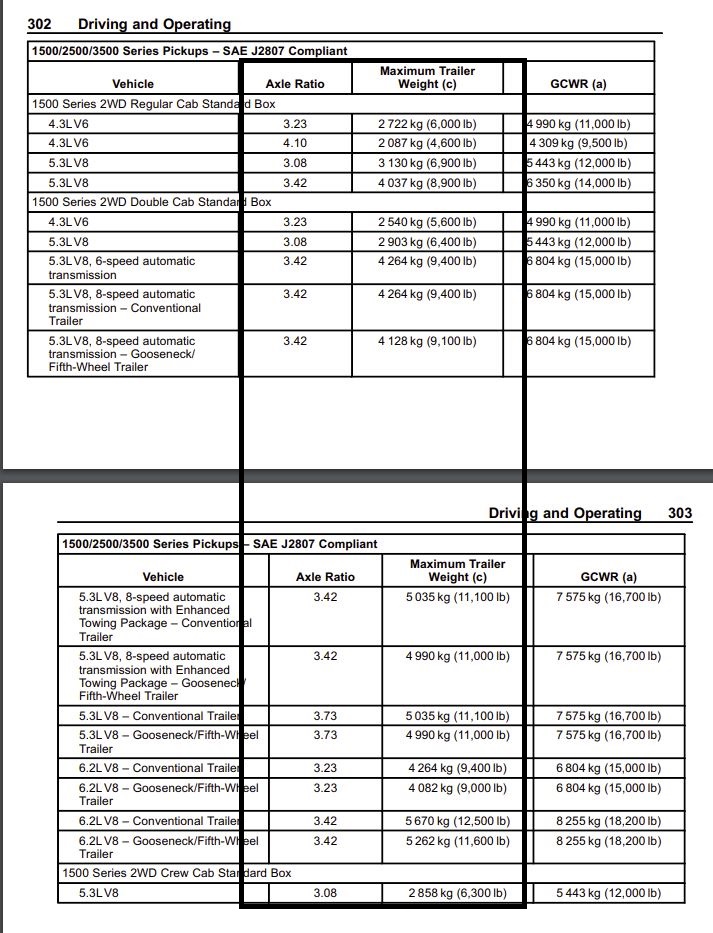

Looks like how this one is equipped the max tow capacity shown
in the charts i've looked up is 9400 lbs
I wonder why my current Yukon Denali is so much lower ???
Even with the 2WD rear axle, it's only rated to 8300 lbs...
Must be the extra weight of the SUV vs Truck platform I assume.
( I know the AWD yukon is about 7800 lbs due to the smaller rear diff)

tow capacity is generally calculated by the axle ratio, but... is alo affected by engine size and transmission, but a general rule of thumb is the axle ratio
note that the 8speed is generally undesirable

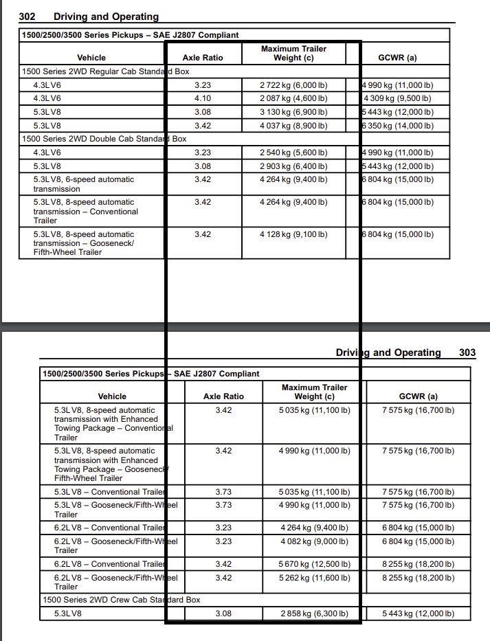

all the ratings are shown starting about page 302
and I just realized you said 2013, I was thinking 2014 so the k5l might be all it shows, I only shopped the k2's when I bought mine

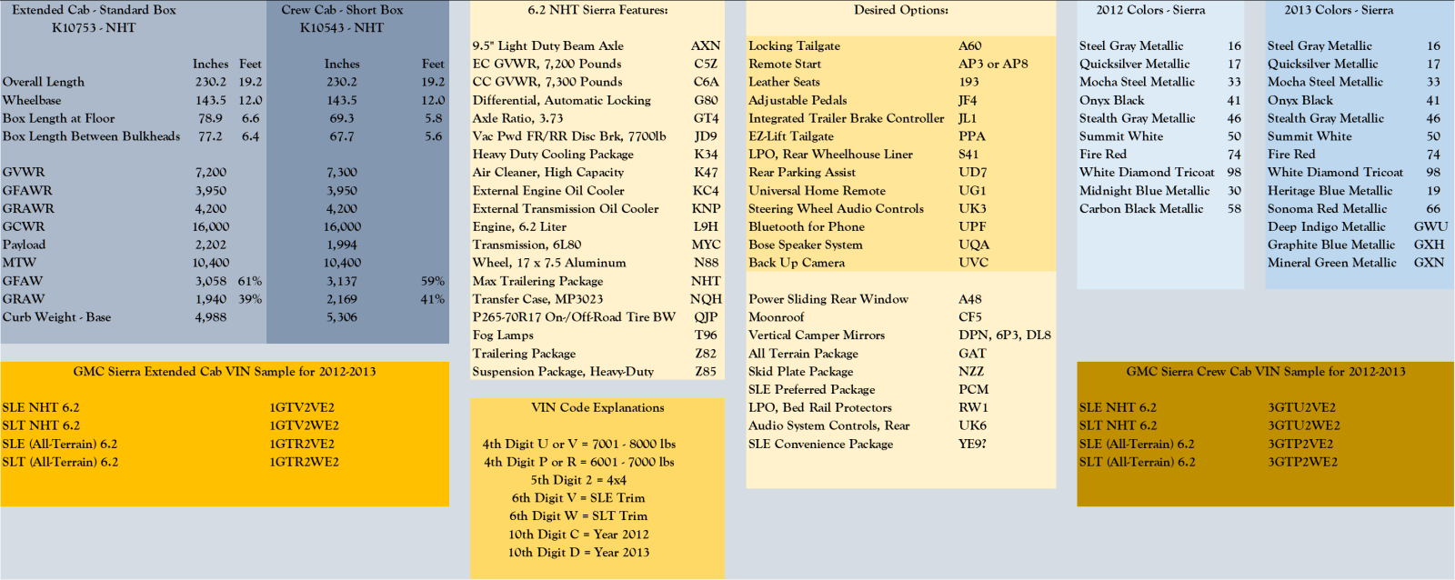

The NHT package was not available with the Denali trim level.
An AWD Denali has the 8.6" 10-Bolt rear differential. They all came with the G80 and 3.42 (GU6) gearing.
The NHT equipped pickups have 3.73 gears and an extra leaf in their rear spring pack and of course different shocks. Their steering rack also has a different part number.
I've got two GMT900 6.2 pickups, one an NHT and the other an All-Terrain Z71. Both are Crew Cabs.
The NHT has an 1,805 pound payload capacity and is rated to tow 10,400 pounds. Her GVWR is 7,300 pounds.
The All-Terrain has an 1,433 pound payload capacity and is rated to tow 9,400 pounds. Her GVWR is 7,000 pounds.
They have both towed way more than this and the powerful 6.2 doesn't even know the load is back there. But, the majority of our towing is done here in Florida where our hills are overpasses and not miles long steep grades.
All 6.2 pickups that are not AWD have the 9.5" 14-Bolt differential with disc brakes.
The brakes on all three of these trucks, including the 5.3 Yukon XL, share the exact same part numbers.
My All-Terrain is bone stock and runs 14.80s in the quarter mile. That glorious 6.2 puts a smile on my face every time I drive it.
If you use the desktop version of AutoTrader and some of the others, you can specify the trim level and 6.2 engine. There are more Silverado LTZs around than SLT Sierras with the 6.2. More LTZ Silverados come with ventilated seats than SLT Sierras.
Most 6.2s in this generation are west of the Mississippi River. Prepare to travel across country for a good one. They are out there, I search for them periodically still. I know of about 4,225 6.2 Sierras made between 2012 and 2013. The NHT CC in 2012 and 2013 totals 900 in SLT trim and 970 in SLE trim. I maintain a spread sheet of course!

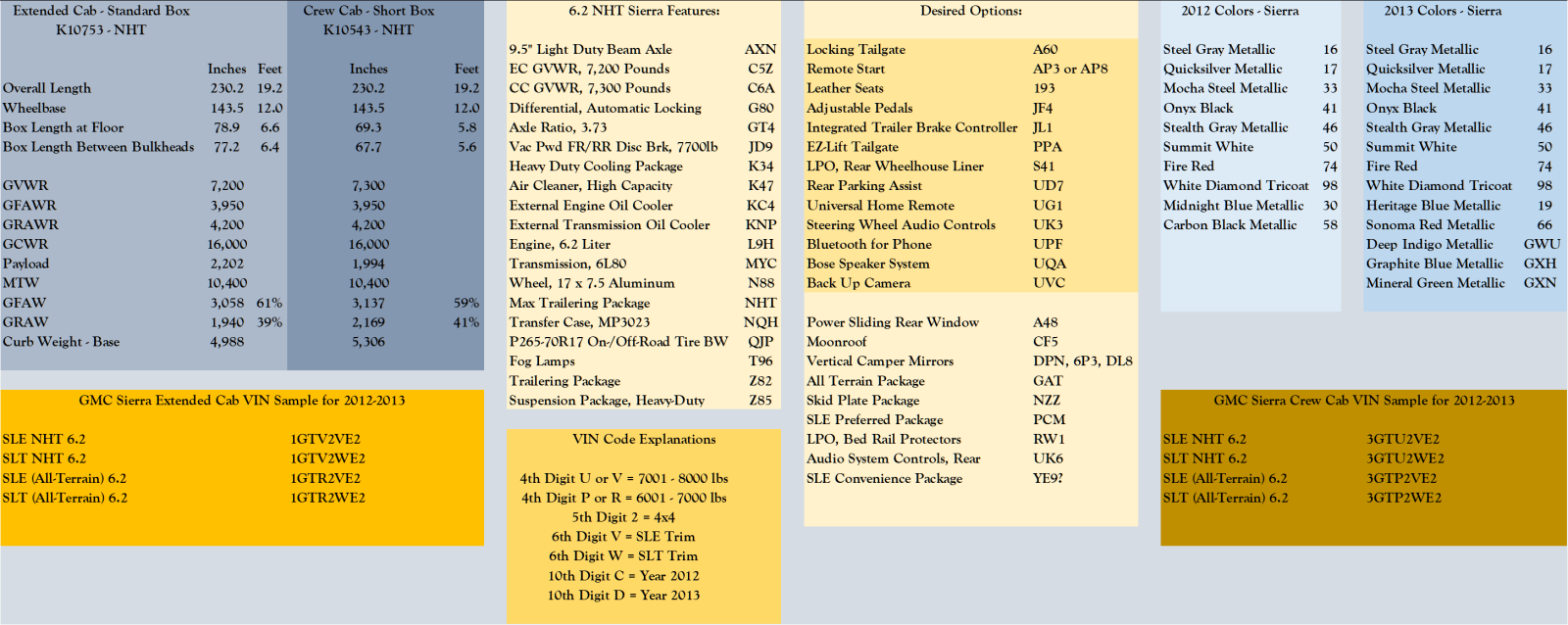

This is the sheet I made to help locate them:
An NHT equipped truck doesn't show RPO K5L but it has all the features of it.

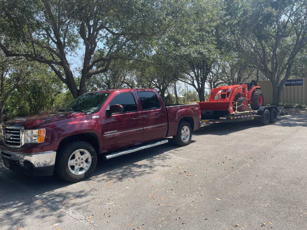

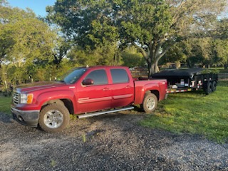

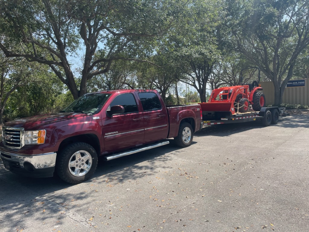

This is my All-Terrain:
Wait a minute, you're in Kansas, right smack in the middle of 6.2 country! Almost bought one in Olathe and picked up the red one in Oklahoma City with 75K miles on it. The NHT came from Idaho.
View attachment 477578View attachment 477579

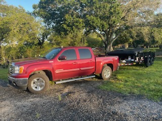

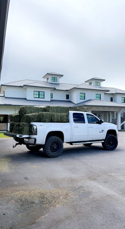

The Sonoma Red Metallic truck is an All-Terrain with the Z71 package. Not an NHT. She's the one with 3.42s.

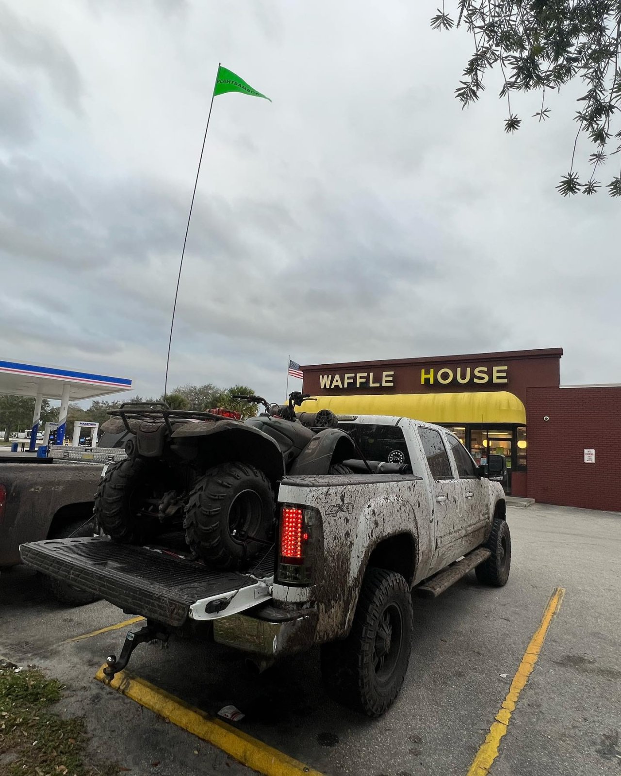

The girls took the white NHT to rescue a Honda up in Georgia somewhere and bring it back. Towed like it was barely back there.
This pic is still on Amazon, they grabbed a photo off Instagram and used it for their product!
