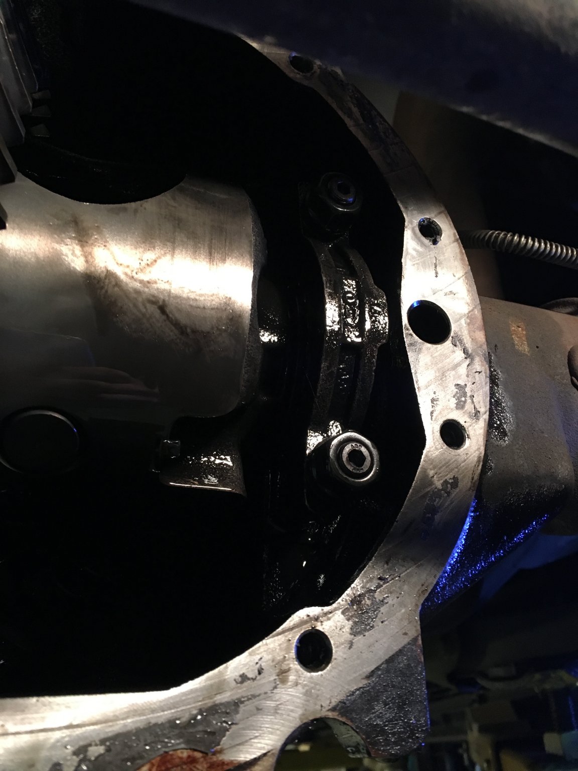

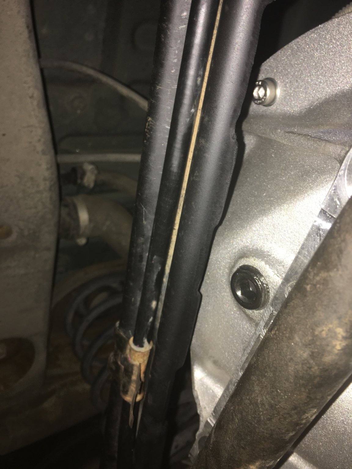

So I finally got to it when I did a complete fluid change. I also added carrier bearing studs because it was already off anyway. It IS NOT a direct bolt-in affair like I was told even though it is the low-profile one. I had to notch my panhard bar and grind down one of the fins a little to make it work. If I had time and extra fluid I would have put the factory one back on and machined the backside of it down, because its quite thick, and it might work that way, but Im still satisfied with it. Ill report to see if I smack anything as time goes on.
