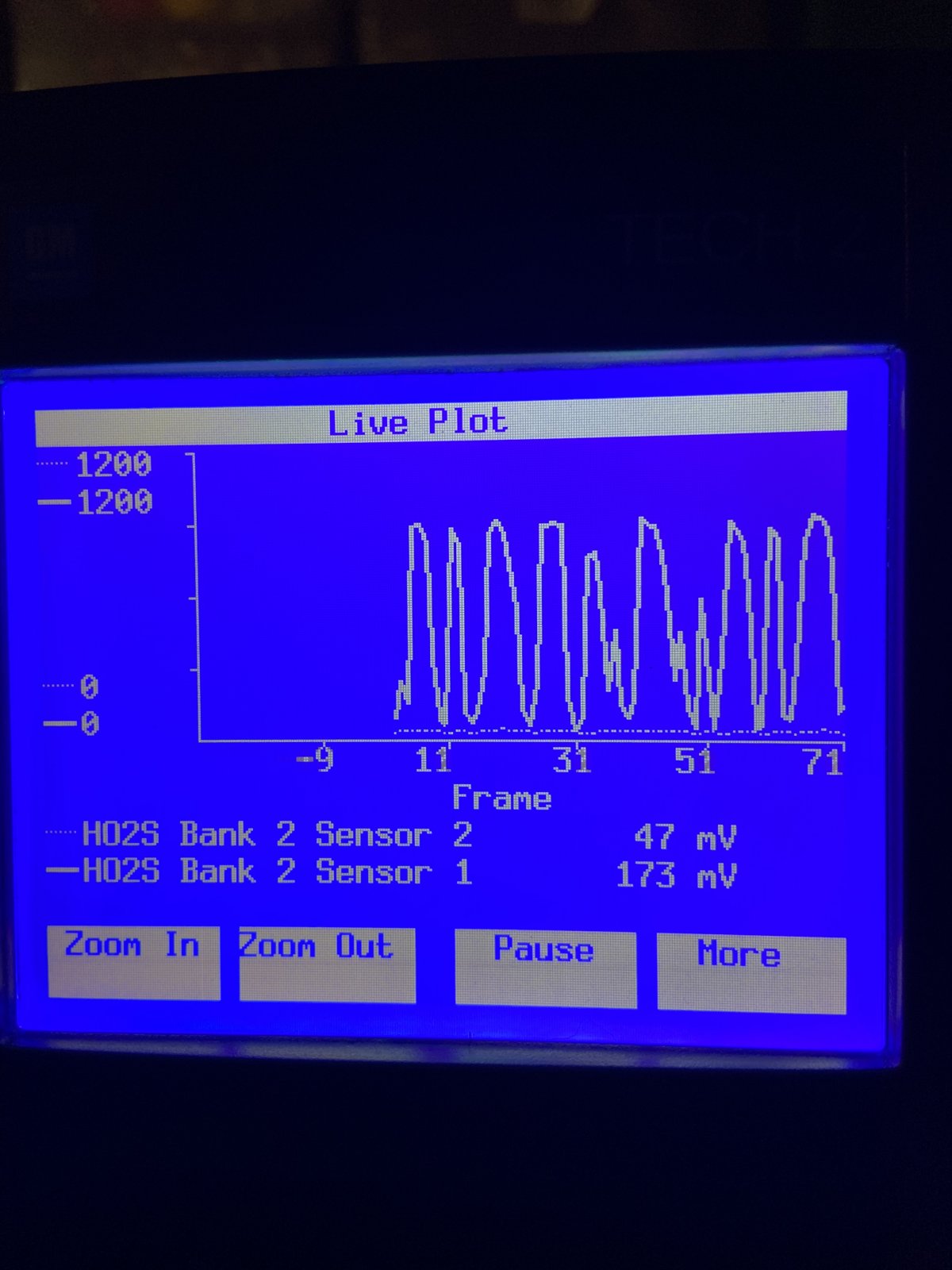

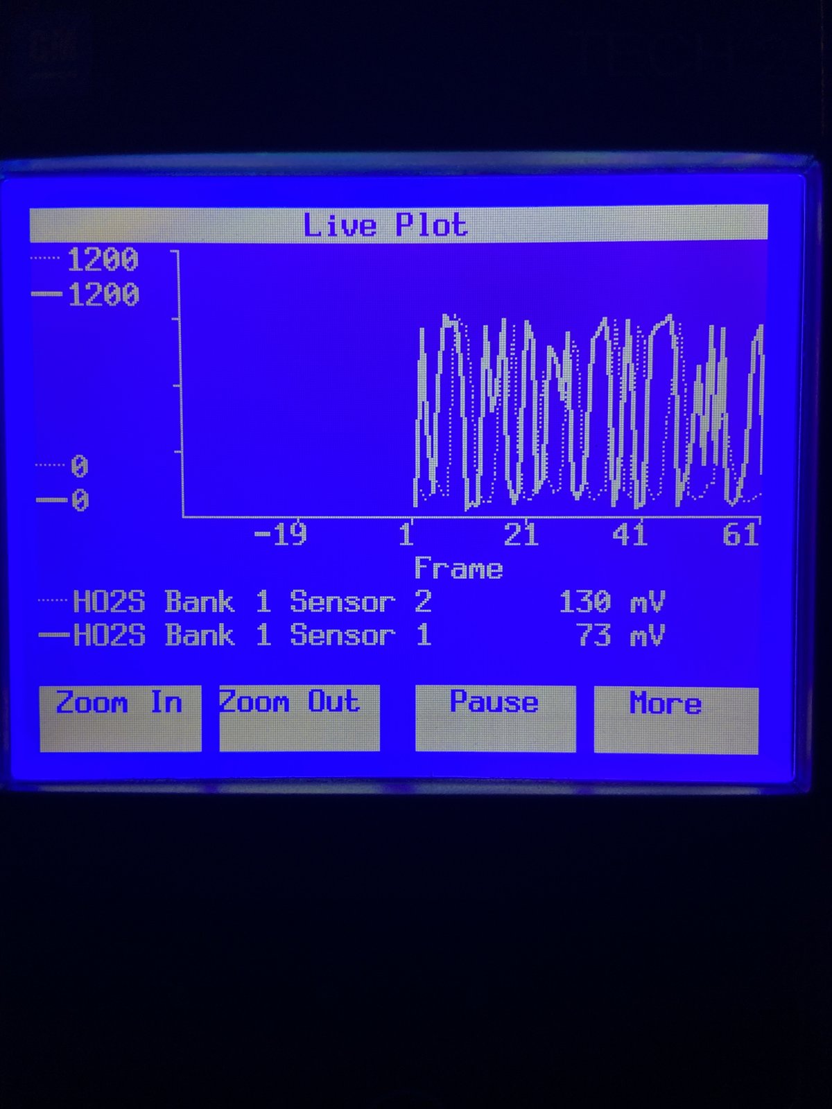

Here is a plot of the bank 1 (which had the hydrolocked cylinder) and bank 2 O2 sensors. Am I seeing a dead cat on bank 1 and a good one on bank 2?
The flange downstream of the cats (which is upstream of the bank 1 downstream oxygen sensor) is shot; you can feel the exhaust coming out of it after the coolant finished leaking from it. I’ll look for another gasket this week and swap it out. Kind of hoping that it remedies everything but you know how that goes.
Would this exhaust leak downstream of the cats (and upstream of the downstream Bank 1 O2 sensor) cause these readings or did the converter say “I’m out of here” after getting flooded with coolant steam?

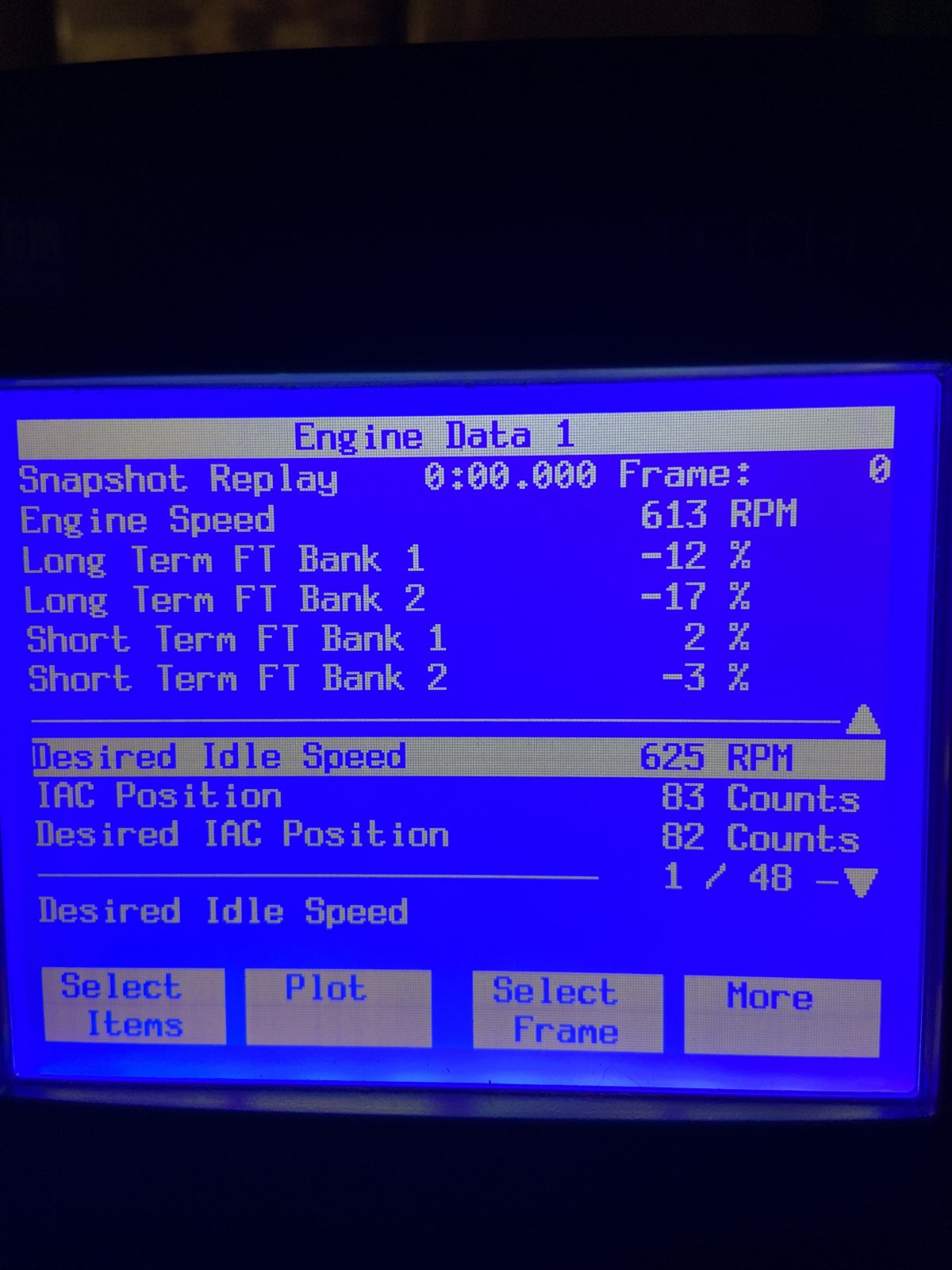

And as for negative LTFT, can y’all help me interpret it?
No DTCs are stored. Thanks for any help, I’m looking forward to finally getting this out of my garage :)
